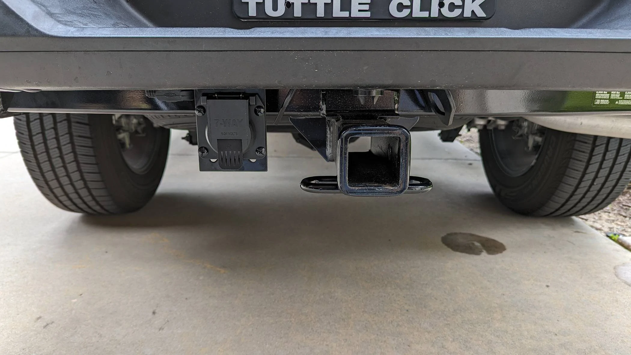

I really should have known that I was gonna swap the 7 pin connector out for one that fit in the bumper. I found this one at Lowes of all places, and it fits. Although what a PITA to get it to snap in. I had to bend the 'tabs' on the bumper out, and it was still a pain to get in. I then got underneath the truck, and got a screw driver onto the clips on the 7-pin mount and bent them out. it seems solid, but I think I will put some black caulk around it regardless.
Do you guys use die-electric grease on the connection under the truck? I didn't, but it would be simple to pull it apart and apply some.
Also, getting the 12v to light up in my tester seems to take some magic. If I hold my tongue just right, or maybe if I cross my eyes just right. not sure. The one thing that consistently makes it light up is if I plug in my 4 pin trailer tester in. then the truck immediately senses that a trailer is plugged in and the 12v lights up. Maybe my (admittedly cheap) 7 pin doesn't simulate a trailer being plugged in???
Anyways, here is a pic of the new 7 pin in the bumper:
Here is a link to the 7-pin that I used.
Correction: Here is the one I ordered.
