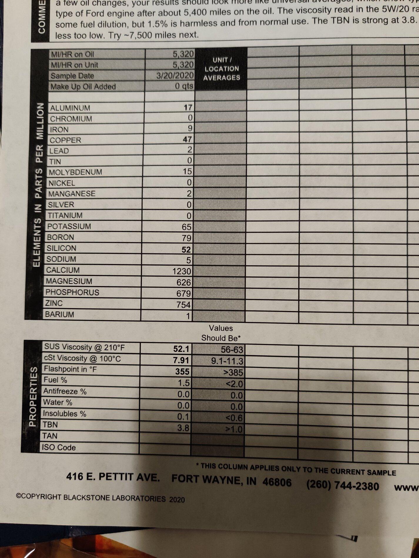

Here is my report from last year at the 5k interval. Closest one I could find, it does say 7500 on this one. I'll try to find the other sheets. Just moved and office is a mess.

Even though this report has no verification attributes (no vehicle model, no report ID, etc) and thus suspect to scrutiny, it still shows your viscosity has broken down below 5w30 standards around 5k (it's literally in your report black & white), just as mine had. The oil does not have 7500 miles left on it. They are saying your interval is 7500 miles total. Your TBN looks great, but not your wear metals. If at 5320 miles my 5w30 oil had sheared to 52.1 (supposed to be minimum 56) and 7.91 (supposed to be minimum 9.1) I would change it if I cared about the long term health of my engine. That is the only point the other users are trying to make. 10k just is too far to push the oil, regardless of what Ford or the oil monitor says.

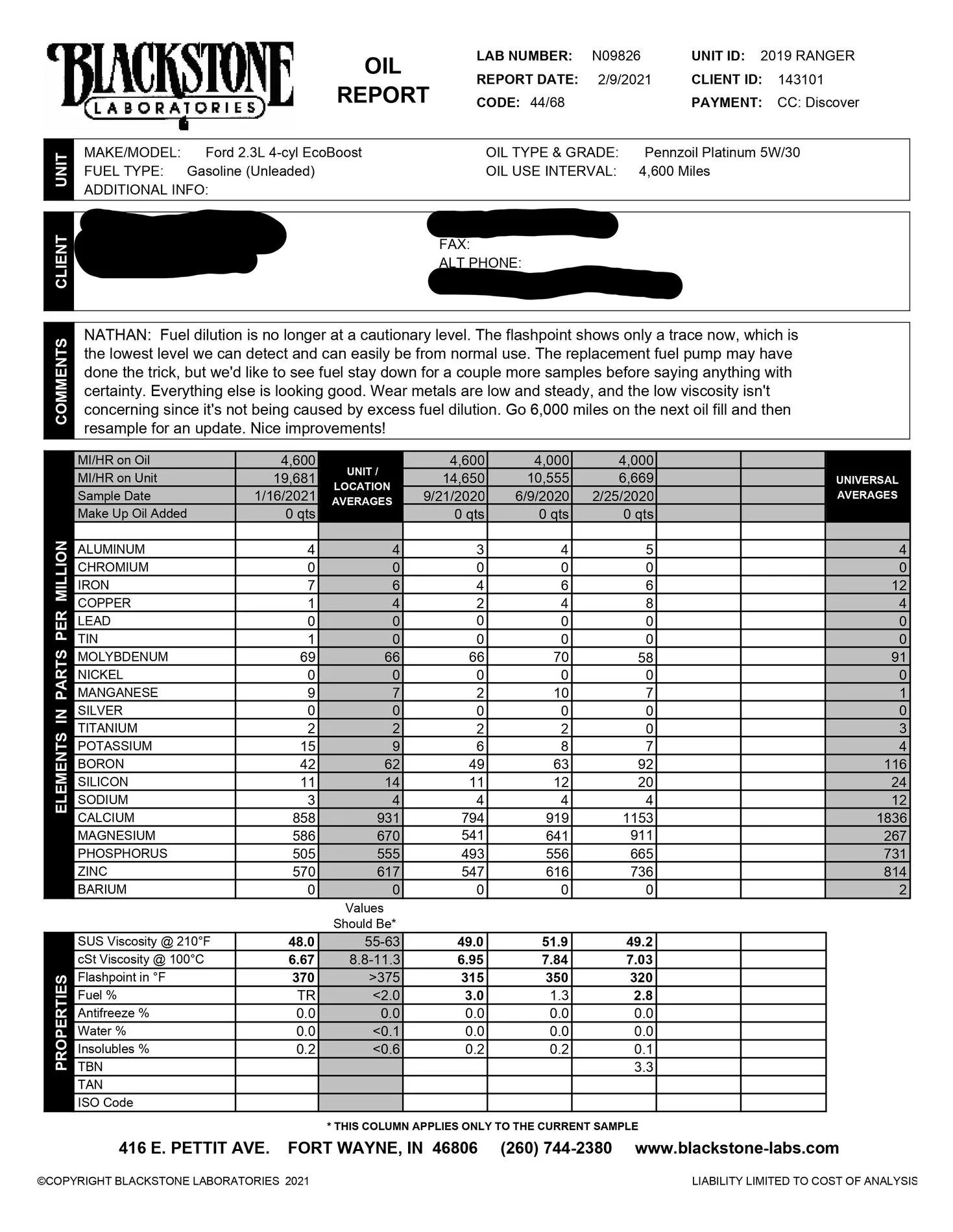

It took me less than five minutes to find a report on this site, convert it from pdf to jpg to show you, that even with trace fuel dilution viscosity has already broken down before 5k.
