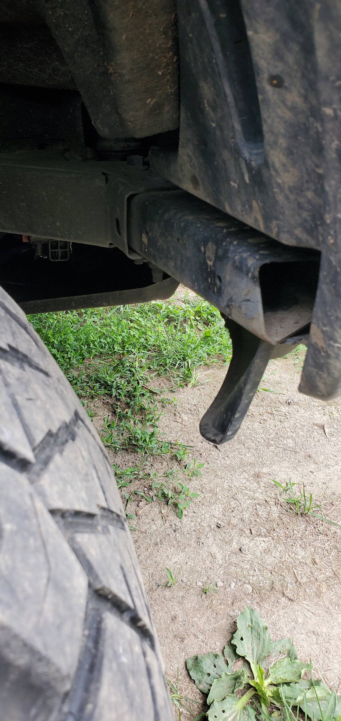

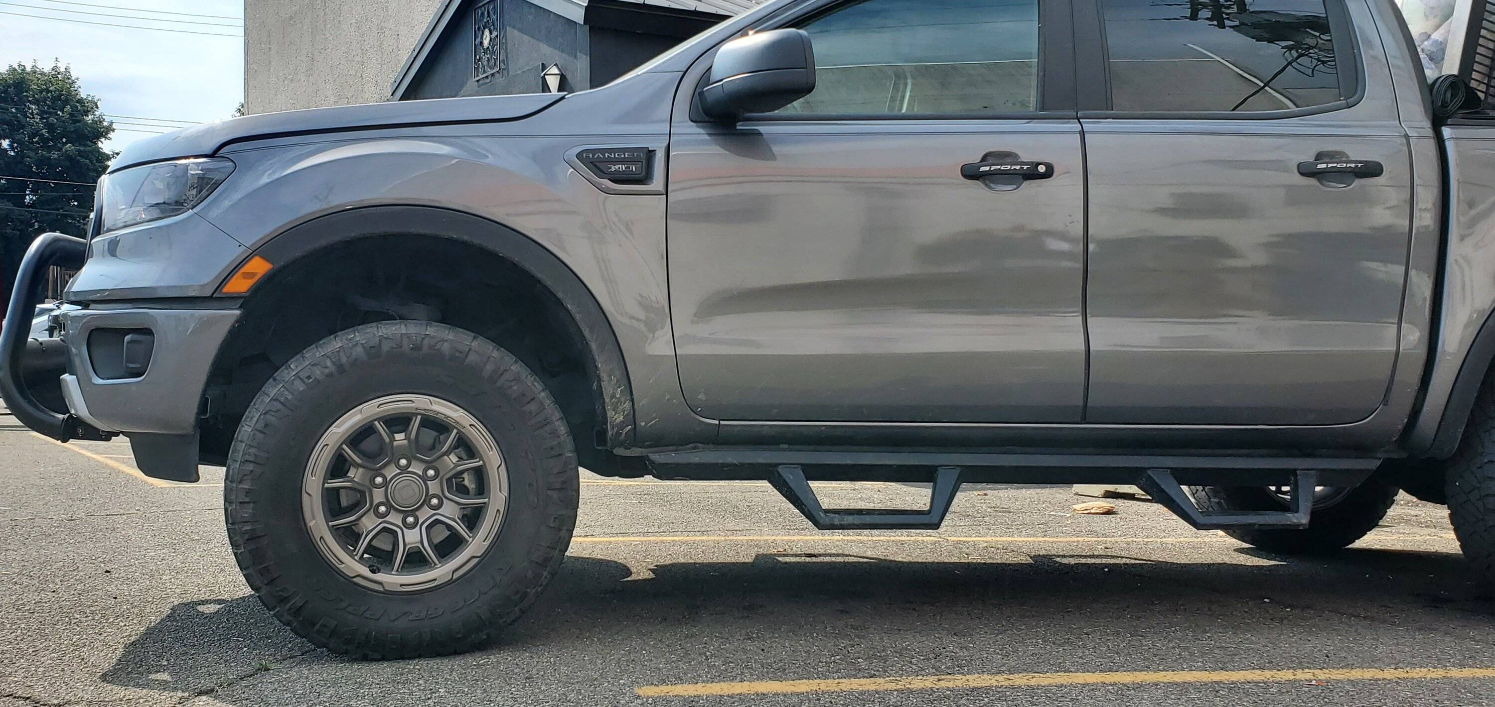

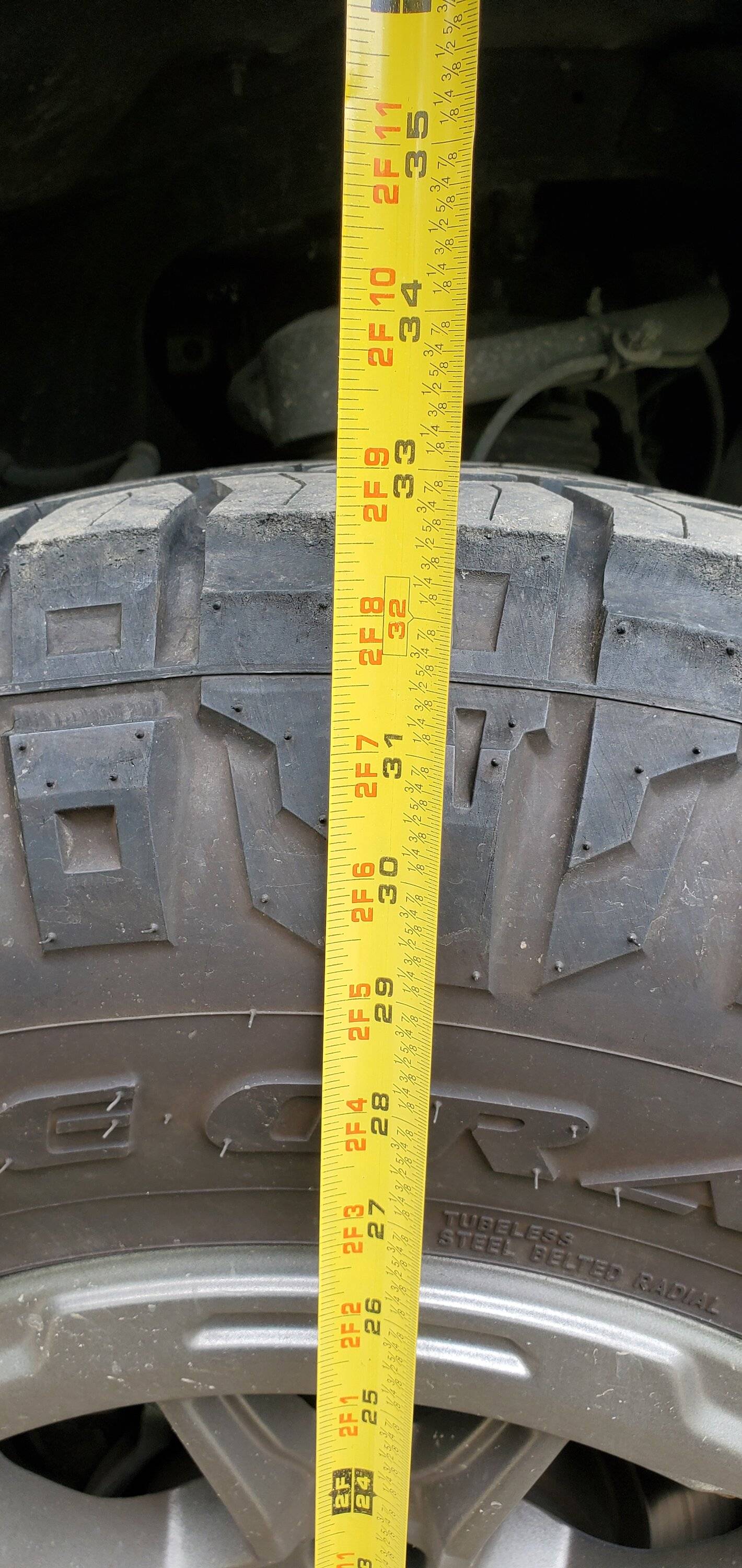

I have 285/70/17 its a good over all tire, good sound wise on the interstate and no big tire bounce and a good A/T snow /mud I dont know if or what the offset is on my Roush Rims are but I does not have a spacer and I have my crash bars, and a Rough Country Lift, I am not even sure how high of a lift but it sits pretty tall :) they measure out to 33" the Ridge Grappler seems to be a good tire but did not wear very good for me but that could be a Mr.Tire fault when I got it aligned too, I run them at 40psi next tire change I am going with the Wildpeaks
