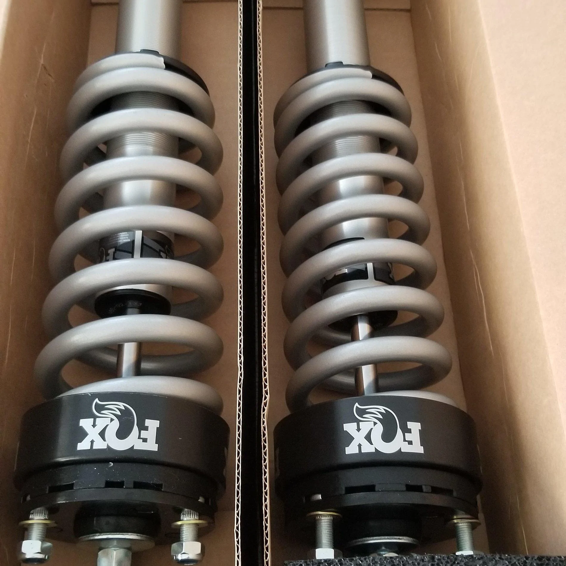

Did the Fox 2.0 come pre loaded for a 2" lift up front? Or did you have to adjust them at all? I got my set today, and Im installing them tomorrow.
Yes I believe 2. Honestly I didn’t even check. I’m happy with it.
I measured from the bottom to the shaft to adjusting preloading right bellow the spring, and it measures 5"

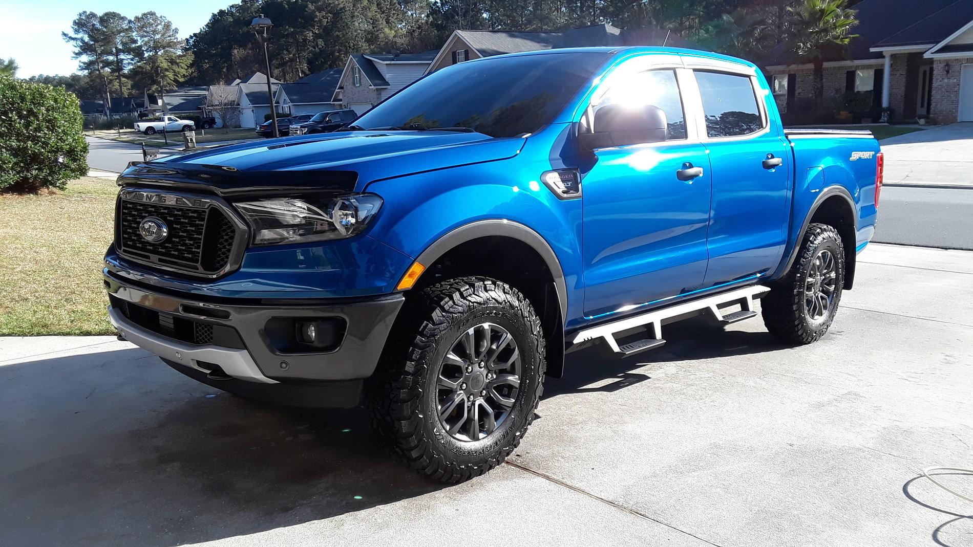

Dude that's a sweet set up. Quick question, Did you have to cut the crash bars to fit the 285s? Thanks for the input.
Thank you. No modification of the crash bar but I do have to run 1/4” spacers to clear the knuckle. Crash bar was fine. I also removed the plastic cover around the crash bar.
