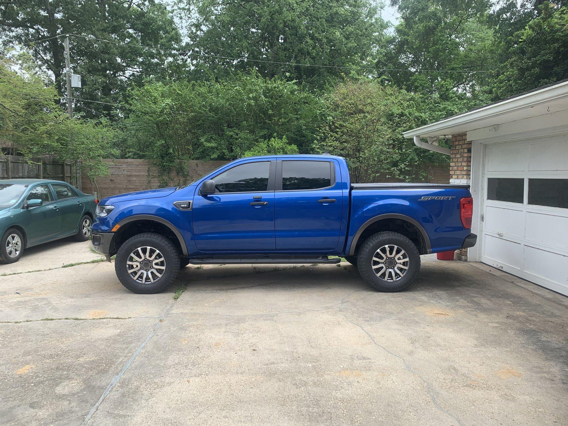

Current set up of the truck- SuperCrew Lariat FX4 with Sport and Tow packages. Here is a pic of the BFG's (275/65R18), along with shots of the VERY tight front crash bar clearance and the spindle clearance. I have a solid 1/2 inch clearance on the spindle....wish I had that on the front! Modified crash bars shipped today, I will baby this thing until they get here...

I really like the ride- feels planted and stable without being harsh. I have not noticed any power loss running these tires the last few days.
I will say again, though...I am not running this truck hard and being careful where I take it until my Fabtech intrusion beams arrive. Should be here today so I'll get them on this weekend at the latest.
