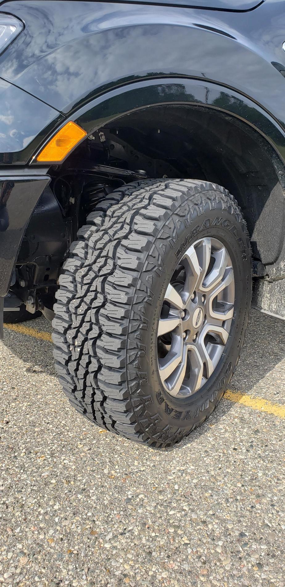

How do you like those Ultraterrains? I'm a little disappointed that they're a Discount Tire exclusive.
I like them a lot. They are pretty quiet for being an aggressive tire. It was either these, Duratracs, or Falken AT3Ws. Haven't been on any two track or trails with these yet. I imagine they will perform just as well or better, than Duratracs.

Running 275/65R18 with a 2 lift level. Been Working out very well after 4,000 miles.
Goodyear Ultra Terrain A/T's
Are you having any rubbing issues on the crash bars? Or have you had to mod yours? Or is the lift/leveling kit doing just that for you?

I have a 2 inch level in the front and 1 inch blocks in the rear. No rubbing in day to day to day commutes. Stock crash bars have not been molded. I do have an aftermarket set of crash bars I need to install though. Would like to do some trails next summer, and they will be needed when the suspension articulates more.

Which aftermarket bars do you have?
