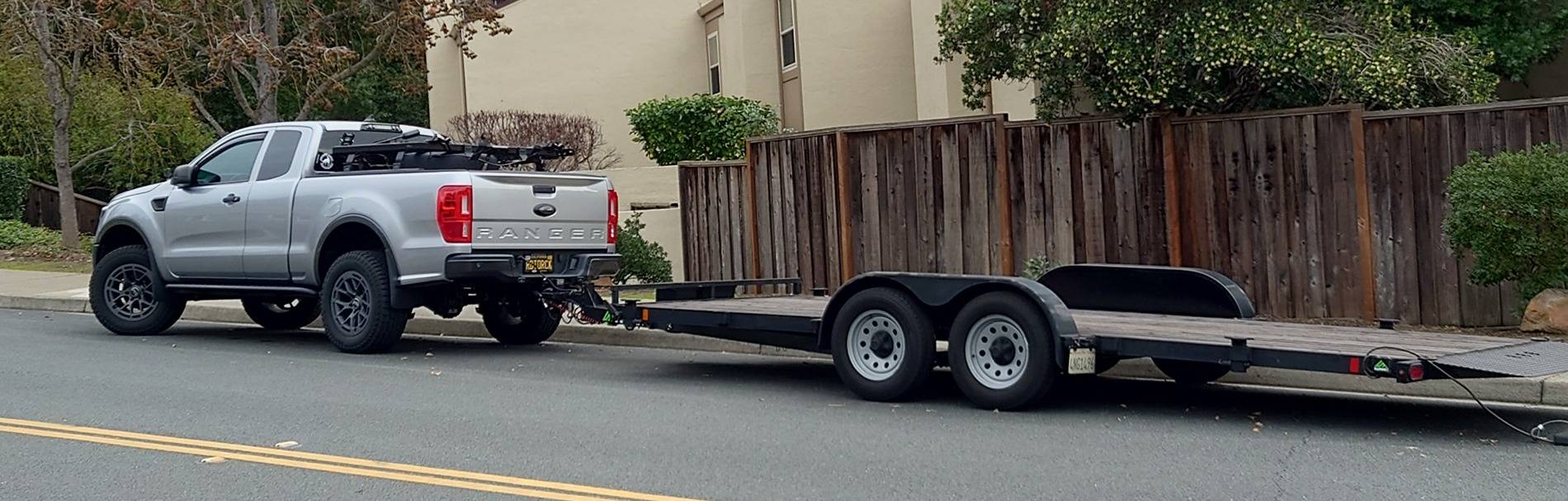

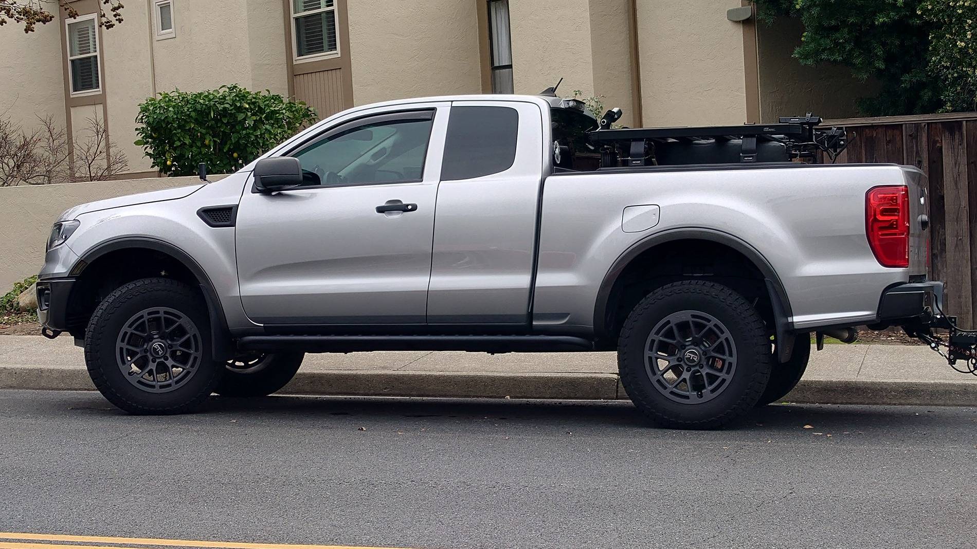

I started with Bilsteins 5100's at 1.75" lift and 275/70-18 with 18x9 +25 RTR Wheels
Better crash bars, stock ones were ugly.
Great setup, simple, 32 lbs of air. Rides great, No rubs! Econonomonomically sound, maybe not.
I now have Stage 7(ish) ICON full suspension at 2" upfront, and 1.5" in the rear. I have bed stuff and I tow, so I have some rake and I like that look.
Headed towards doing 275-70-18 (33's) with a +19mm wheel and blame @Colo_Ranger
I suspect your cap will be good to soften the harsh jarring and smooth it out, I had a '97 Ranger and the Canopy made it ride great. btw, look at all the other thread suggestions below about 18's.
My vote if you are changing stuff... 275's with a new wheel to move it out a touch, 1.5" to 2" bump in the front, and maybe bars. Your results may vary.

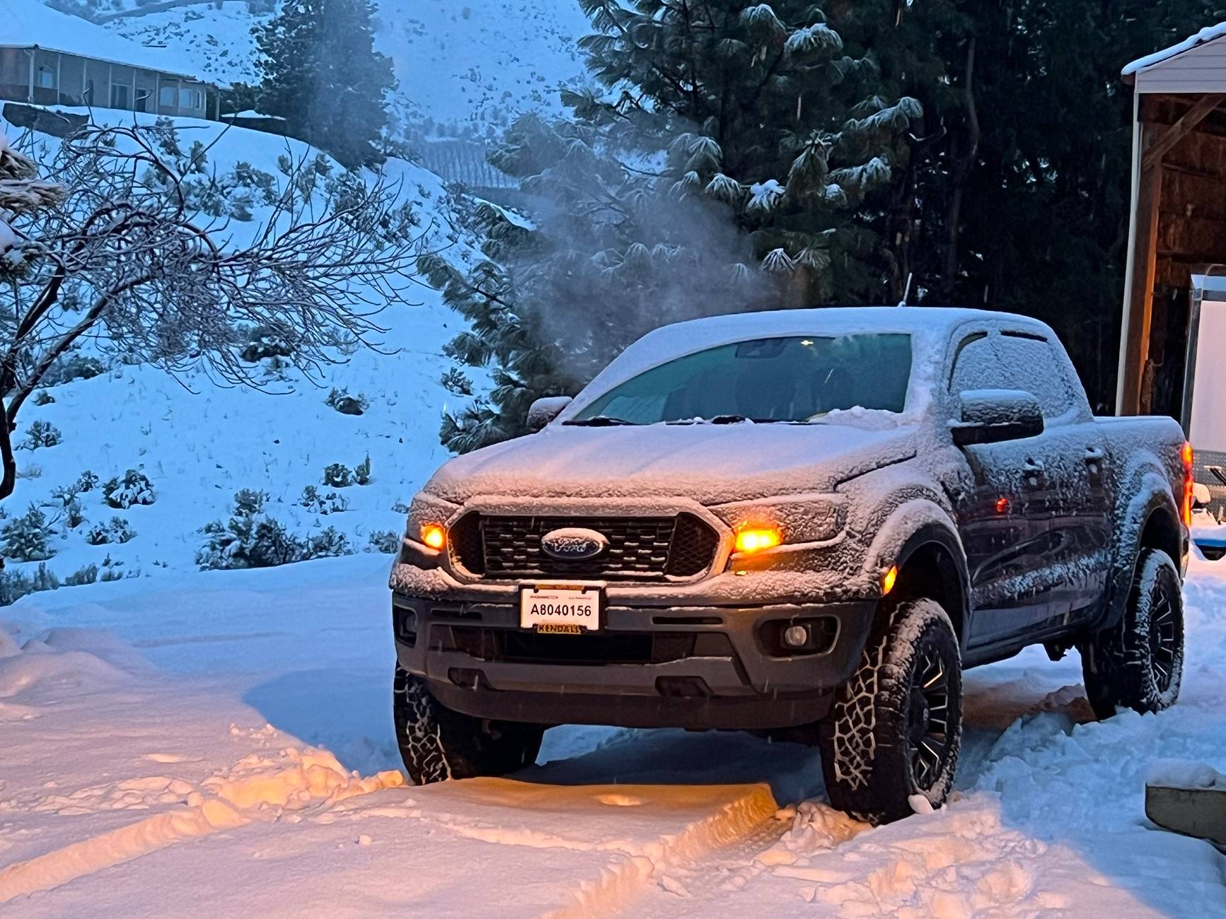

I have on my ā€˜20 XLT 285/65-18 AT tires.
Bought this pickup equipped this way.
18x9 Fuel wheels, not sure of the offset but they poke out slightly from my fender flares even, so I will guess 01 or -12 offset.
I will pull a wheel and check specs…
Oh, crash bars removed.
I am going to sell these wheels and get something more to my liking. And maybe more positive offset.
