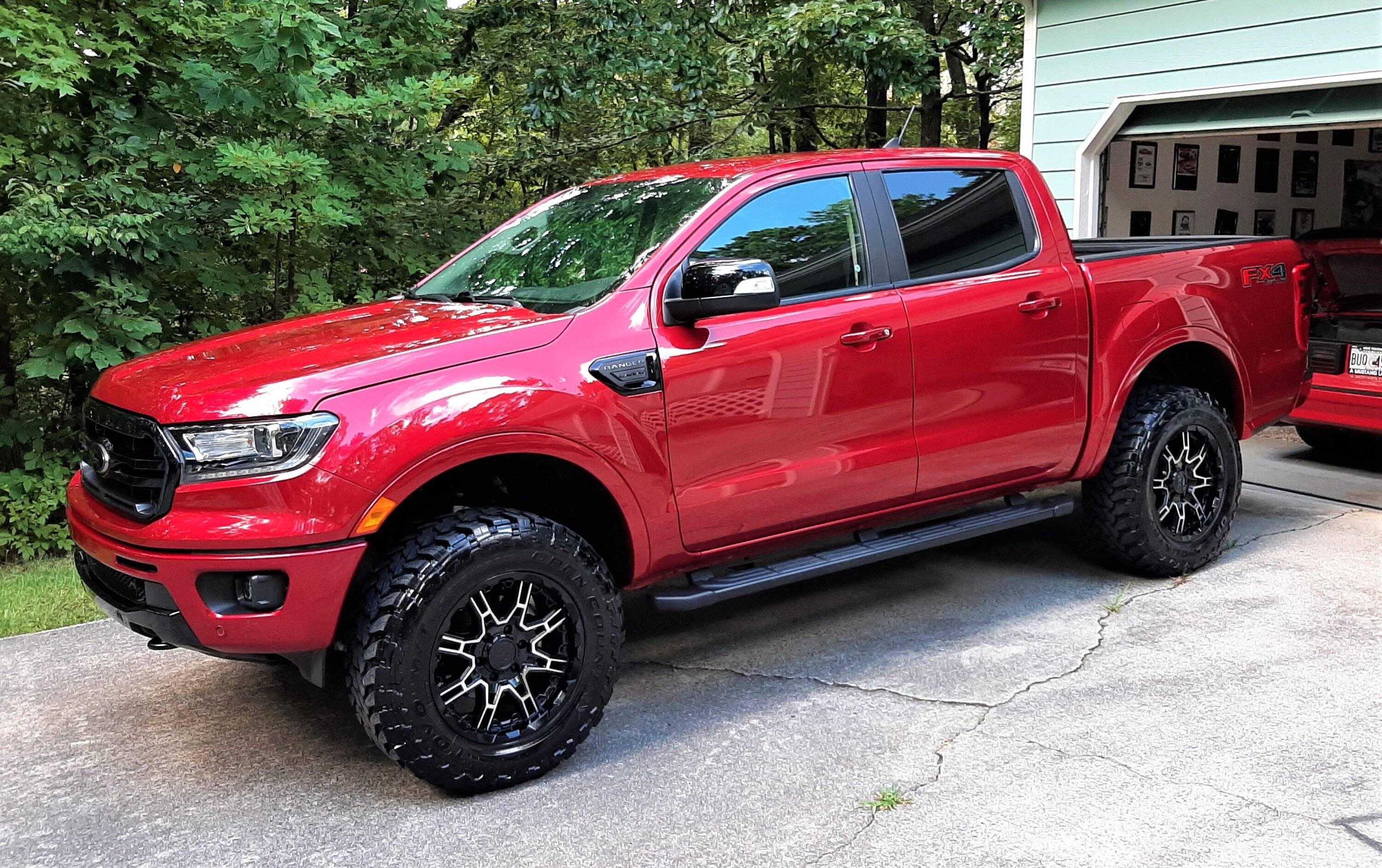

I ran that size for about a year with no problems with a 2.5" level.
Here's a pic for you.

Wow, that looks great… no rubbing or spacers / other modifications needed?

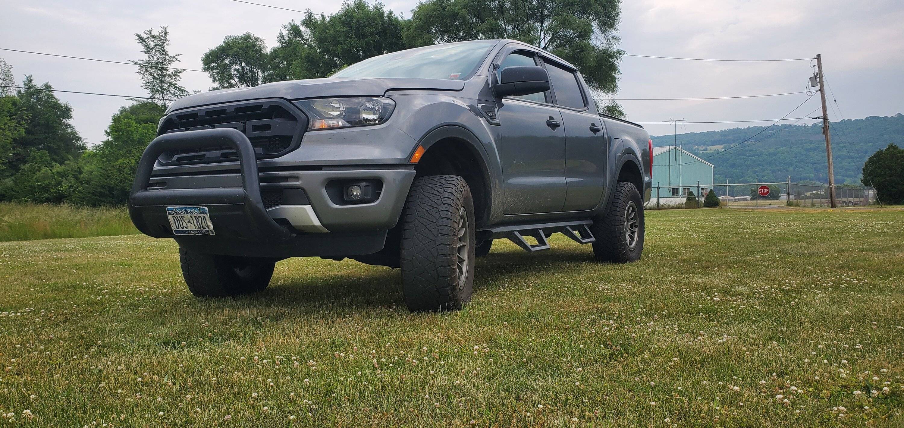

Go big or go home :)
I have 285/70/17 on Roush Rims 3" RC Rough Country lift, I still have my Crash Bars
No everything fit fine. On rare occasions there was slight rubbing when turning hard left while backing up.
