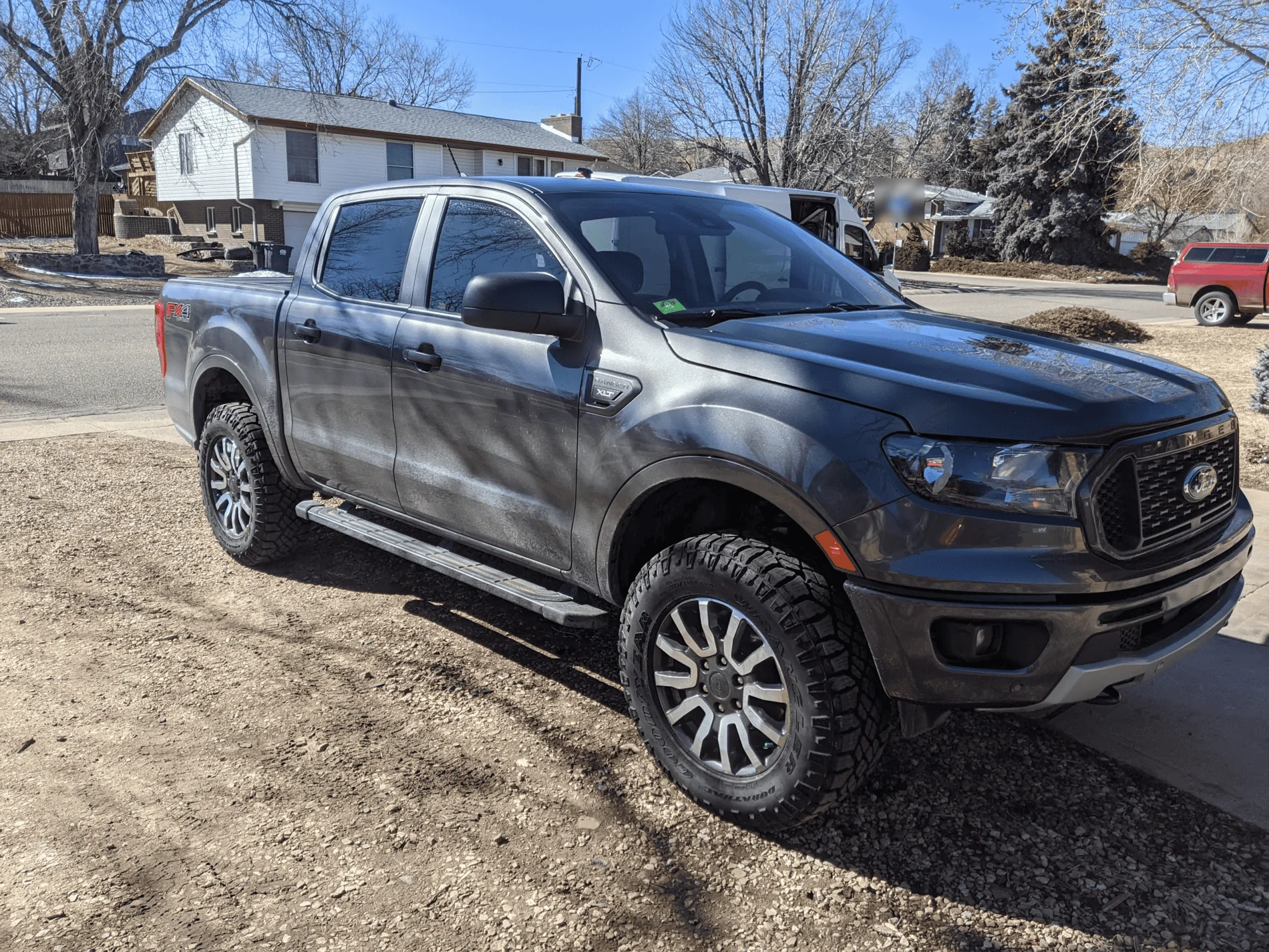

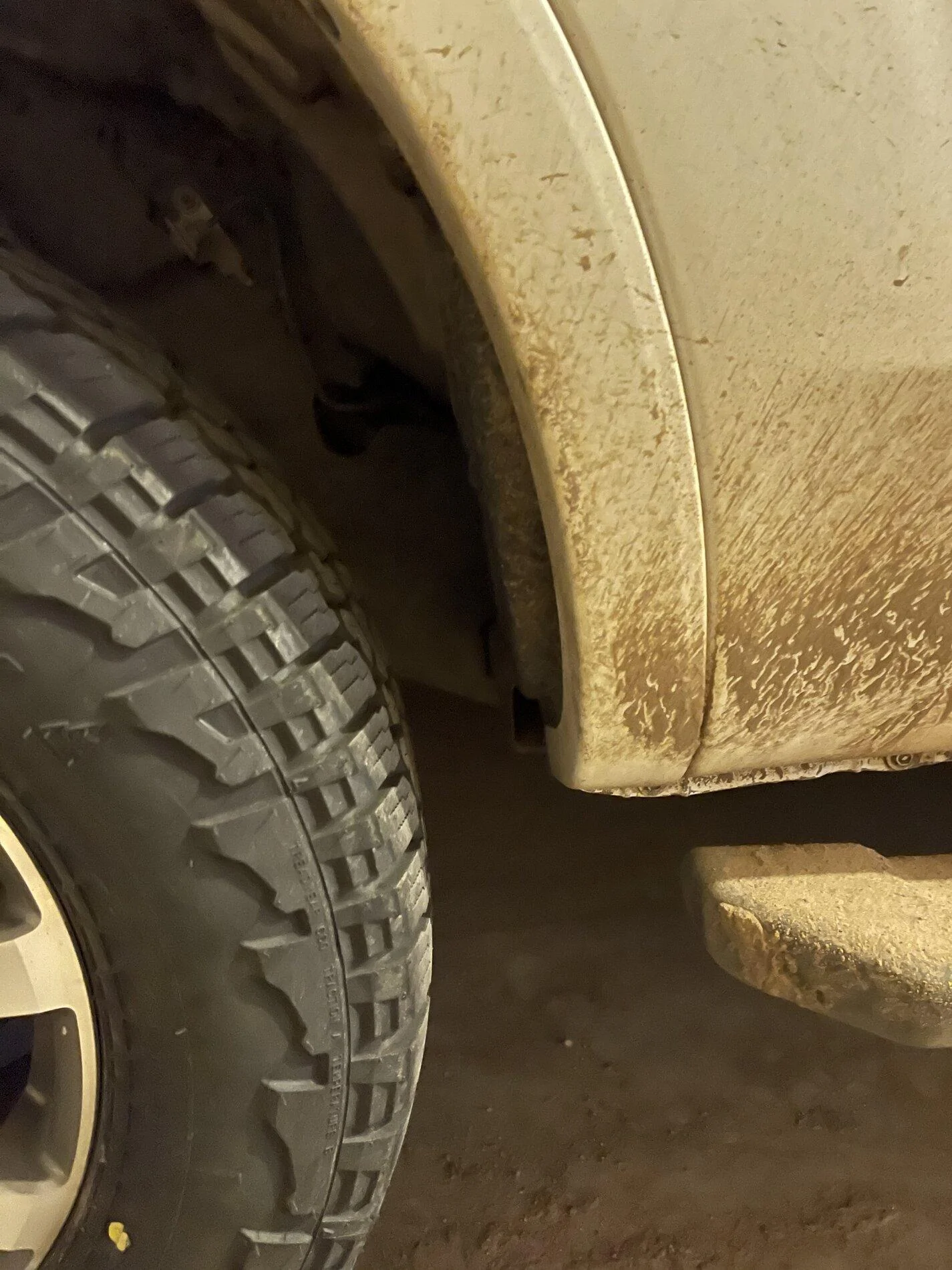

Current set up of the truck- SuperCrew Lariat FX4 with Sport and Tow packages. Here is a pic of the BFG's (275/65R18), along with shots of the VERY tight front crash bar clearance and the spindle clearance. I have a solid 1/2 inch clearance on the spindle....wish I had that on the front! Modified crash bars shipped today, I will baby this thing until they get here...
This is exactly the size I am going to go with in Nittos. What about rear crash bar clearance? I have the Weathertech splash guards which are similar to the Ford ones. Also, are you leveled? It looks like your front is stock height. A level might have given you clearance without needing the crash bars.

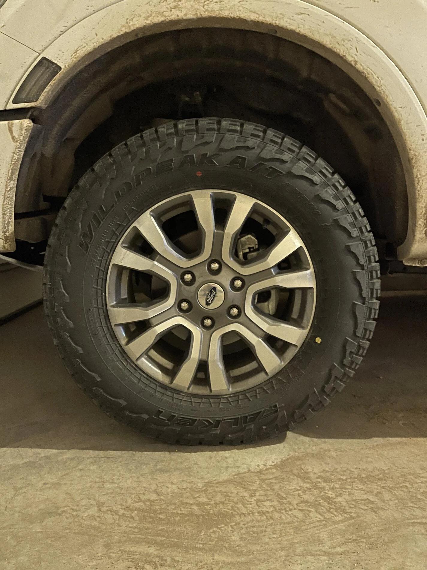

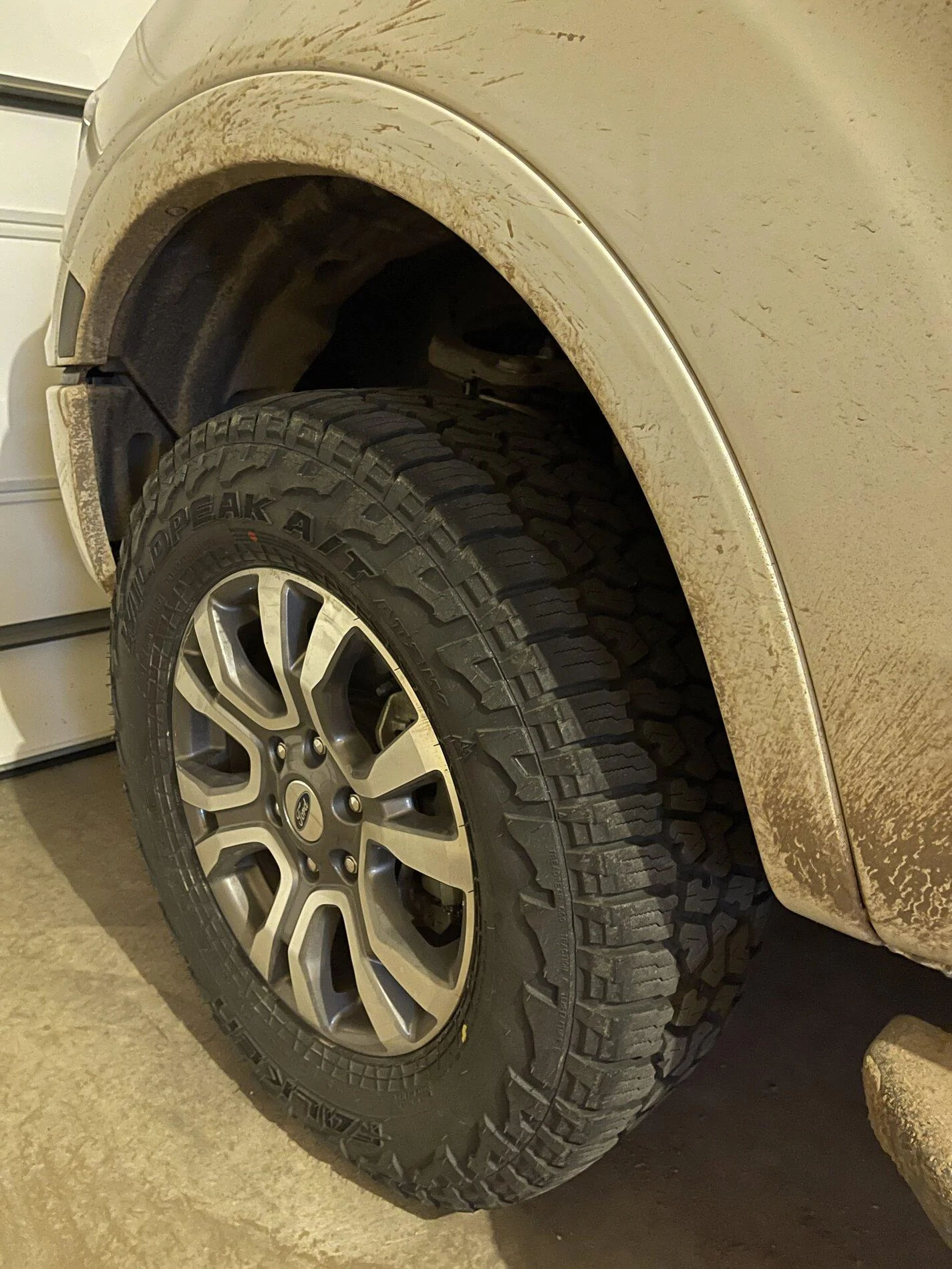

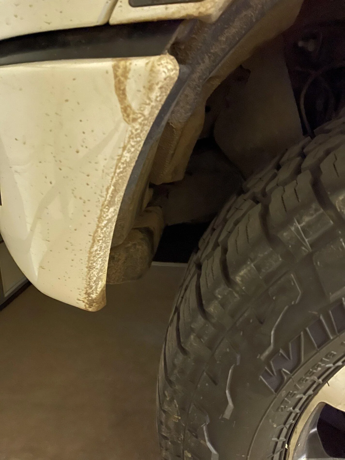

I currently run 275/65/18s with the Falken Wildpeaks, and I have no running nor did I need to add spacers. For reference I have the Eibach coilovers, so my truck is leveled at the default setting. Hope this helps.
I ran without a level for a couple of weeks before my kit and my crash bars came in. No rubbing but I did baby the truck during that time.
I don’t “four wheel” but I do camp (primitive, offsite) and hunt, etc. so I did not want to take any chances.
Love the look of the Nittos BTW, ran them on my previous F-150

got any photos? I want to do this size and keep the stock wheels. I was planning on doing the fox 2.0 level.
Just took some now. Excuse the mess, there’s been sporadic snow around here, so the roads have been muddier than usual.
Once the forecast gets better, I’ll wash the truck and post some more pictures if need be.
