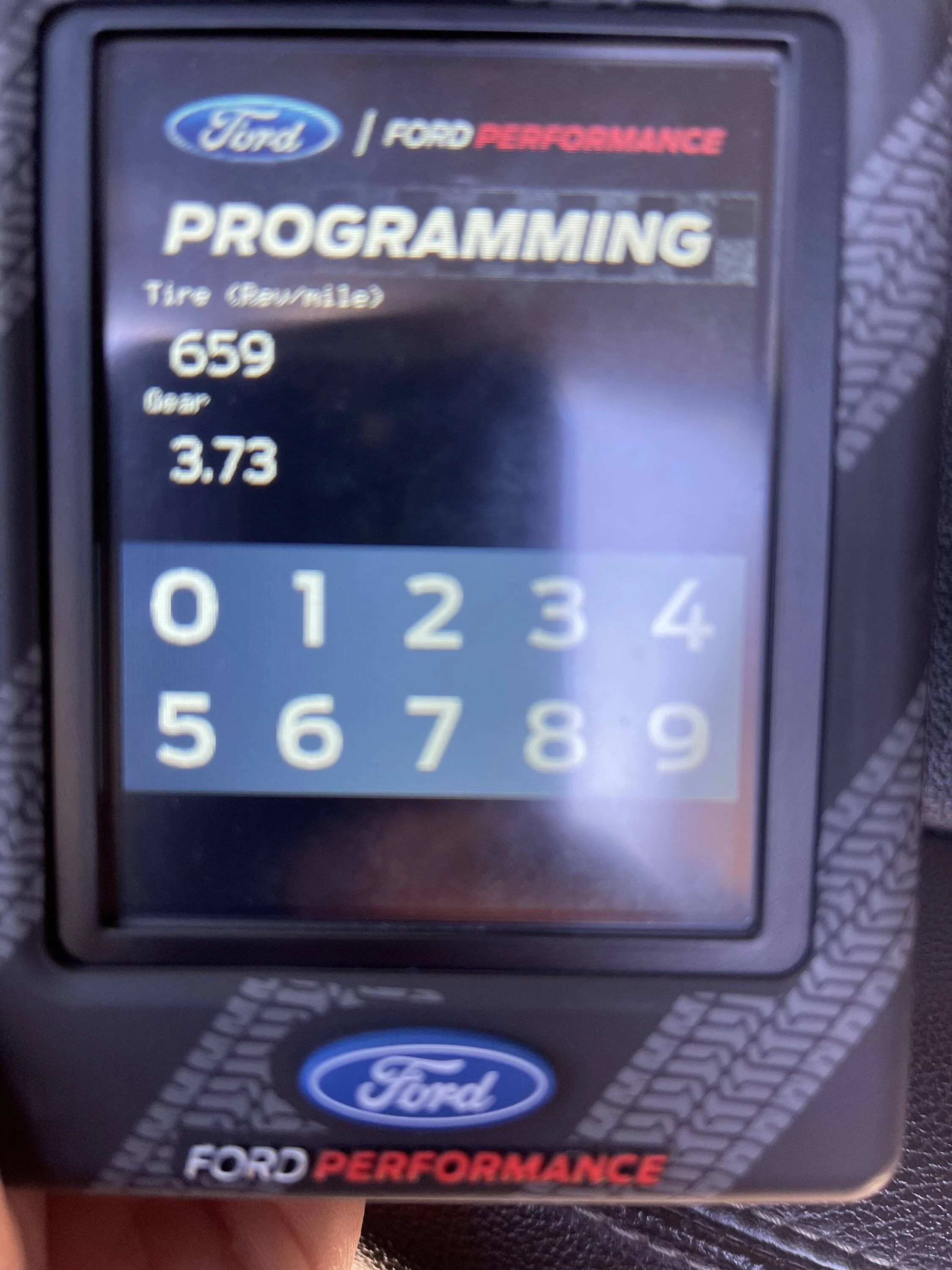

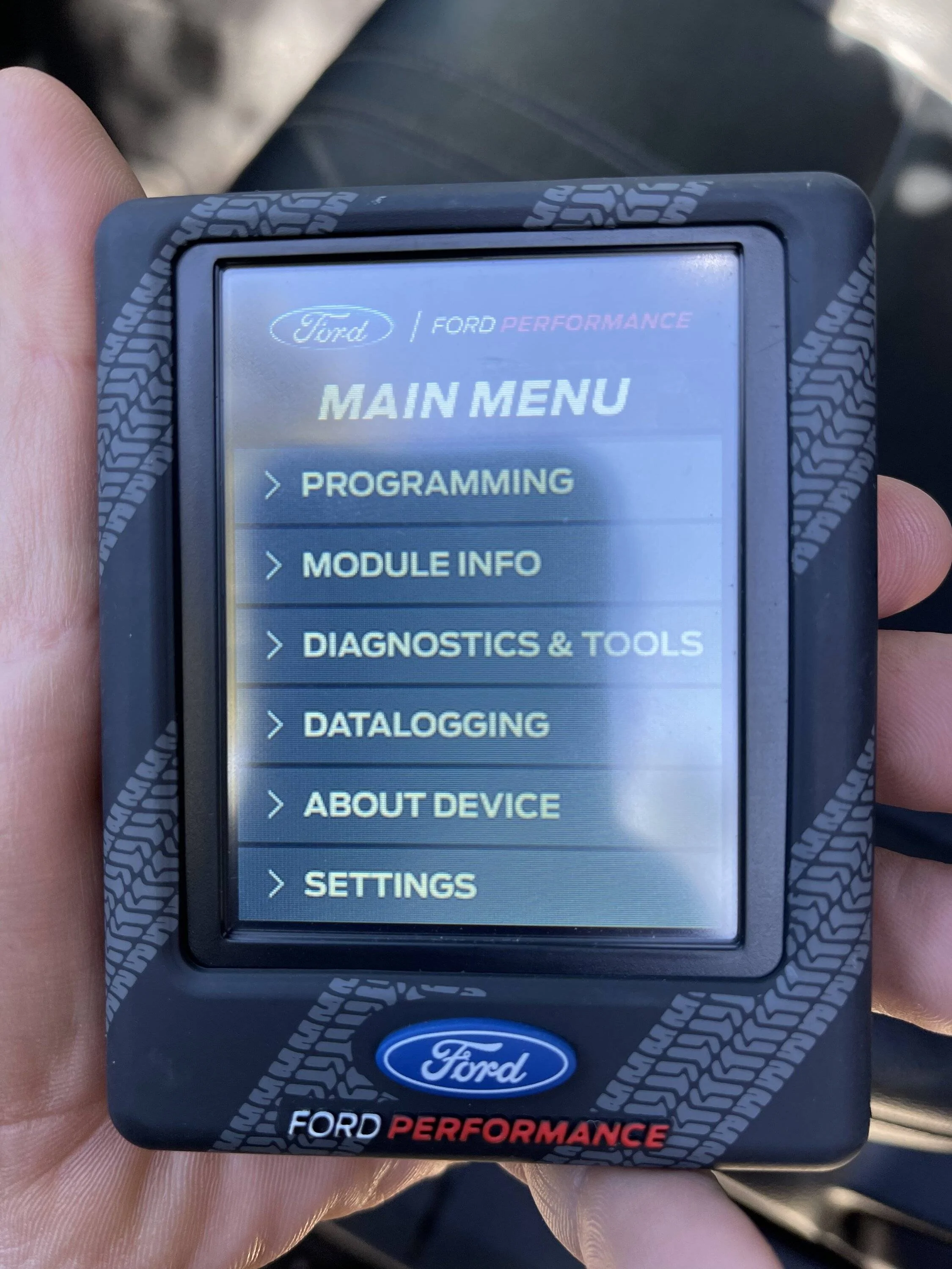

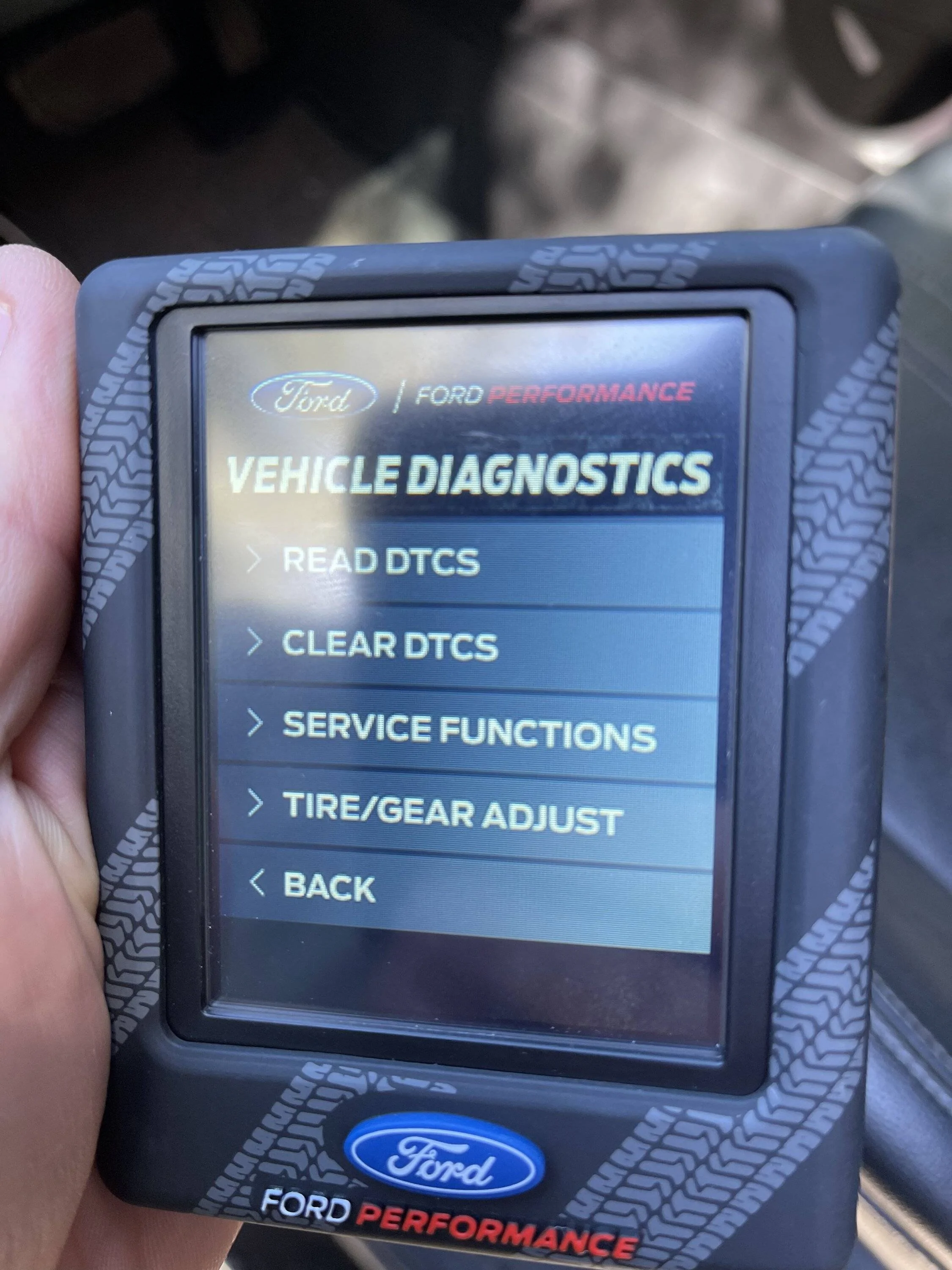

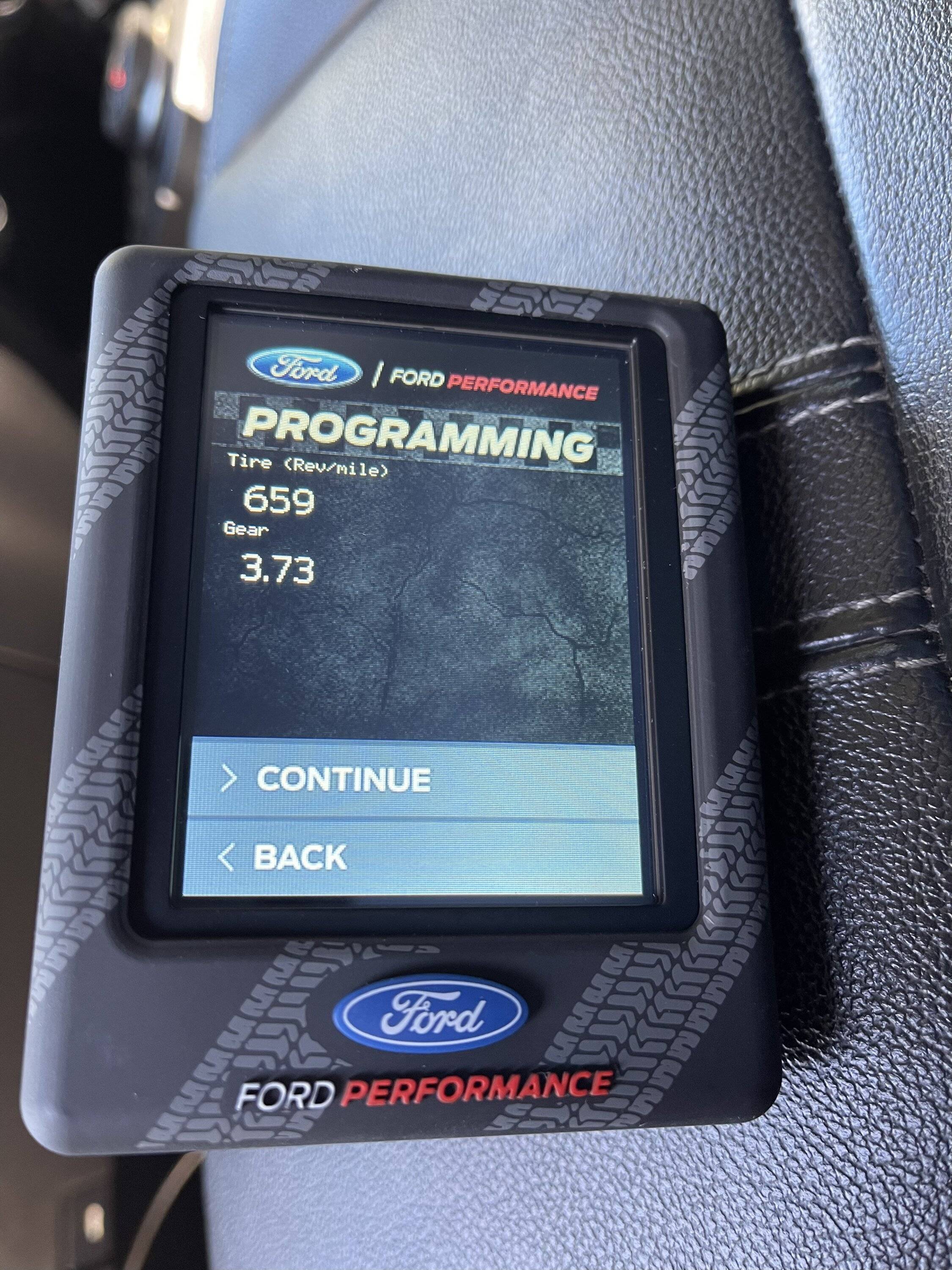

Ranger X3
Matthew
Aug 25, 2020
29
1,597
Sedona AZ
2019 Ranger Supercab Lariat FX4
Tap- diagnostics & tools, tire/ gear adjust, tap tire and type in new revolution per mile number 618 (Google search) then follow on screen prompts.
