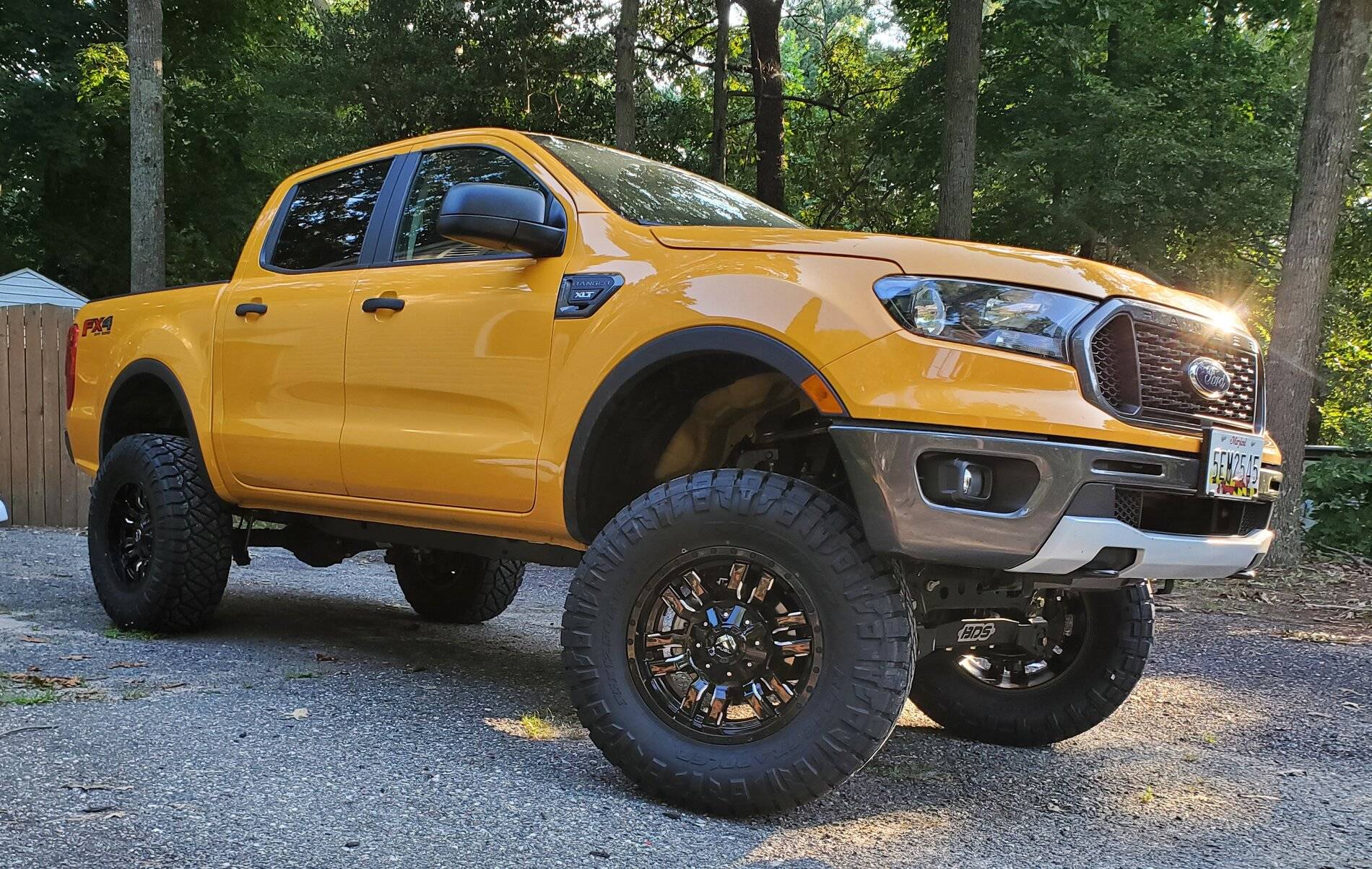

Anyone with 35s running the Ford Performance Tune?
I currently have a 6 inch BDS lift with 35s and used the Rough County speedometer calibration tool (which actually had to be set to 33.5" to get an accurate reading). I would like to run the Ford Performance Tune, but on their website it says "Tire size configurable up to a maximum diameter equivalent to a 265/70/17 tire"...
https://performanceparts.ford.com/part/M-9603-REB
Is that accurate? If so, does anyone know if I would be able to run the tune in conjunction with the Rough Country speedometer calibration?

Tune was delivered very quickly...
Just installed it and can confirm that you can change the revs per mile to lower than what Ford states.
I'm currently at 610 with 35" Nitto Grapplers and the speedometer is reading perfect.
Tune definitely wakes the truck up.
