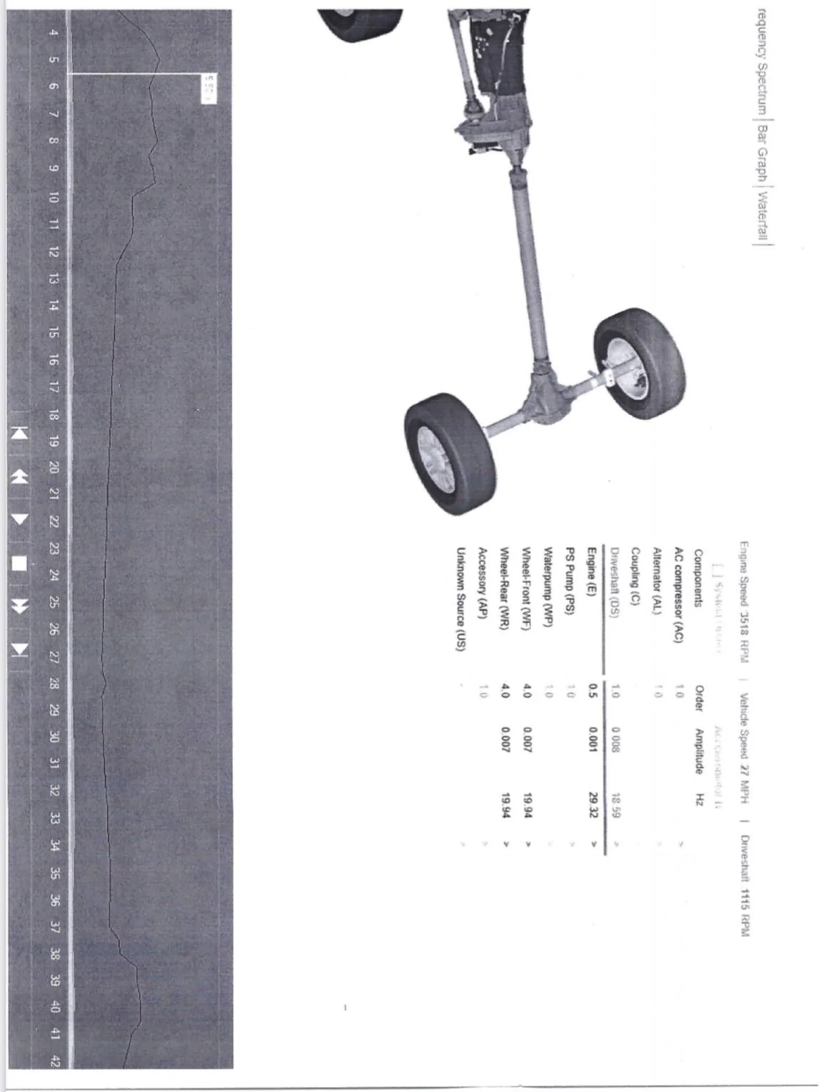

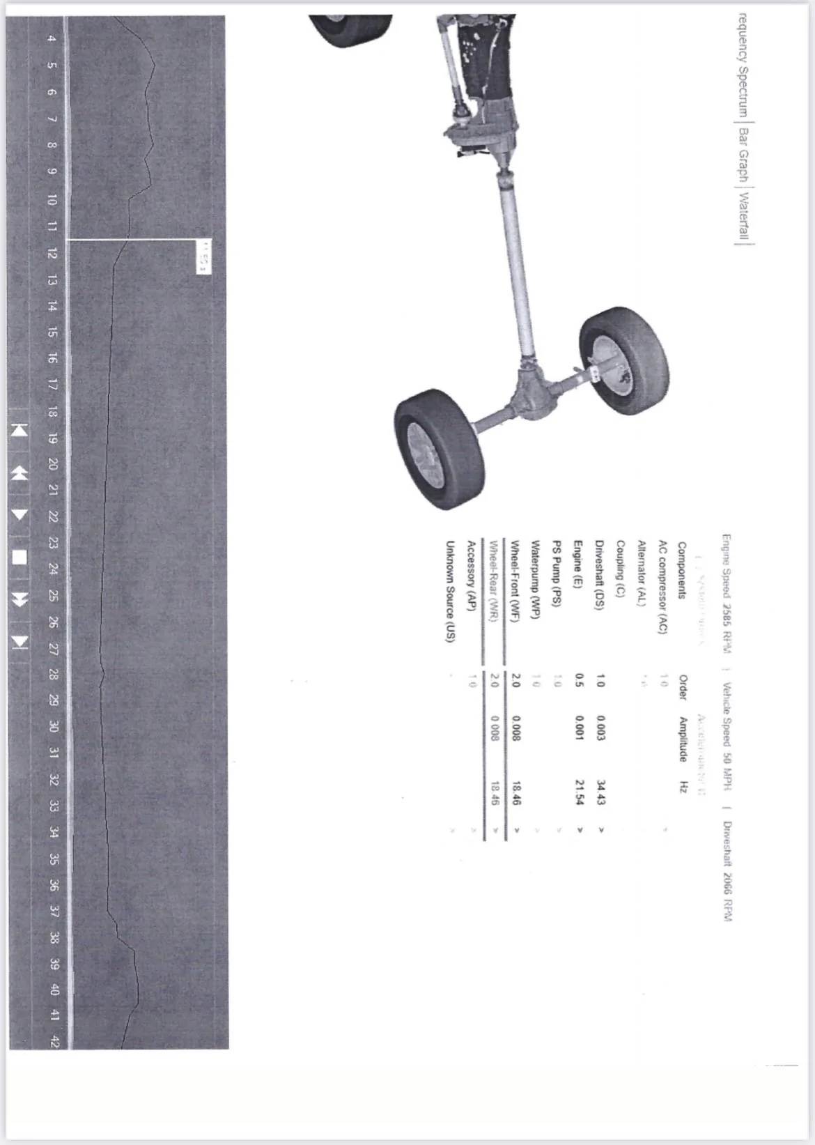

Finally heard back from dealer about order of vibration they detected when using their VCMM scan tool. They sent me these images recorded while on test drive. Thought I would post them for informational value. Truck rides much better. Still a slight thing going on but I may be hyper sensitive too.
I don’ think i can read this clearly on my phone. What did they do/find?

Hi Steve,
A bit hard to follow....but tires were certainly flagged and a rebalance reduced the vibration, but the 2nd order in the last pix may indicate a slightly out of round tire...Ovality as it may be called. Do not know if tire folks can "true" tires like they could about 10 years ago. That may clean up the residual vibration which you are sensing. The dealership equipment tries to interpret the measurements and does a pretty good job, but sometimes the algorithms do not create a definitive case for a secondary cause....out of round as well as balance....
We use to say in NVH...there is no magic bullet...there is always more than one contributing factor. Anyway, you got the big hitter...Tire Balance.
So take the frequency noted and multiply by 60 and you will get the likely engine RPM or Driveshaft RPM dependent on where the unit was placed.... Does this agree with RPM when you are doing 50 to 60 mph? Just curious as I do not know the "science" behind these FFT based analyzers.

Thanks for chiming in. I was looking at that RPM/speed thing also. I’ll have to take it for a ride to compare. The screen shots were before the dealer static balanced the tires which gave some improvement. The biggest change was when Discount Tire RoadForce balanced the left front. They got it to the best that they could but I still think there’s something up with that tire. Pondering swapping my new unused spare onto the left front to see what that does. Would put in on the same rim and have it RoadForce balanced.
