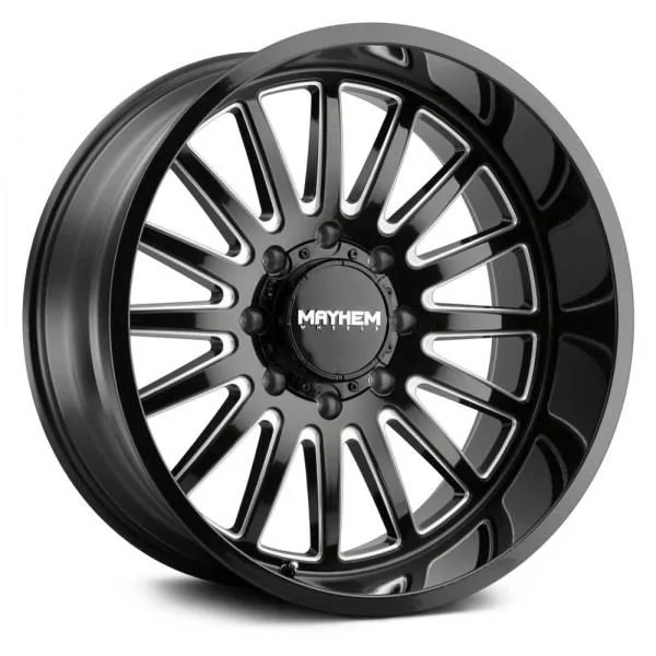

I’m gonna put Amp tires on my truck when the Generals wear down and I’ve been looking at a set of Mayhem wheels that I think would look great with the Cactus Grey

Hahaha I promise it’s not as edgy as it sounds. These are the ones I’m probably gonna do because it’s a departure from the Tremor split spoke
Not bad.
Even better if you could find a different centercap.

Not a fan of those wheels.
But to each their own.
