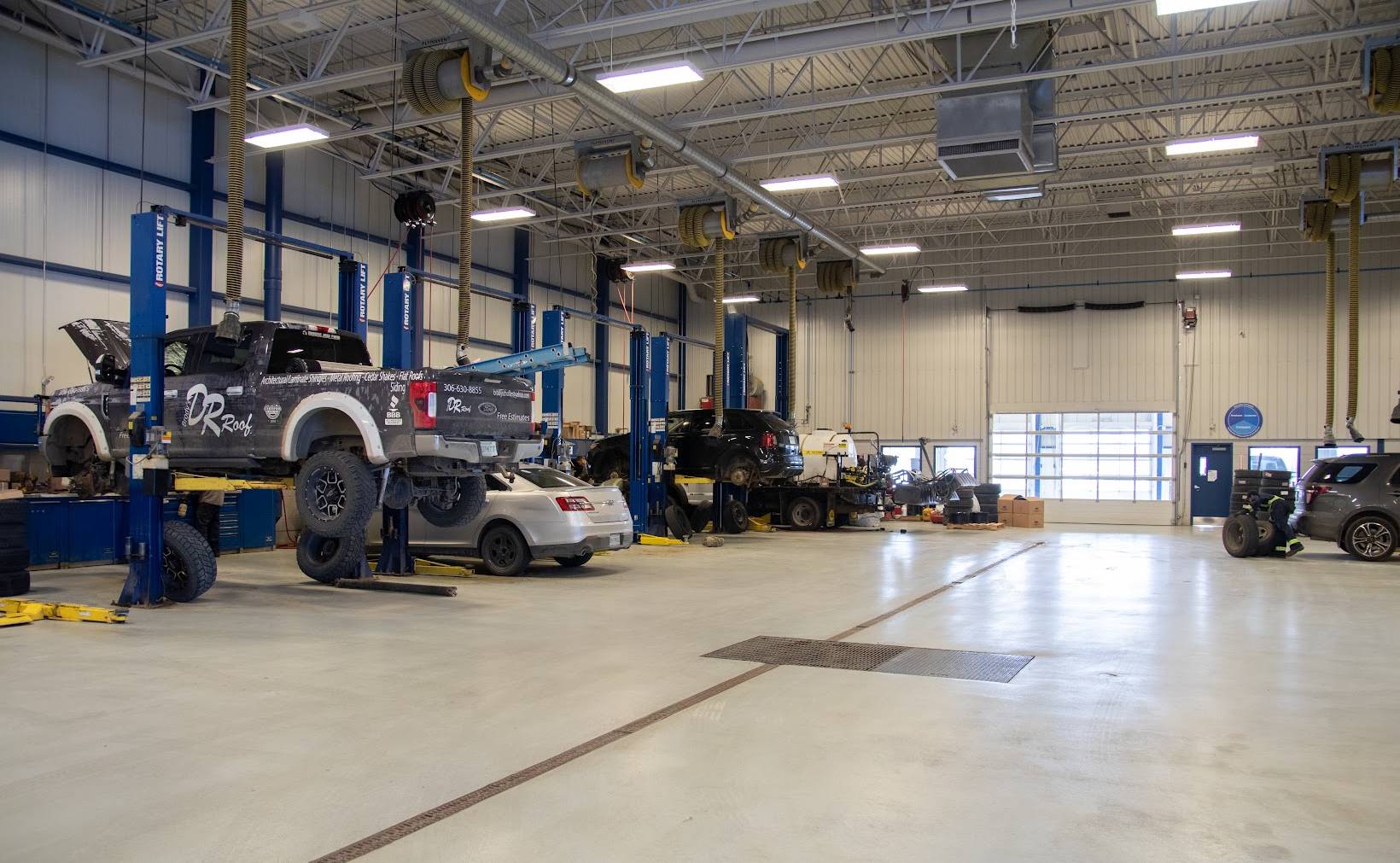

It seems like it’s something unique to your truck. Make sure your side mirror cover/cap is tight and not mis-aligned and if it’s fine, I’d definitely bring the vibration issue up with these guys….
