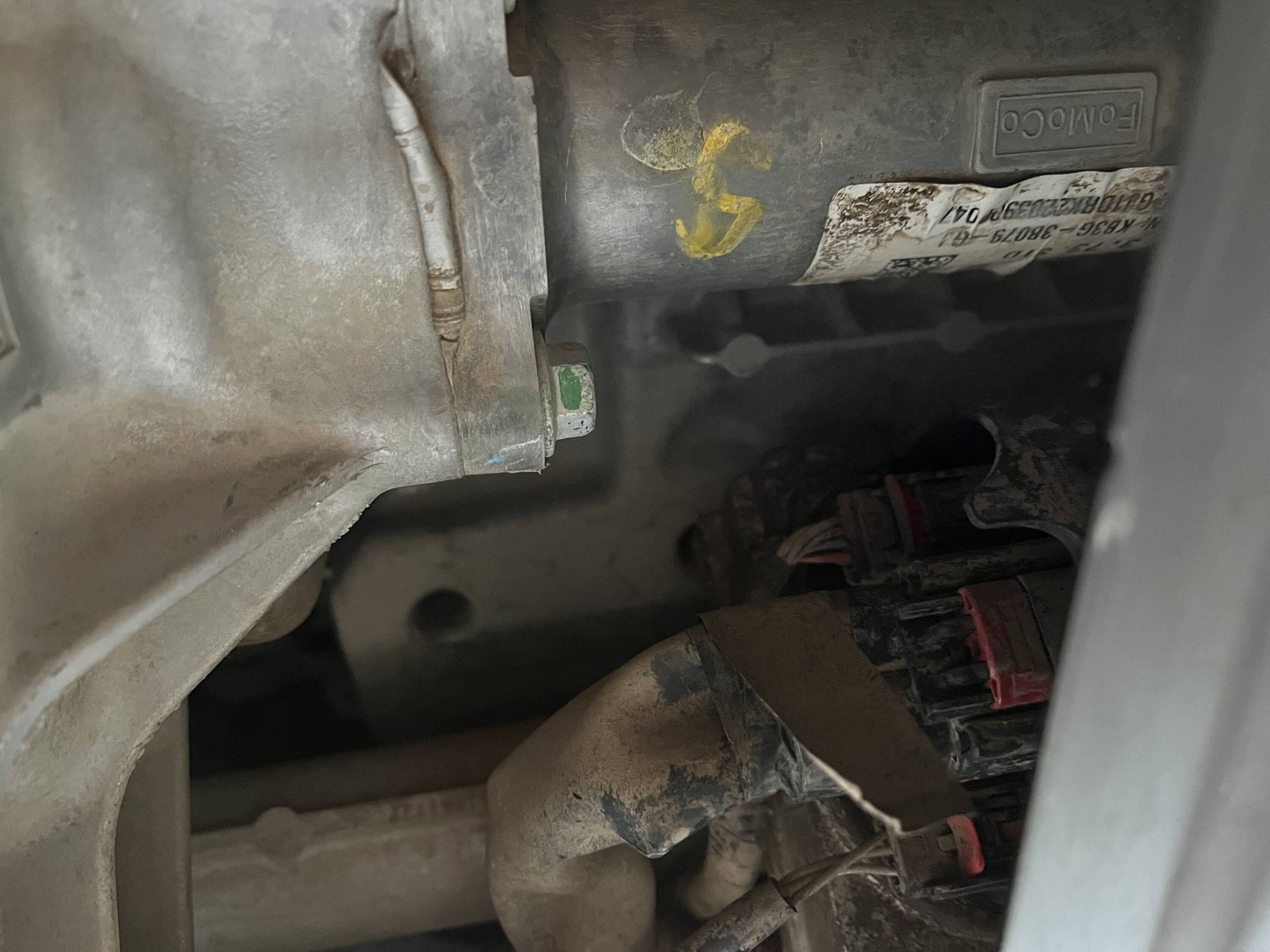

Where did you find the serial number? Can't seem to find it...Although it might be because the damn trans is now COVERED IN OIL FROM A LEAKING TRANS@@!!! This is tiring... now gotta take it in for that.
It does make me wonder why the seal is blown out... maybe the vibrating shaft is causing early demise???

Tag on front axle tube right above area where diff fill snd drain plug are
