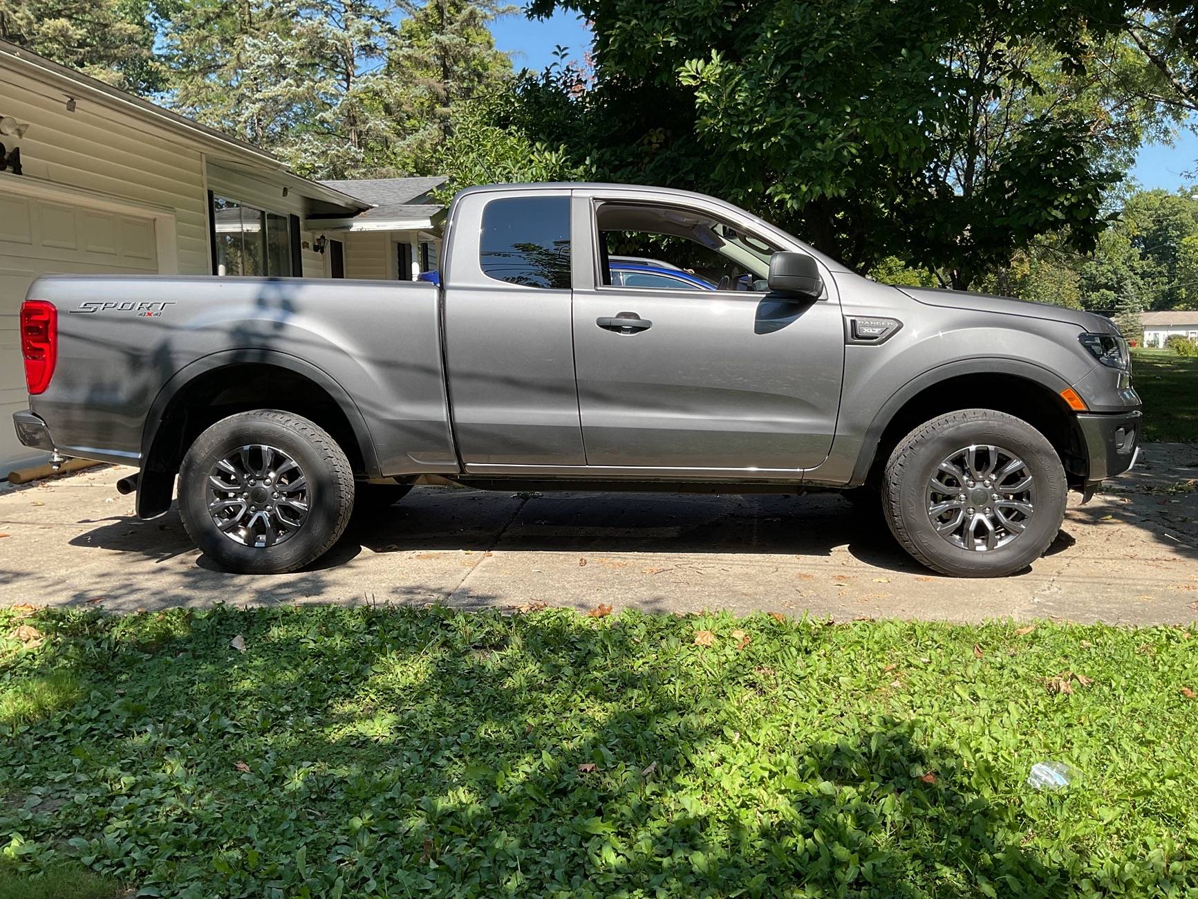

Hello, I have a 2021 4 cylinder extended cab (not the 4 door) 14-16mph has been pretty consistent, I got 22mpg once on an expressway set the cruise road trip years ago. Pretty dismal actually. I don’t drive agressively. I have drove aggressively and had it in Sport mode for a few tanks over the years to see if it would make a difference, not really. I keep up on maintainince. Everything checks out good. I don’t understand how I am getting such crap mpg when the quoted mpg from Ford is significantly higher than what I am getting. Any assistance would be appreciated! Thanks.

Thanks for the responses folks!
Truck is a 2021 & has just 15,200 miles on it.
No engine mods, just added mud-flaps from Husky, & some interior mats & little stuff.
About 90% short city trips, which I know hurts MPG. On the 10% highway trips I may get 22 MPG.
I always let it warm up for about 5 minutes before I take off.
I drive it pretty gently most of the time, like I want it to last forever is how I drive it :)
I’m in Michigan, and it doesn’t seem to matter if it’s 100 or negative 30 degrees, it’s about the same regardless.
My tire pressure is always kept on the upper end of what’s recommended - 30psi.
I get 3 or 4 oil & filter changes a year regardless of miles or usage.
I also replace the air filter then.
Fuel filter has been checked, flows fine, isn’t clogged.
I do not rest my foot near the brake pedal.
It coasts very well.
It has been scanned a couple times before, nothing.
No noticeable transmission issues detected by me, or the dealer.
I don’t have a spreadsheet but I have kept gas receipts and write the mileage and MPG I got from the last fill up to check for fluctuations.
I have not checked my brake calipers as you mentioned, but I will on its next outing.
Also - I had it go into limp mode on me while I was on the highway about 3 years ago. Turns out one of my coil packs was bad…. On a 2 years old truck :/ Ford replaced it and also told me they had a whole batch of bad ones that they know of.
Thanks again for the responses & I’ll keep playing detective with it.
I also remote start it about 75% of the time and, in winter, I can let it easily idle for 15 minutes. In the summer, a few minutes to maybe 10 when at work.
That certainly drives down my MPG big time.
For me, a 5-minute warm up for a 10-minute trip means that a third of that "trip" is idling.
