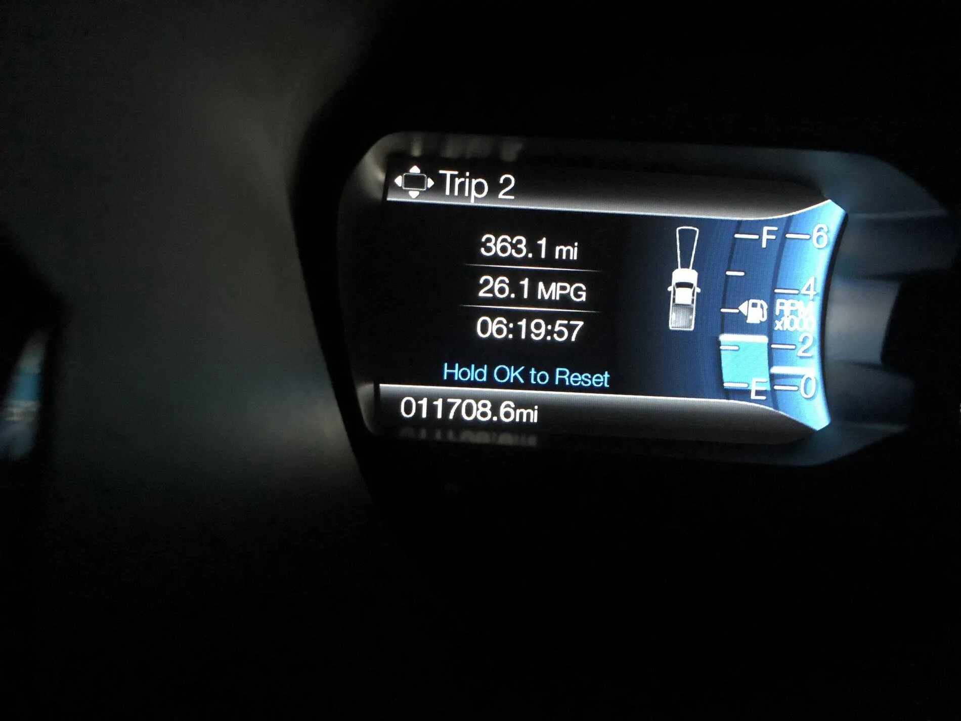

I'm on a mission. I have owned my Ranger for 2 weeks now. It's lifted and has big ol tires and a winch and all that good stuff. And I love the look of it. I do NOT love the MPG numbers. I'm averaging a pitiful 14.5. So, my mission is to get that up higher. My plans are to swap out the tires to a narrower AT tire, which should help a bit. But I'm asking you: What else should I do for some MPG help? Is there an MPG helping tune? What is the best bang for your buck to aid MPG?
With the Livernois tune I gained about 2 mpg with "normal" driving. Once you get one it all bets are off. It's been said many times these ecoboost engines are either eco (economy) or boost (fun) you can't have both. Changing out the tires will help too as I'm running 265/70/17 and you can see my average of 21.7 in my sig below.
This was an all highway trip with the ACC set to 75 mph both ways with the 91-93 performance tune and 91 octane.
