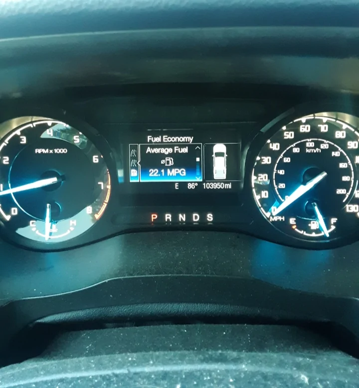

Let quote myself here lol!
I'm going to update this, with the addition of the new wheels and all terrain tires, and the truck now has 103,000 + miles on it. The fuel mileage took a little bit of a hit considering the fact that the ATs are little bit more heavy duty than the previous HTs it had on it. Currently it averages, city and highway combination. Lowest average is 20 to 21.5 mpg. Highest average is 23 mpg, still roughly over a three day period. I declare it "Good Enough!" Lol😎🤘
I took this after topping it off with fuel and making the 50 mile drive home.
Consistent 😎✌🤘
