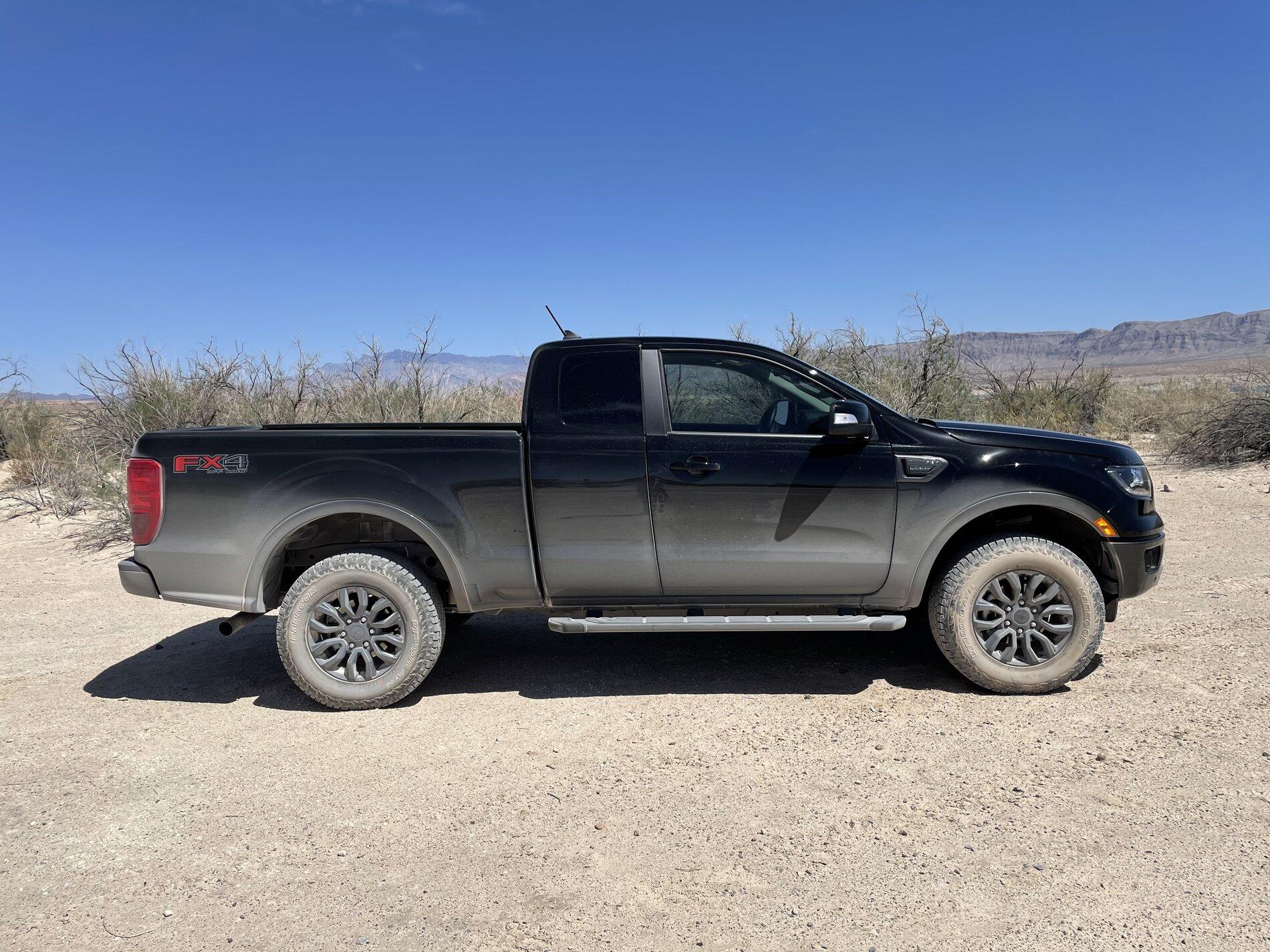

2021 super cab Lariat FX4.
Front - 36 1/4”
Rear - 38 1/2”
10 days old with 2000 miles and measured with 150 lb sliders installed (pic is old side steps)
Front - 36 1/4”
Rear - 38 1/2”

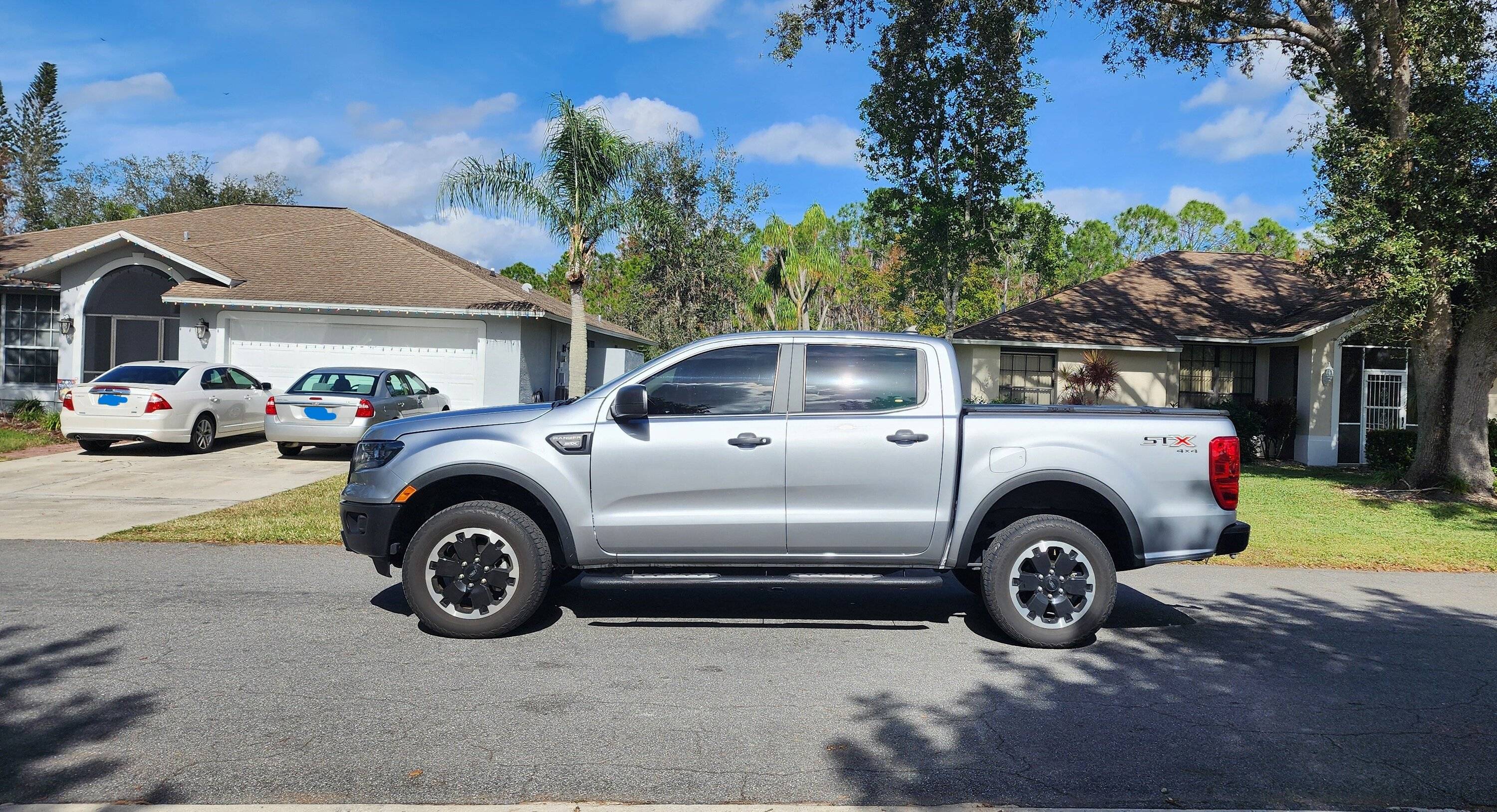

2021 Ranger STX 4WD
I know this is a bit of an old thread but for anyone still interested.
2021 SuperCrew Cab 4x4 STX with 18" Wheels 40K miles, low tread.
35 5/16" Front 37 3/4" Rear = 2.4" difference
I'm considering the Ready lift 3" leveling strut hats, but I'm wondering if it might be too much and I'll end up with a higher front end.
Anyone else use the 3" level kit on a 2021 supercrew cab 4x4?
You'll be nose high.
IMHO, I'd leave about 1" of rake to allow for the rear to squat when towing or hauling. Just my two cents as my pet peeve is squatting trucks, lol.
Thanks Ed, I don't like the squatting either. It's very popular here in SW Florida among the younger kids. I only tow a boat once or twice a month to the ramp and only haul occasionally with special projects. The only permanent weight I have in the bed is my hard tonneau cover.
