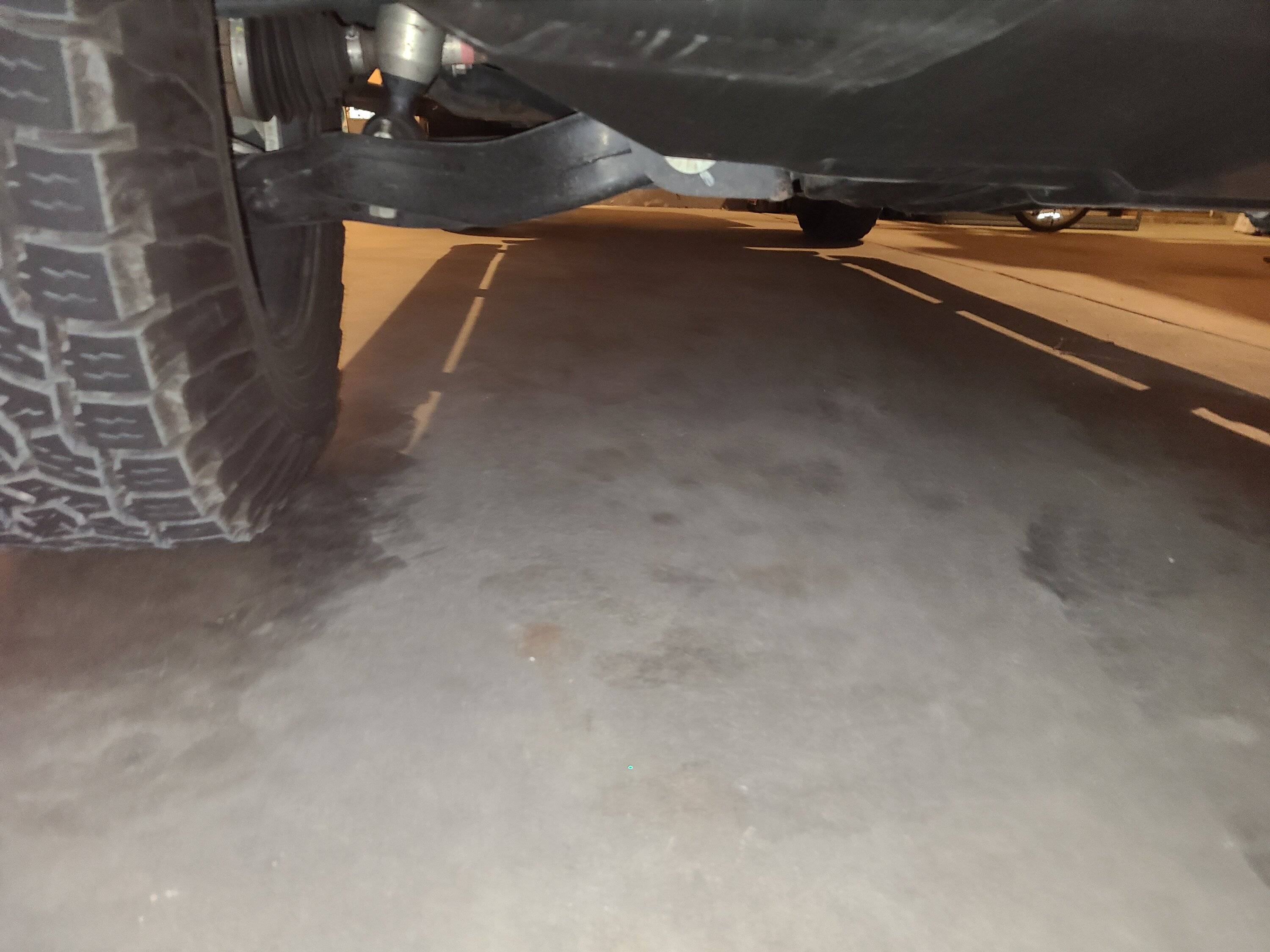

Saved you the trouble.
See that lower control arm. It doesn't move with a lift/level.
My truck is lifted 2" up front on 33" tires. True, the hood sits about 4½" taller than it did factory on 30.5"s.
But I only gained about 2½" in clearance.
