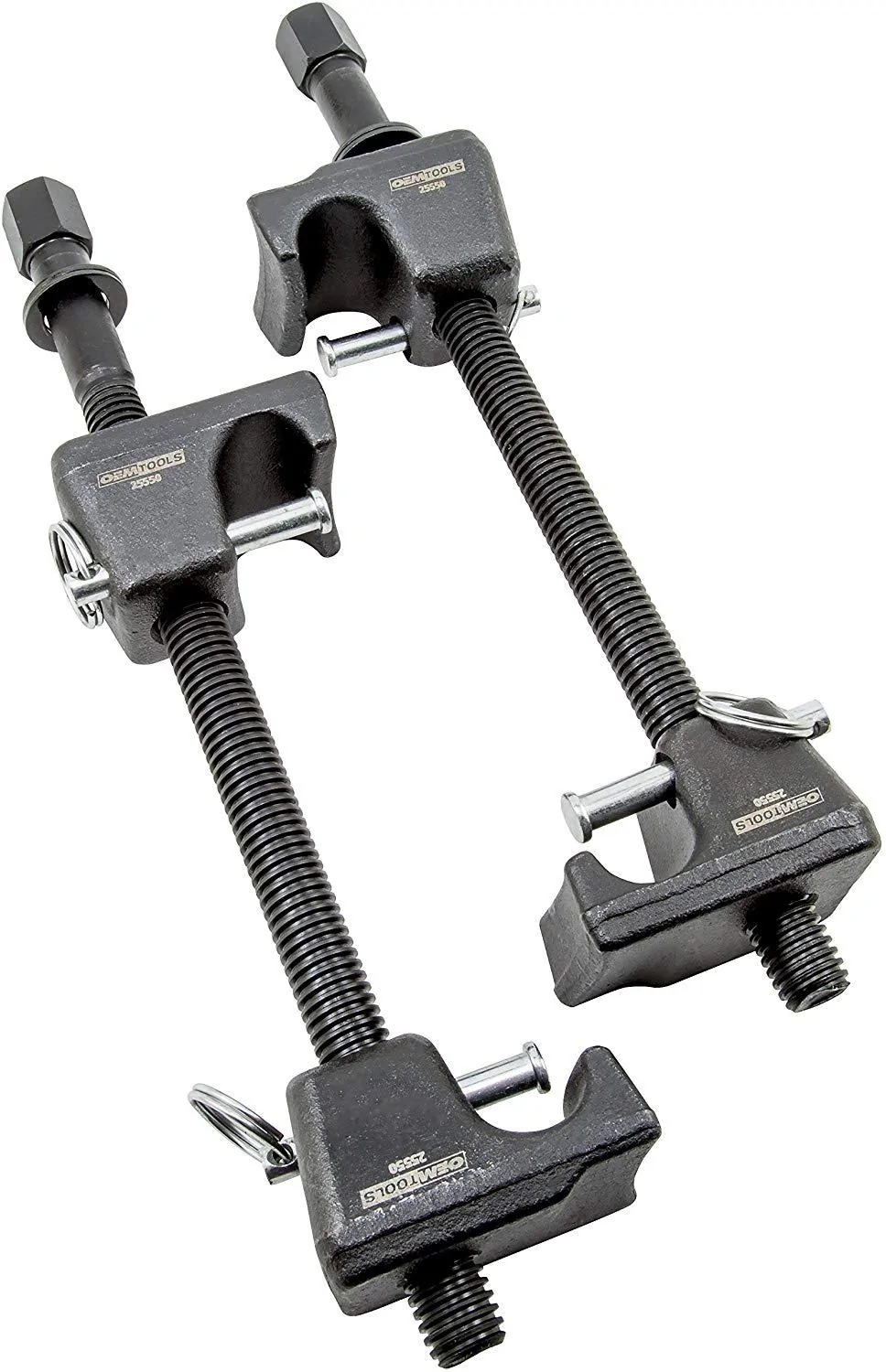

The vid pretty much sums it up. Iimc you will need a spring compressor and chances of the cv boot popping out are very likely, both of mine did but popped back in. Took me about an hour each side

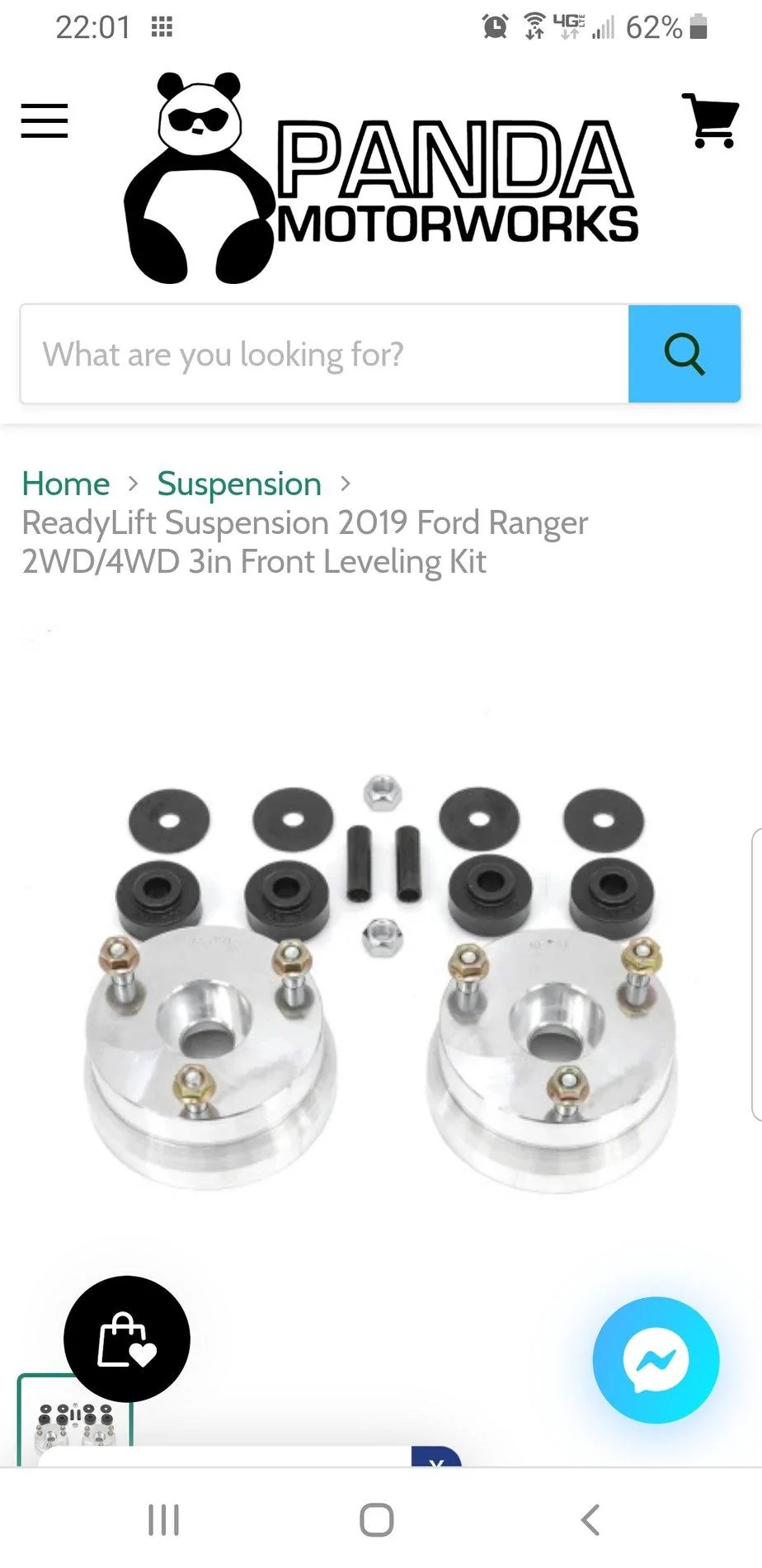

Why is a spring compressor needed. The kit I ordered has a spacer on the top and also a straddle strap that slides over the bottom studs of the shock. Did you pull the rotor abd axle nut? Thats the step I’m trying to determine how necessary it is. Thanks

You dont need a compressor to install the Ready Lift 2 inch kit. It's just a 2 piece spacer kit that goes between the mounting points at the top and bottom of the strut assembly. I think the Stage 3 video is a BDS kit, which involves taking apart the strut to install the kit (hence the need for a spring compressor).

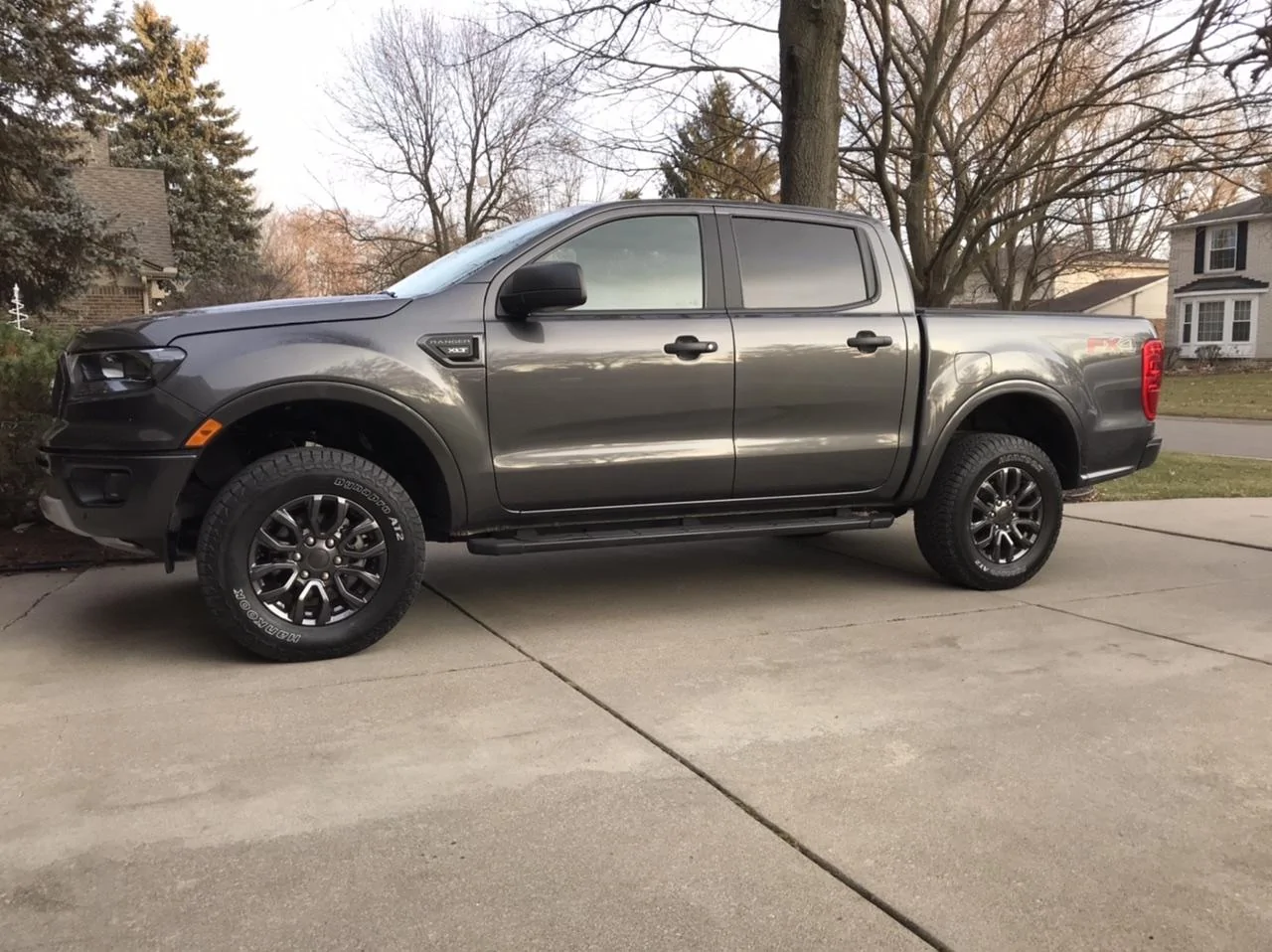

Success! Did my lift this afternoon. Took a bit over 3 hrs. Installation was using the LCA removal process. Did the passenger side first and it took about 2 hrs as I had BIG issues trying to get the LCA back on. After almost giving up I had my son in law help and we used a jack and alot of muscle. The drivers side was really easy and fast - Thankfully.
I’m super happy with the new look and will be getting an alignment on Monday.

Had my alignment done today and no issues getting it within the ReadyLift specs...Here is my comparison of before and after measures - ground to wheel well. Interesting that the 2 inch lift only provided me with a little less than 1.5 inches - more like 1.25. I’m a bit disappointed in that. Wondering what everyone else is seeing.
Front Drivers side
Before - 35.25
After - 36.5
Front Passenger side
Before - 35.5
After - 36.825

I didn’t measure it but I figured about 2”, or a bit less. It still is about an inch higher in the rear but the best I can describe it would be, this is what it should have looked like from the factory. It would probably be better about 1/2” taller but overall I like it. I don’t mind a small rake. The way it was before was just too much rake. It looked funny.

Now that I’ve had the lift on for a week or so I agree that another 1/2 inch to an inch would be perfect. I didnt realize that a 2 inch kit would only net you no more than 1.5 inches - at least that is what the ReadyLift 2 inch did for me.
I would say that a 2.5 inch kit would be perfect IMO but I still like this look much better than the stock jacked up rear look.
I’ll probably at some point - maybe when I need tires - add another 1/2 inch. I saw a 1/4 inch spacer on Ebay and wonder if you could just stack that on the top of the existing one?
