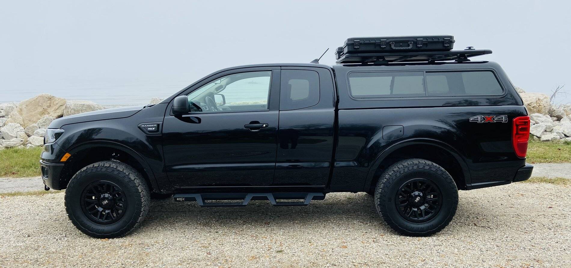

Hi Mathew,
I went from bone stock to 2-1/2” level kit based on what I saw here in the forum. That seems to work for most people looking to level their Ranger and they’re super happy with it. However, I’m not most people and it didn’t work out as well as I had hoped. I have a canopy on my SuperCab and it’s fairly heavy, heavier than a SuperCrew canopy, so my front end was still in the air a bit more than I liked. Not much, but enough.
I recently swapped out my level kit for the Fox Performance 2.0 kit. It comes preset at 2”, which worked out great for me.
I’d say it’s pretty much dead-set level. So, a good rule of thumb might be to go with 2-1/2” if you have no topper and don’t haul or tow. But, go with 2” if you have a topper or haul heavy loads in the back or tow. Make sense?
