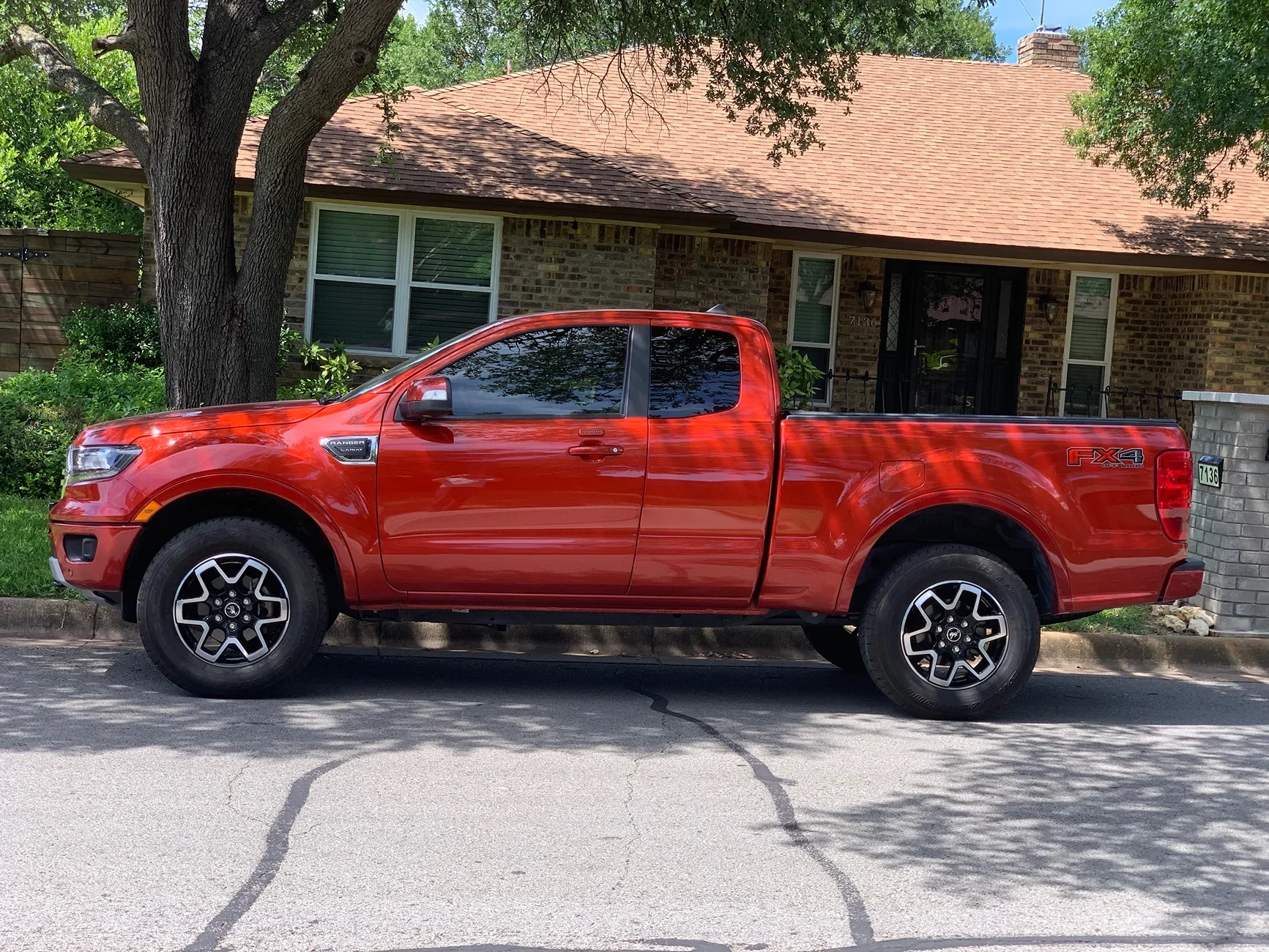

I have the Eibach setup on my truck. I am very happy with the ride. I have 255/70/18 which is the same height and width as the 255/75/17. I have my front coilovers set to about 3/4” of lift. I have plenty of room so you shouldn’t have to worry about the crash bars. I believe David @subquark has those Nokian tires.
