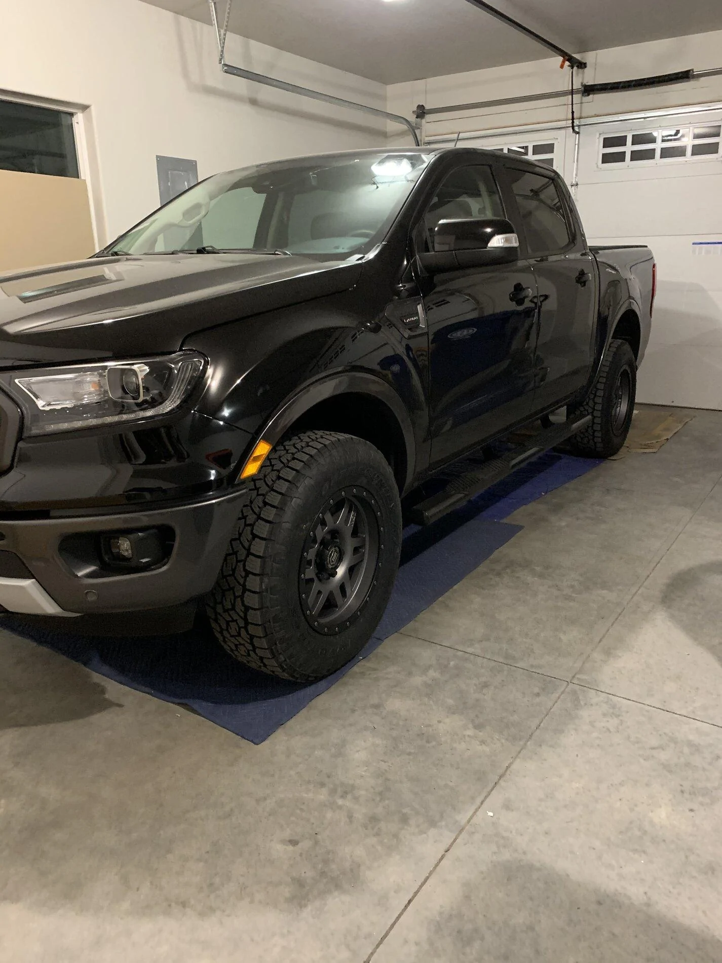

Finally pulled the trigger get wheels and tires. I wasn’t a fan of the sport wheels or the stock bridgestones (255/65/17 at 31.1”)
Tires: toyo at3/65/17 32.1”
Wheels: icon alloys six speed +25 offset
I went with that size tire cause I didn’t want to trim/remove crash bars since I was changing my wheels to a lower offset. If I wasn’t doing anything with wheels I would have done the 265/70/17. I will probably do a level down the road. I have no rubbing on full turn either direction. Plus, wheels fit flush with the fender which I really like.
here’s a pic:

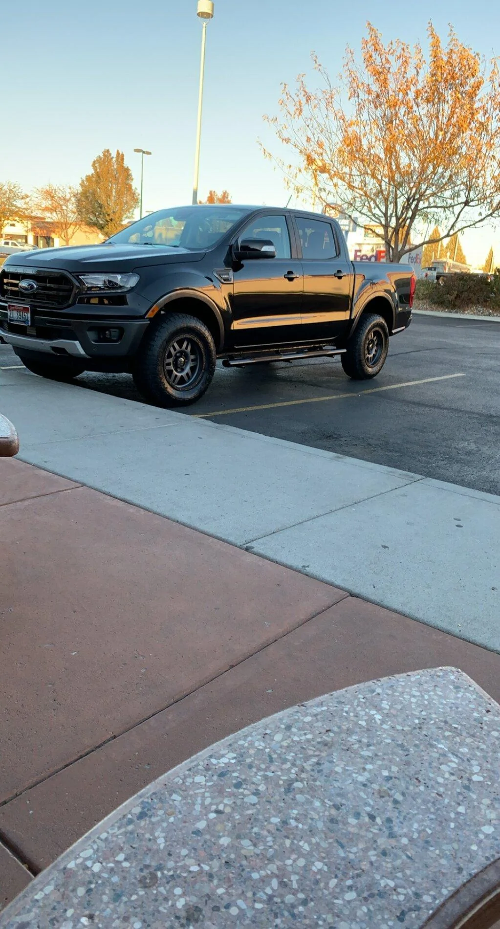

Another picture took the sport badge off finally. Cleaner look I feel like plus added 5 more hp weight reduction.

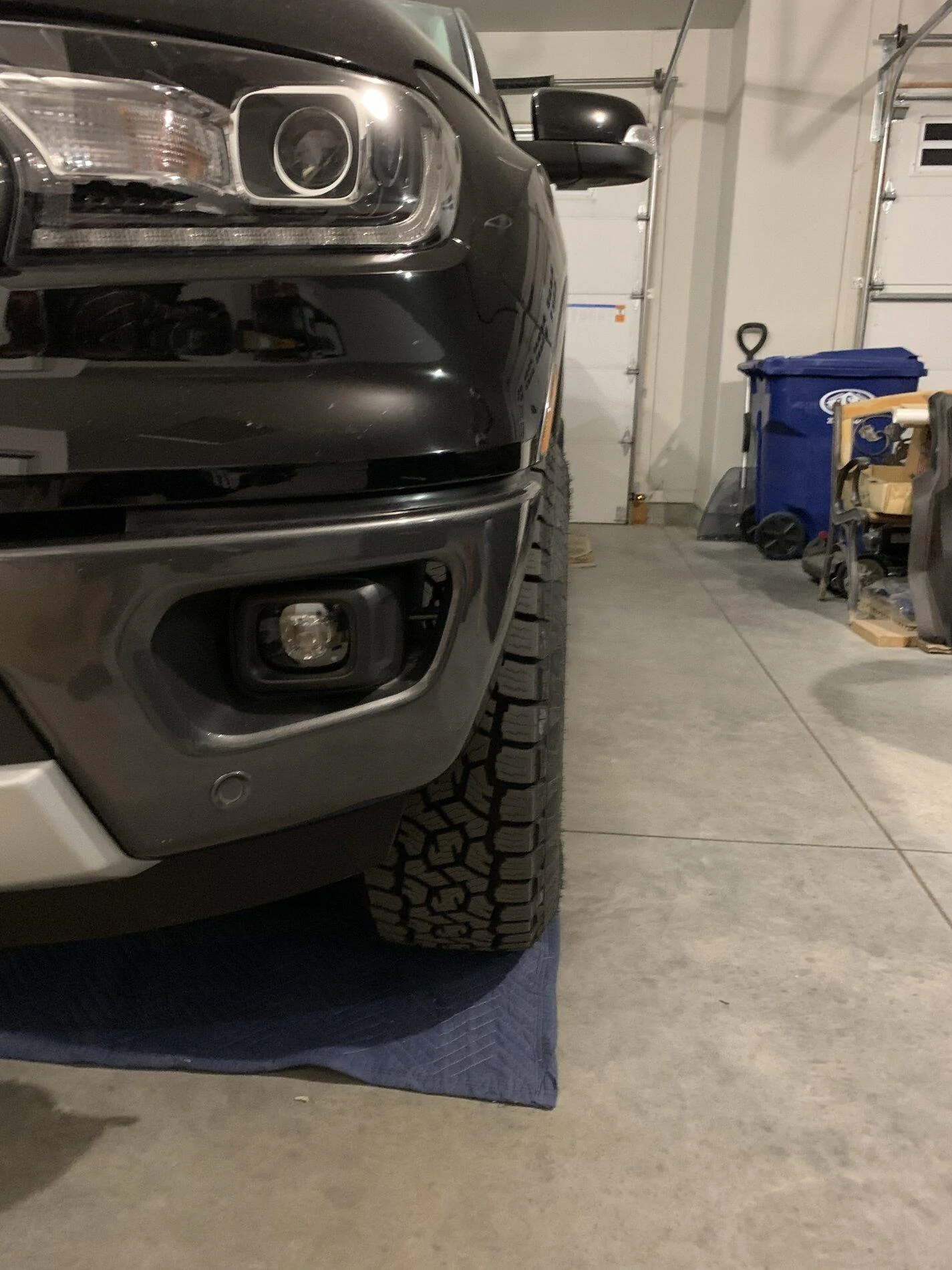

Truck Looks good, what size are they new tires looks like the 2xx got cut off in the initial post , looking at these wheels too so they fit a stock sport 4x4 with no level or trimming required ?

They are 255/70/17 they are 1” bigger than the stock Bridgestones. I have no level, no trimming, thus no rubbing. I did have to take a rubber mallet to the front crash bars and that gave me some more room cause I was rubbing on an incline in reverse. I wanted to do the 265/70/17 everyone else did but I feel if I did that they would have rubbed. I highly doubt you can visually see 0.5in in comparison to 265/70/17.

Hi! Just did the exact same set up on my truck and I was wondering what exactly did you do to avoid the rubbing in reverse? I get just a tiny rub at full lock in reverse. Thank you so much! This thread helped me a lot!

i believe I took a rubber mallet and hit the crash bars forward to make it clear for the front ones.
