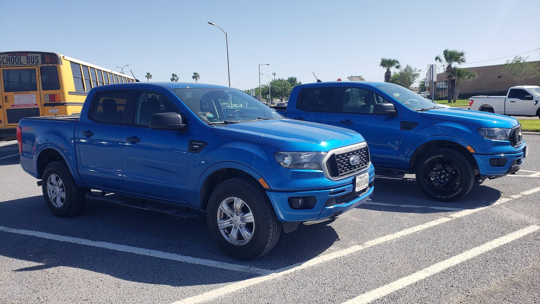

I have 255 75 17 on my 2022 xlt fx2. Absolutely no rub. All stock vehicle.
Except for
The tailgate strut assist.
Tires really make a huge difference. Used forscan to adjust the speedo too. Mine is the ranger with the aluminum rims

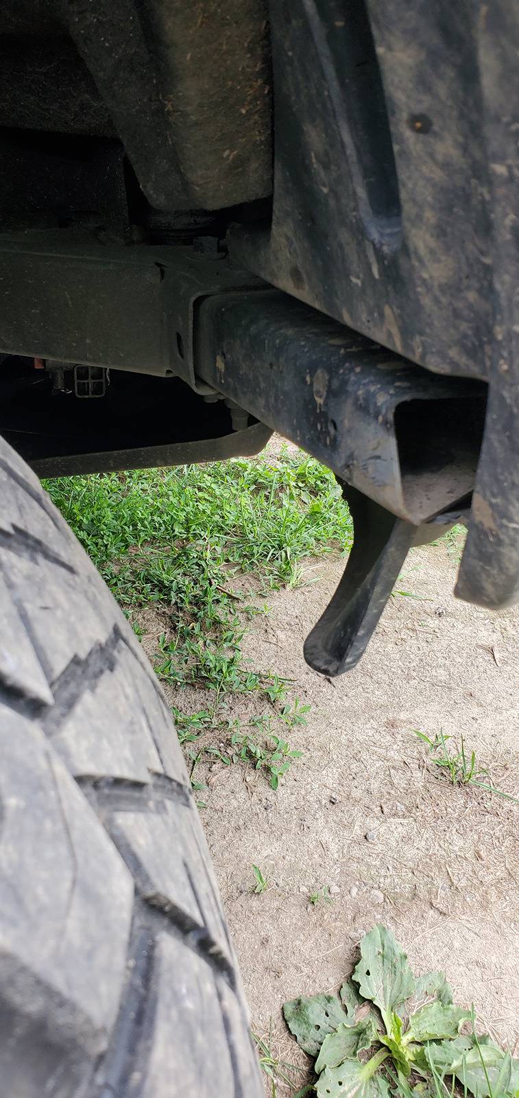

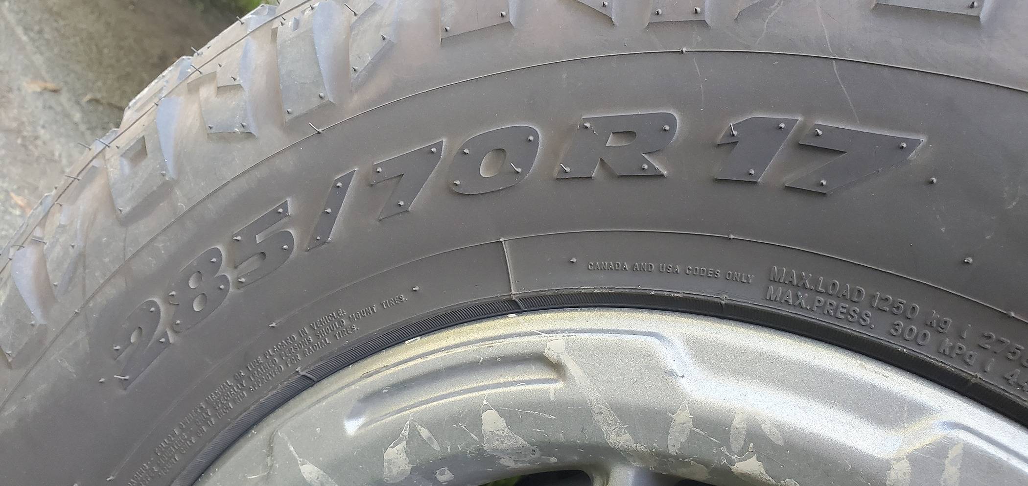

I am running 285/70 3.5" lift and clear with no rubbing, and still have my crash bars too
