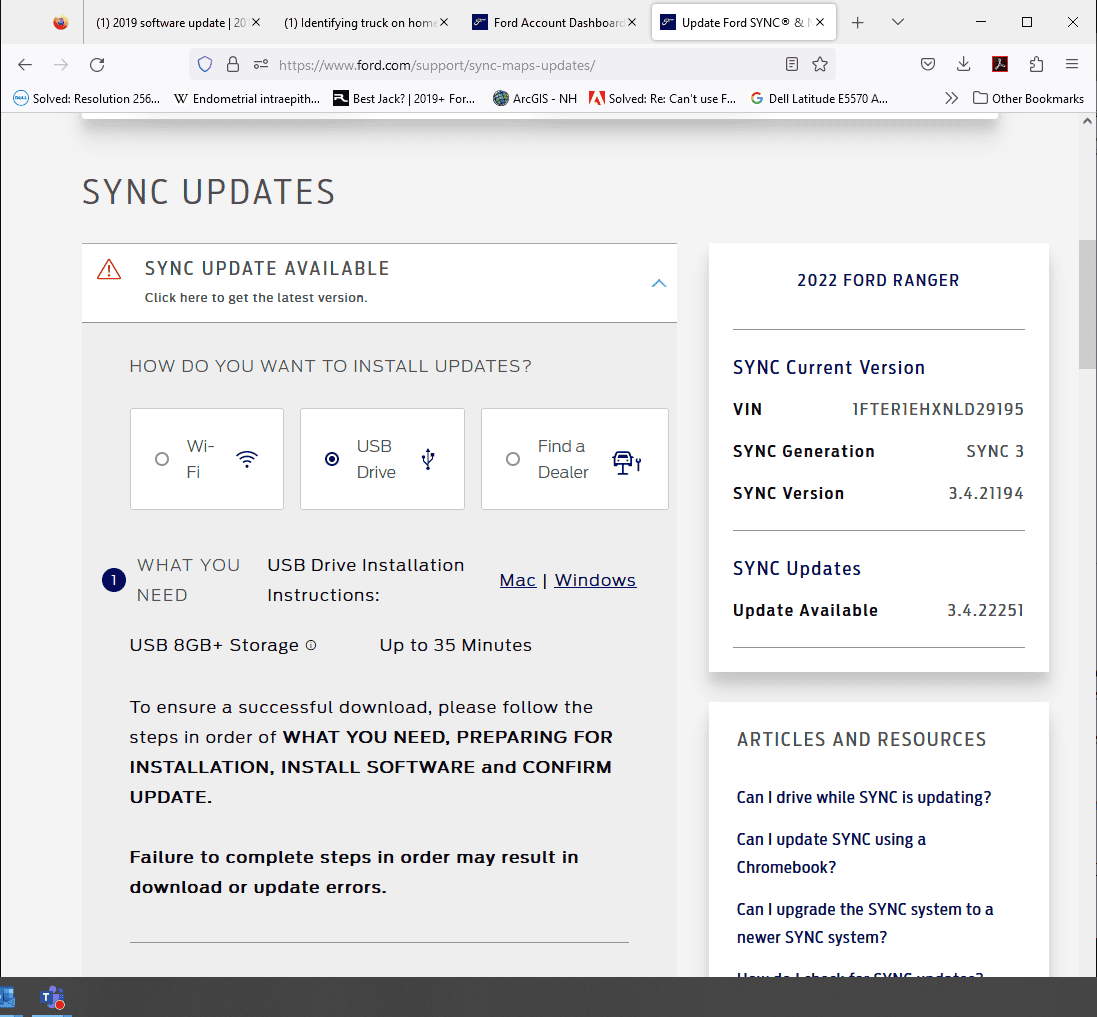

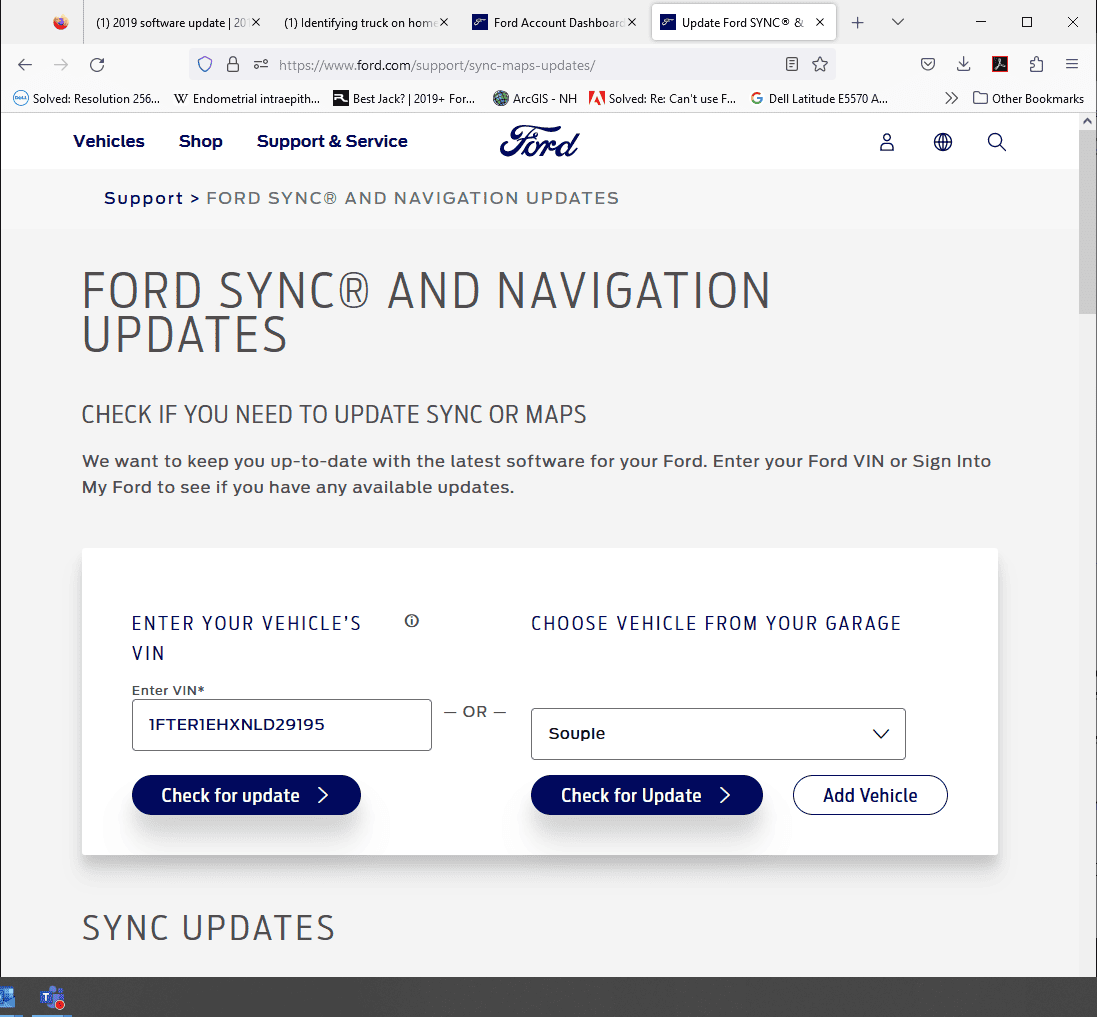

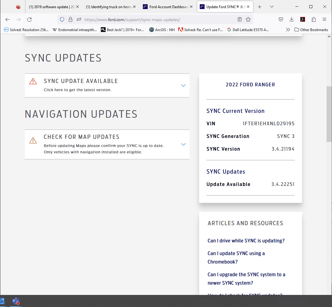

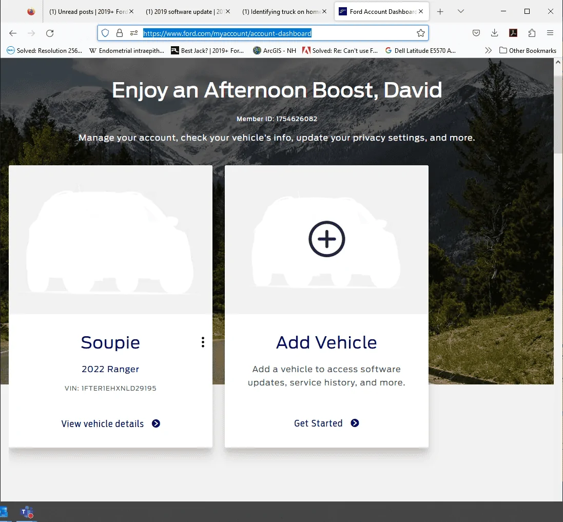

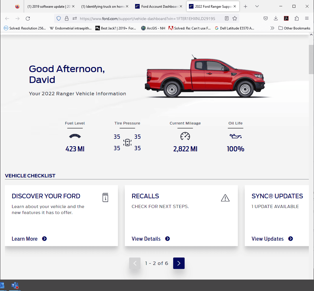

Log into your Ford.com account and get to the dashboard:
https://www.ford.com/myaccount/account-dashboard
then View vehicle details, then View Updates Sync Updates, then Check for update, and select USB Drive
Follow the instructions which has you download a zip file and copy all the files in it to the root of a USB drive.
Go sit in the truck, start the truck, and stick the USB into the truck's USB port under the 12 volt plugs (I have an XL and only have one USB port). Give it a minute to find the USB, then it'll do the update by itself.
I've done it twice so far and each time took about 5 minutes.

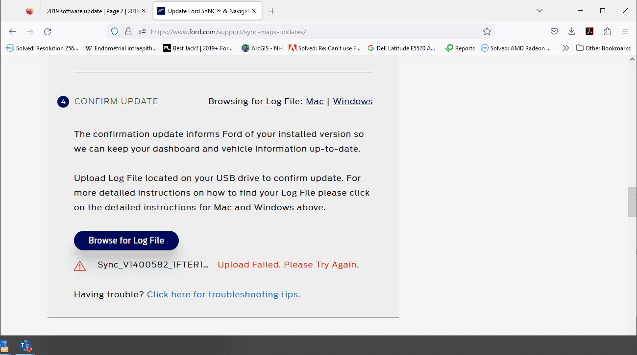

Once it's done, it places a "confirmation" file on your stick and they tell you to go back to your Ford.com account and upload that file. BUT that seems to not work for anyone and some have said that Ford says they will never fix that.'
So I wouldn't even bother to try to upload it. The version is in the info in Sync in the truck, so if anyone wanted to verify it, they can see it in person.

That sounds familiar. It's probably fixed now, but a year or more ago the confirmation file thing didn't work for some reason.
4,572
23,285
Still no love on the confirmation file upload, just tried this minute:
