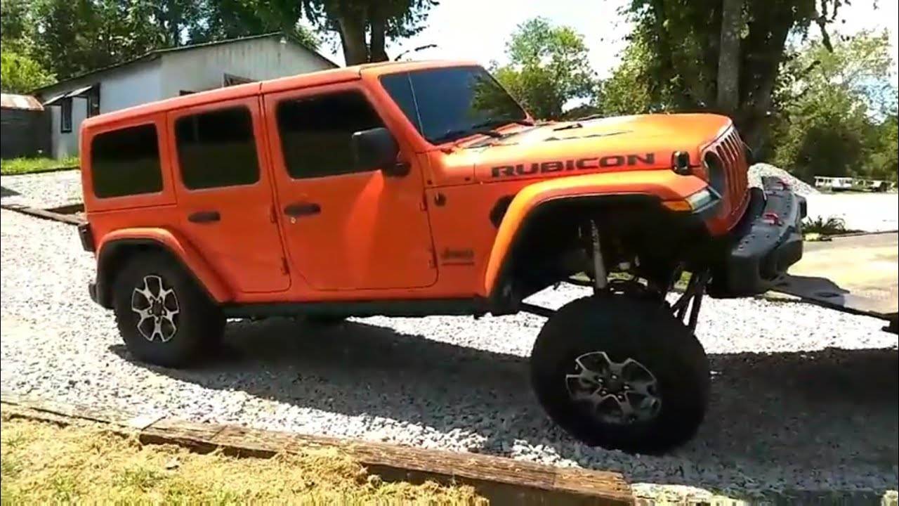

Why is a solid front axle so important? I thought independent would give you more mobility? Not an off-roader so haven't really looked into the why's of this stuff, however awesome job.
IFS rides and handles better but it can't do this:
What others have said, but I'll put it a little more simply and watered down: it allows you to have maximum contact with the ground.
With an IFS, you get the tendency to lift a wheel, and once that wheel is off the ground it can't provide drive to the ground.

Unless it's a beams ifs ?
I-Beam can articulate more than regular IFS, but it won't do as well rock crawling as a solid front axle. The benefit of the solid axle is that as one wheel enters a hole or goes over an obstacle, the other is forced in the opposite direction causing more flex.
