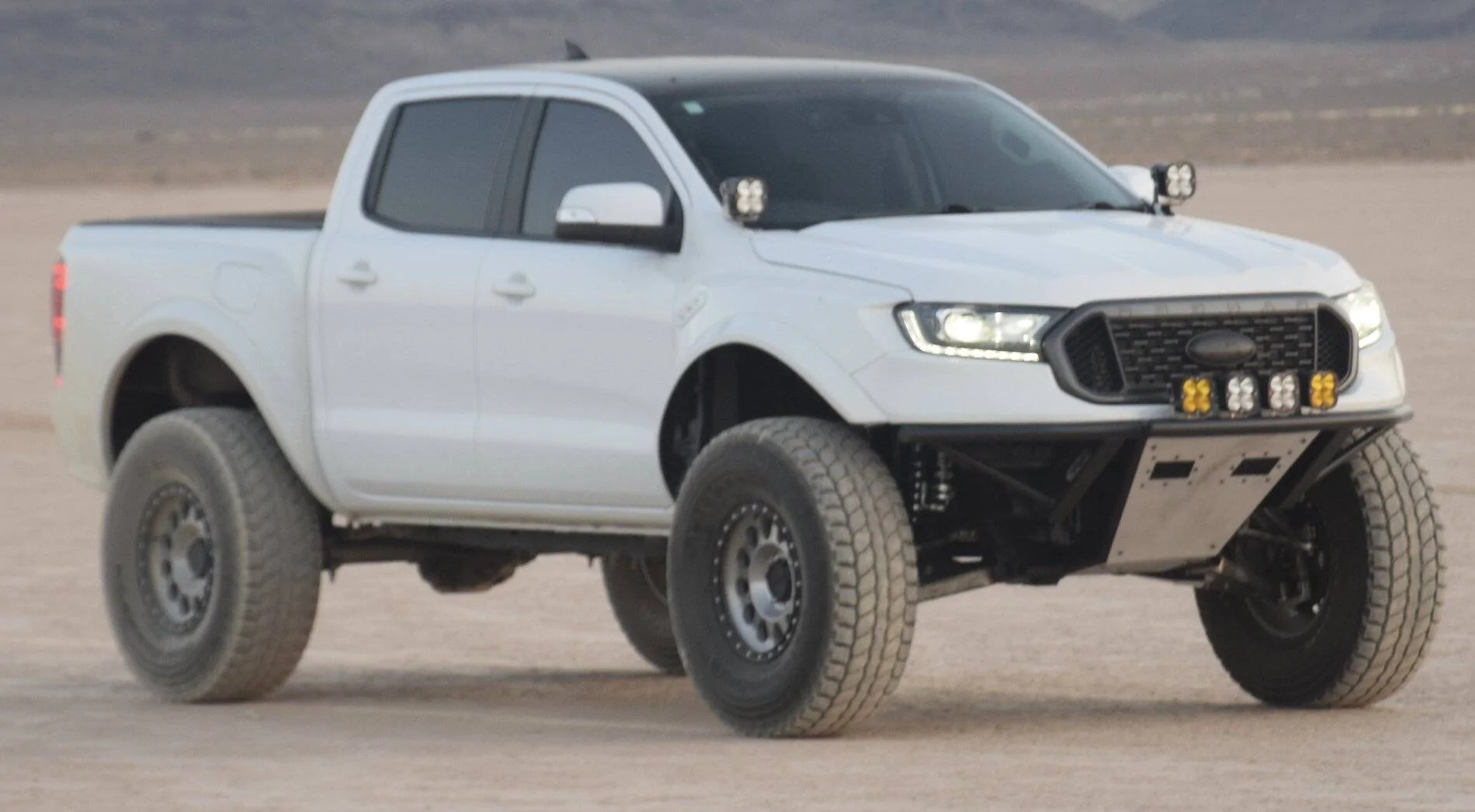

Build is done, except secondaries! If you have any questions ask away. Notable upgrades/ most asked about: Custom mid travel kit, f-150 rear end, 37" big projects
