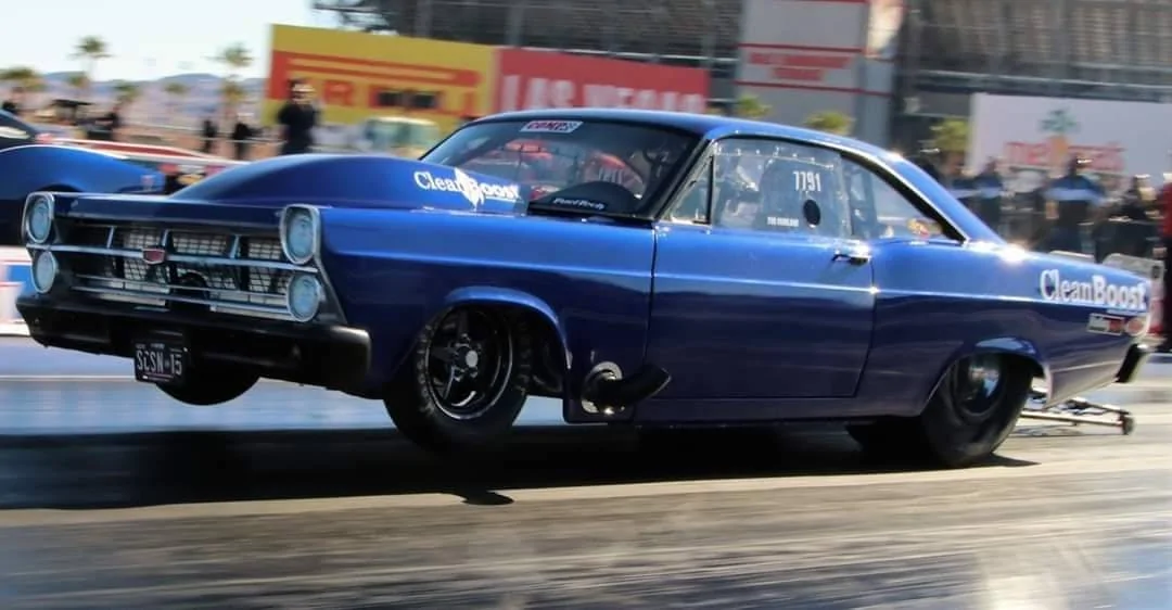

This thing is going to be a beast. Can't wait to see it completed. Your work looks amazing. Good luck. Oh wouldn't mind some fairlane pics too haha. I had a 63 500 sports coupe as my first car. Man I wished I still had it.
Thanks!
Here is the fairlane

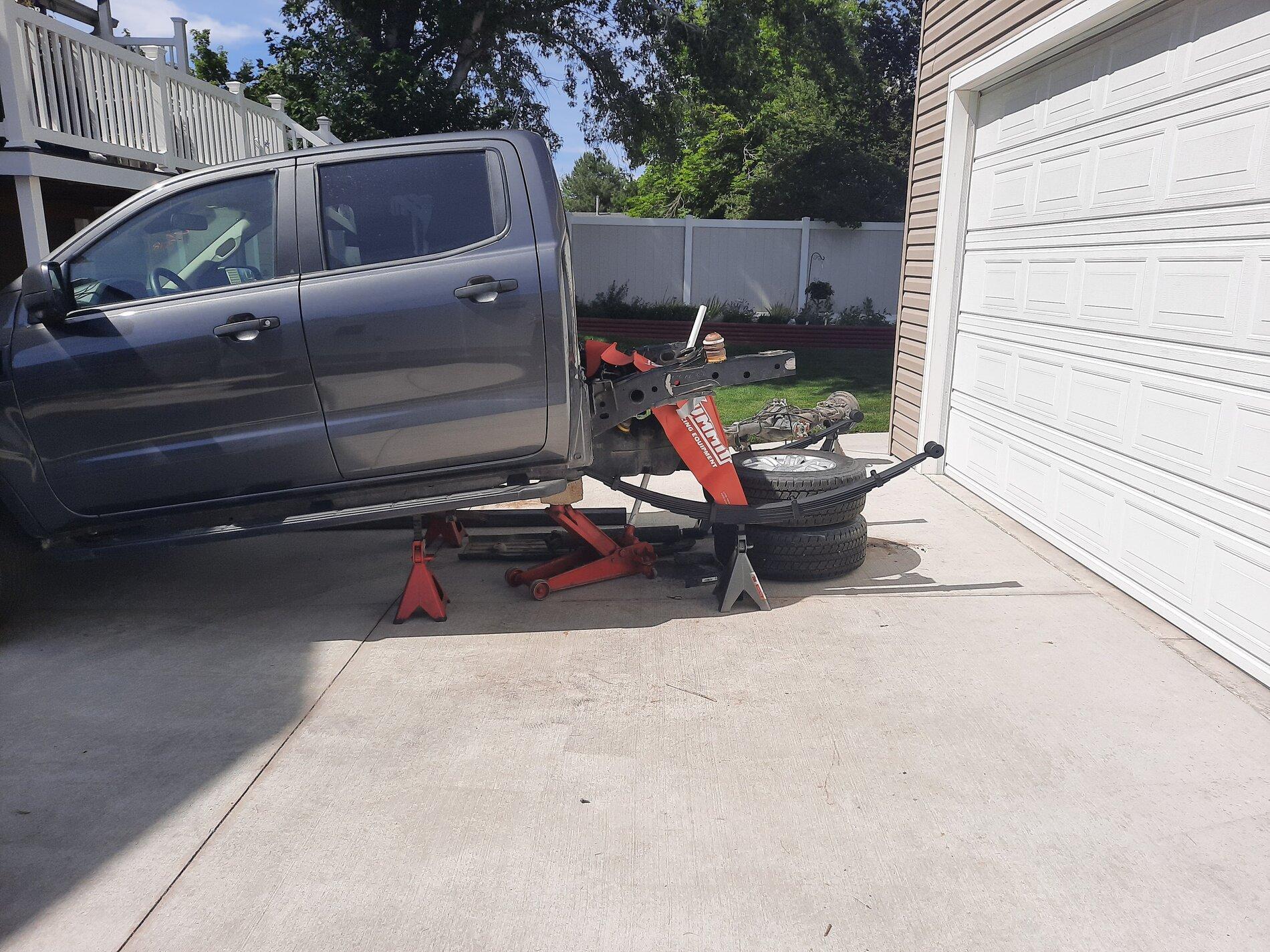

Finally making some headway on the power steering for the Ranger. After several failed attempts at power steering solutions, I have finally come up with a viable option. Super powerful electric motor running a PSC power steering pump in to the Toyota IFS box assisted by a 6 5" stroke hydro assist ram. The electric motor is fully speed controlled by a speed controller from Midwest motion products. I will be able to speed up and slow down the ps pump depending on the type of driving in doing. Getting close to a maiden voyage!
