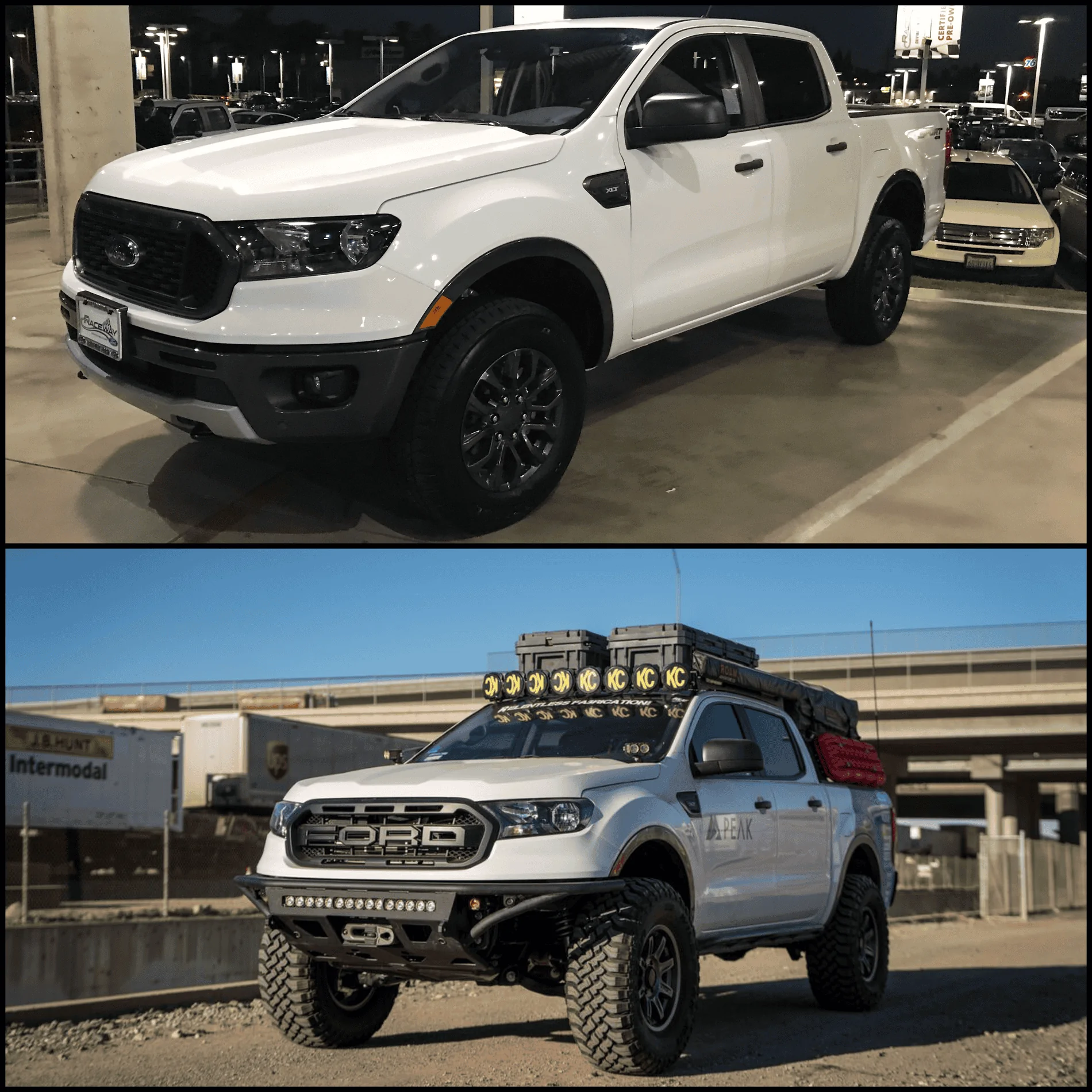

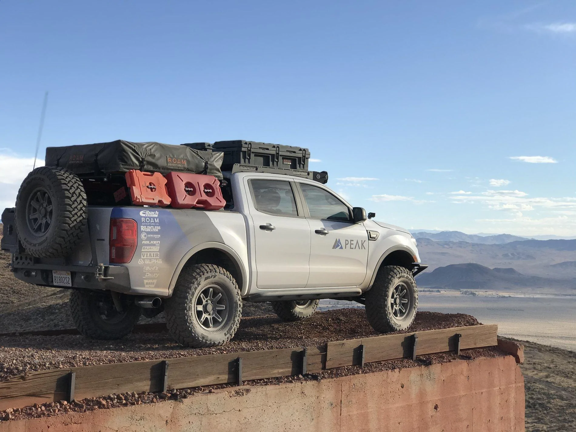

Hey guys! I never post here and my buddy Rory reminded me that this forum exists lol. I figured a lot of you may get a kick out of the truck I did.
Started with a 2019 Ford Ranger XLT with tech package and e-locker in Feb, and by April it was built for Overland Expo West and just recently finished some more updates and installed 35s.
Loving the truck so far, happy to see everyone else's builds.
