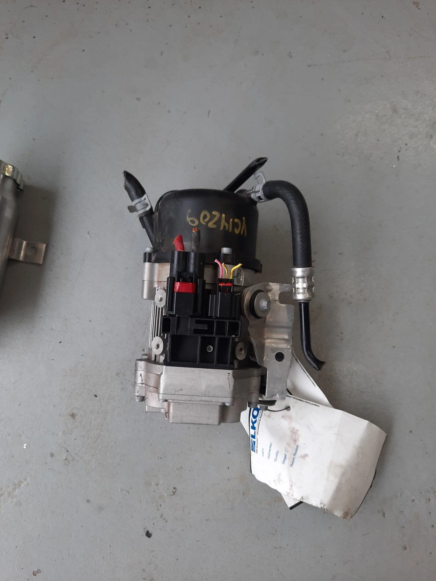

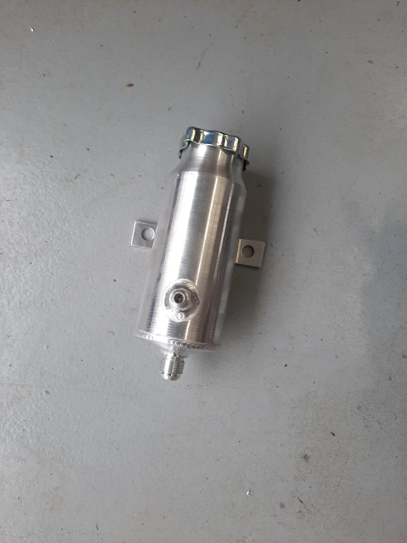

Since the Ranger uses an electronic rack and pinion and does not actually have a hydraulic power steering system, I have to add a pump. I've played with the idea from the beginning of finding a way to run a power steering pump on the existing belt and pulley system, but haven't really figured a great way to do it. I also didn't want to have a belt alignment issue to deal with, so I bought a used electronic power steering pump from a wrecked 2019+ wrangler or gladiator. The plan is to use this pump to run the gear box and the hydro assist ram. I truly don't know if it's going to have enough volume/pressure to do it, but we will find out. The pump will need a power, ground, and vehicle speed signal, and keyed power to work. It reduces pressure at higher speed to firm up the steering. I sure hope it all works like it is in my head lol

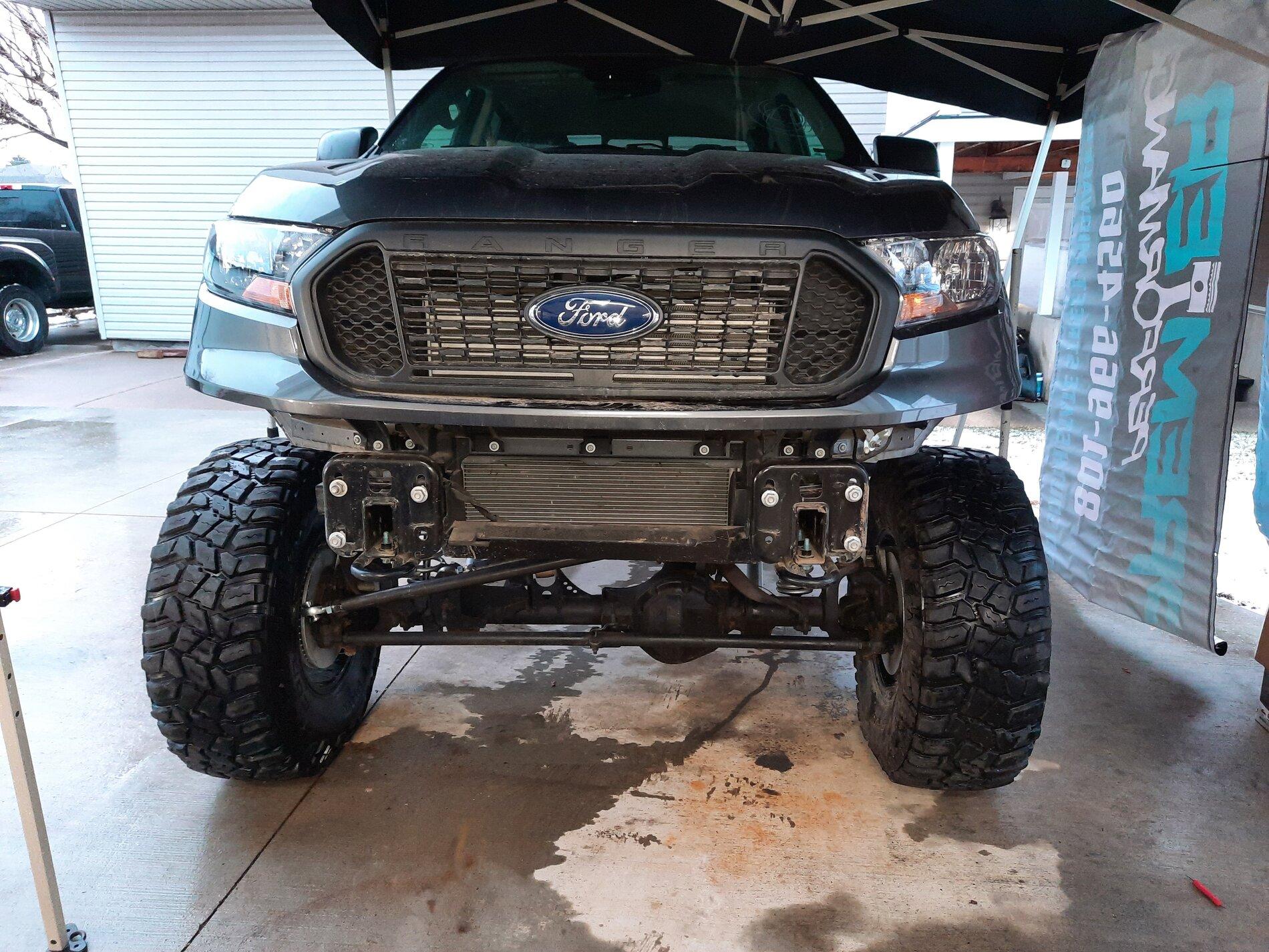

Got the truck on the ground today. First time on its own full weight since I bought it. Need to do some more mods on the steering, but it's getting close.
I took today off to get some work done on the truck and it snowed so day, so I made an improvised shelter.

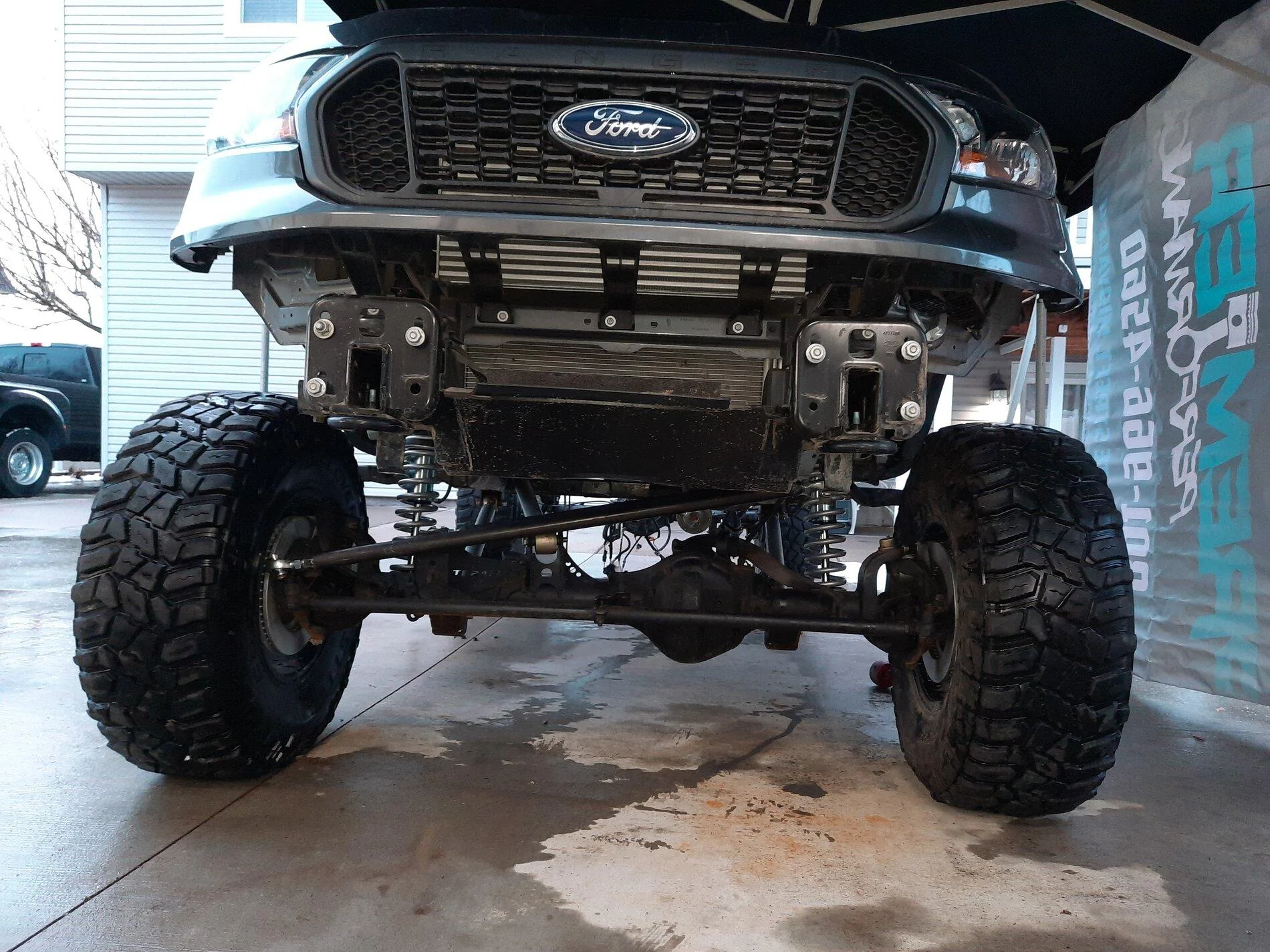

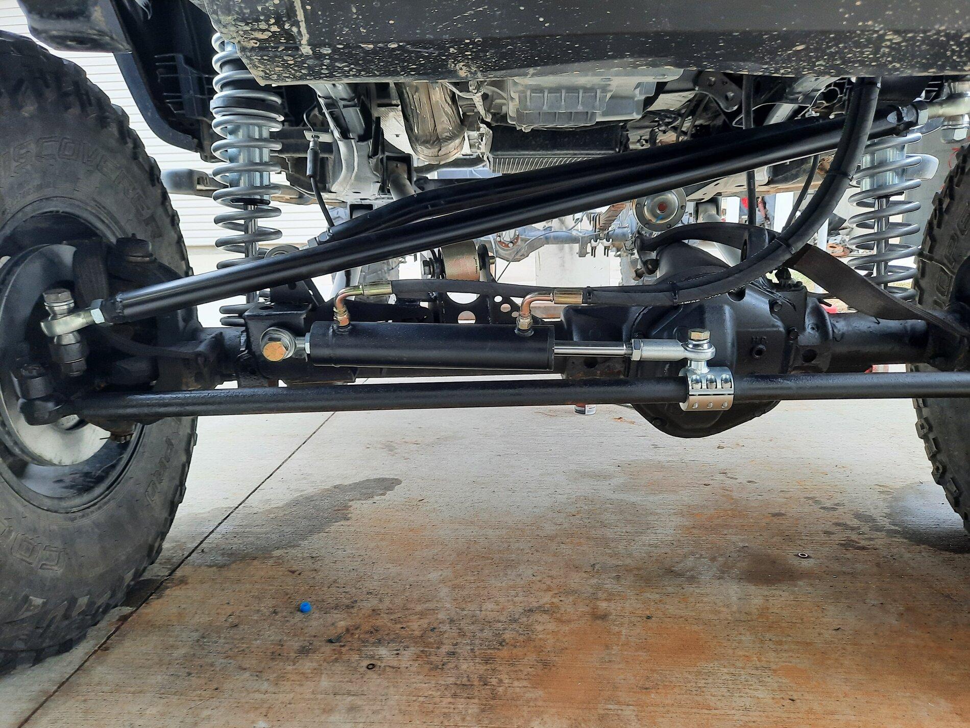

Hydro assist is fully mounted and plumbed. Track bar, drag link and all mounts are final welded and painted

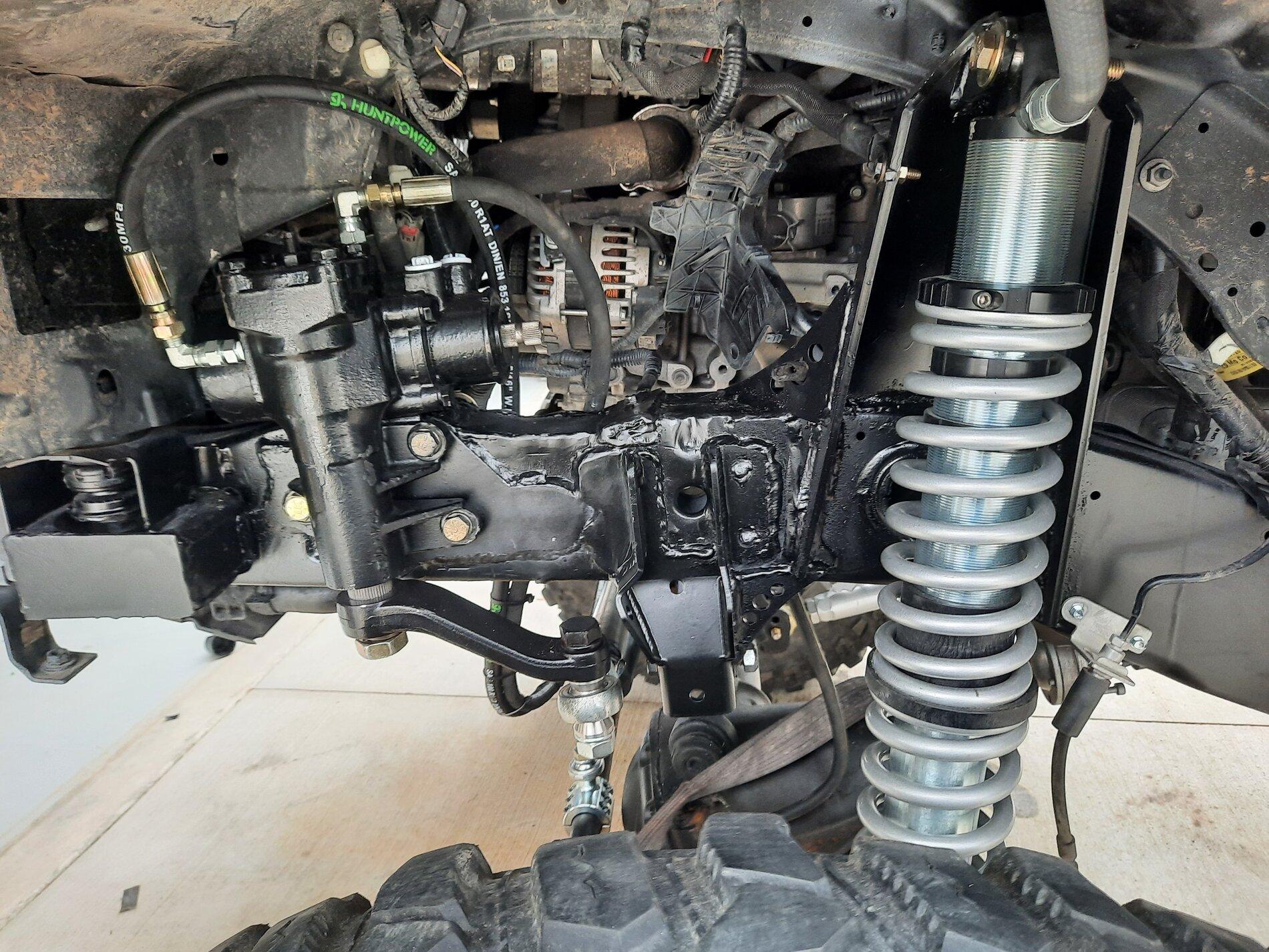

Power steering gear box is permanently mounted and the frame is reinforced using trail gears ifs box mounting kit.

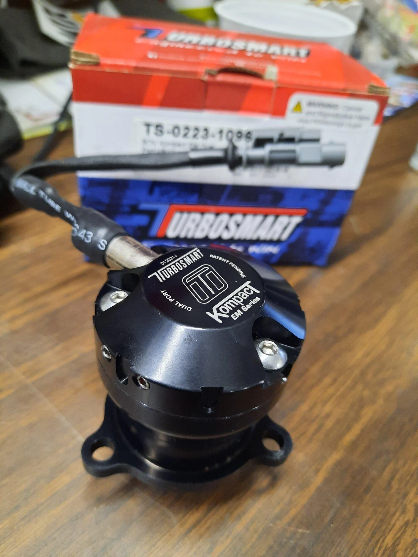

I need to do a huge shoutout to Stage 3 motorsports. Bought a few parts from them and they had amazing customer service, everything arrived quickly and was exactly what I ordered. This stuff should add a bit of power and sound. And the diff cover just looks badass!

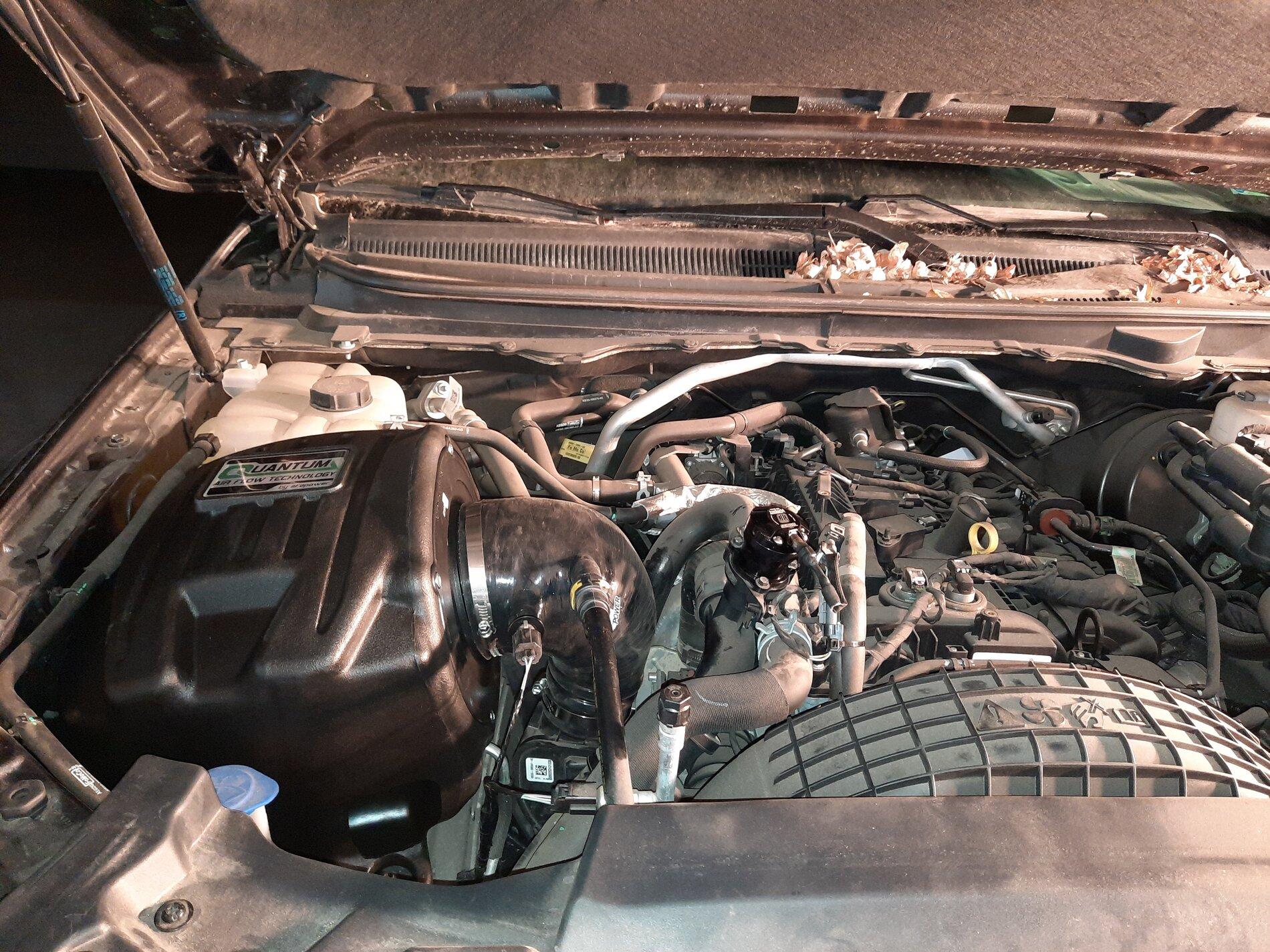

I was able to install the intake and BOV tonight. I was really impressed with how well the AFE intake fit. Easy install.
