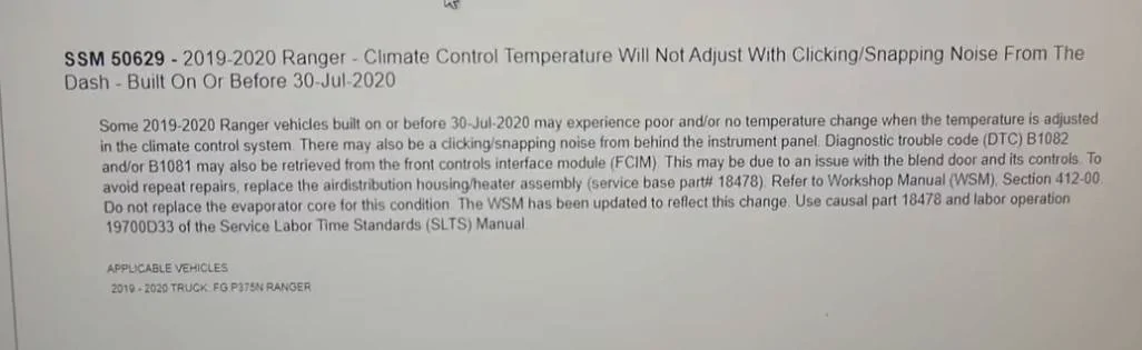

All, my beautiful truck began blowing nothing but heat, no matter how I adjusted it on the driver's side. I tried everything to no avail. I searched the internet and sure enough others were having this same issue and it was just not the Ranger but nearly every modern car made in the last five years (apparently many makes and models all use this same assembly). The issue turned out to be the Housing/Heater Assembly. This is not a repair for the faint of heart as to replace assembly which is under the dash and connected to the core in the engine compartment. I had to leave my Ranger with the dealer for over a week despite the job being labeled 4.4 billable hours. My warranty was expired but fortunately my extended warranty covered the repair. I was told that it would have cost between $1400-$1700 and I am guessing by how long it took them I would have had the higher charge.

Auto climate control and manual control HVAC are both equally susceptible...my '19 Scab was manual
It's not motors or electrical persay....the HVAC box that contains the blower motor and has the blend doors on its sides becomes warped due to a manufacturing issue and usually renders the blend doors inoperative....either stuck open or closed....(the snapping and popping sounds) and also results in either getting only cool air and no heat or vice versa
