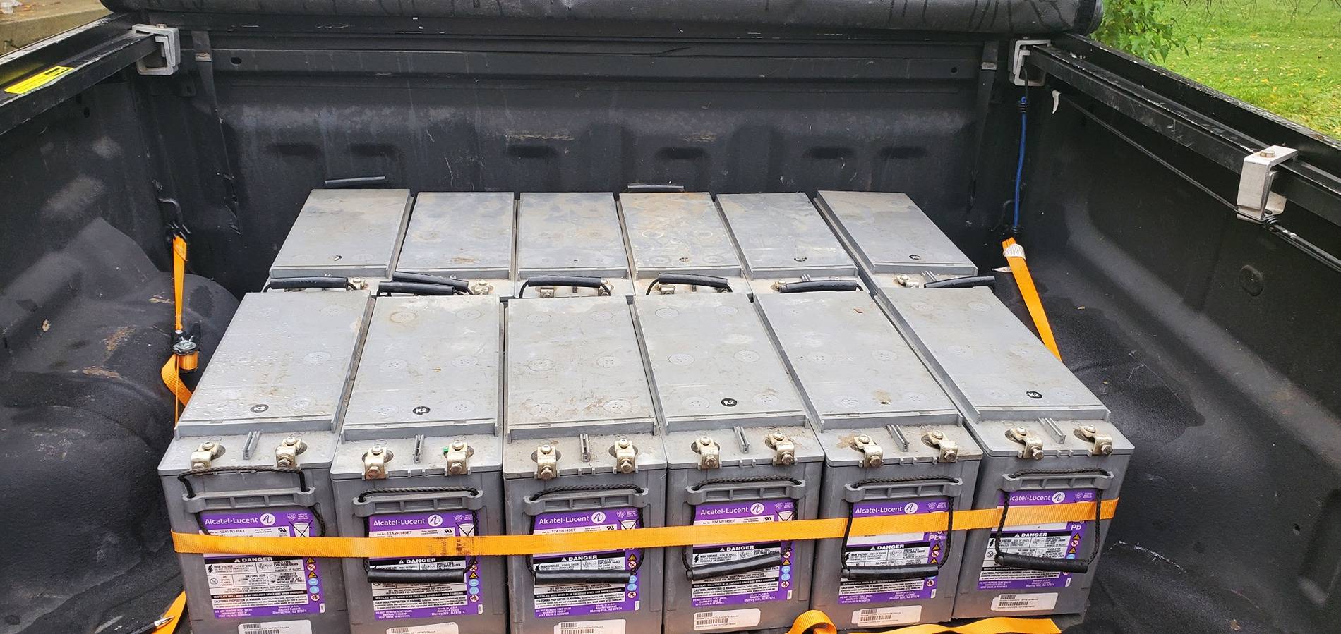

I have a Rough Country lift I have never gotten it to squat, the first time I didnt even realize how much I had in it till I got to the yard and had 1270lbs of rollers steel, 6 lug has to be good to 1/2 ton right?
The next time picking up 14 Telco AGM batteries (the big ones used in Cell Towers) they are 110 lbs each and I had 14, so 3/4 ton, and got 17.7 mpg doing it, few 100 miles and it handled and rode like a dream. (zero squat) the guys loading them were laughing and really didnt want to, (until I was loaded) they said they had to make 3 trips in a tundra, LOL I said this aint your grandpa's toyota!
I beat the shit out of all my trucks so its got a 50/50 its either gonna work for me or I will buy a truck that does!
the two other batteries are up against the tailgate....
