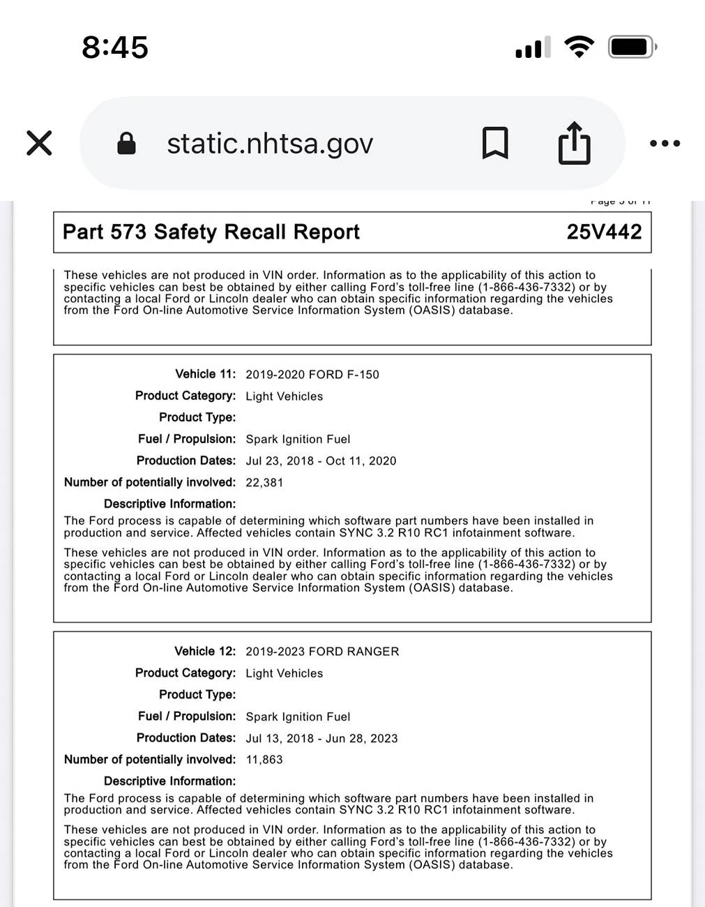

If the issue is tied to the SYNC version 3.2 R10 RC1 will updating SYNC 3 solve it without a trip to the dealer?
Stevedbvik1
Oct 4, 2021
2,851
8,639
2022 Ranger Tremor XLT
I’d only worry about it if you get the recall notice seeing only about 3% of Rangers are affected.

They finally revised the recall letter and gave some direction (Some?)
1. They are updating it to 23188, which most of us have already C/W.
2. There is a step in the procedure - where they (Clear User Data) before they perform the update.
Which from various previous issues with updating by owners, created a choke point as it was full and would not fully complete.
I know my scan tools have this option (Clear User Data) along with the APIM Reset option.
so just wanted to point out that FDRS is not required and can be performed with other scan tools that have it.
The (Some?) Direction - Refers to the point that if you already have 23188.
1, Are you included in this recall?
2. How important (Recall Wise) is the step to Clear User Data?
As those who have updated to 23188 (At Home) did not C/W this step.
So if this step is (IMPORTANT) then we will all be included, if not then those that Ford servers show you have already updated to 23188 - will not receive a recall notice.
So the recall still leaves a grey area for understanding of clarity.
I think the main goal (reason) for the recall is to get all vehicles affected to version 23188, as all prior versions had various issues.
