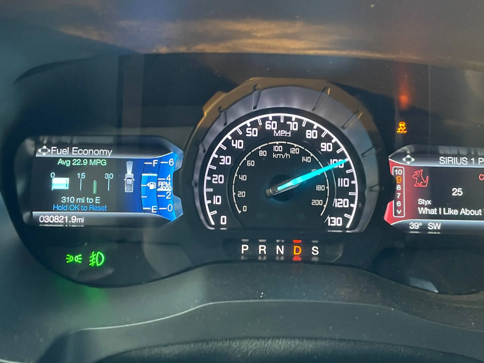

I did 110mph and never even hit 10th gear!!!
Wth
It won't hit 10th at that speed, 10th is like an overdrive gear. Mine was in 9th too and I was cruising 2-3 miles on a flat highway.

It won't hit 10th at that speed, 10th is like an overdrive gear. Mine was in 9th too and I was cruising of 2-3 miles on a flat highway.
If I'm not mistaken, 7 is a 1-1 drive and 8-10 are all overdrive gears.....
