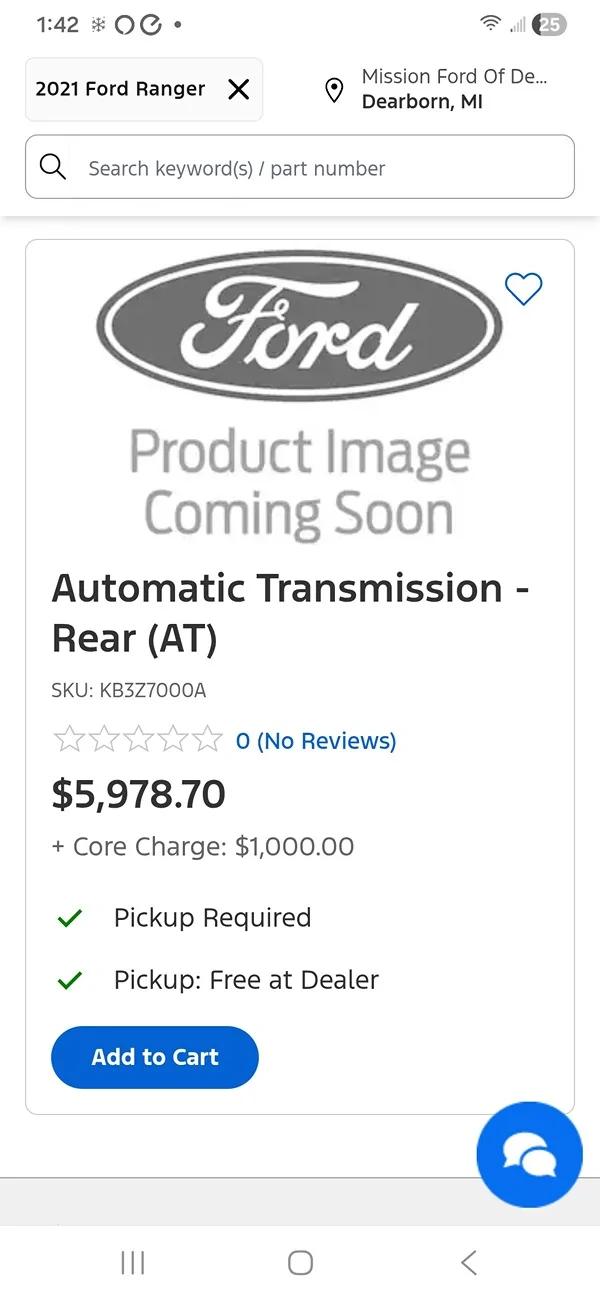

I called another dealer.
My 2021 part# 2wd ranger- kb3z-7000-A
LKQ part# 2wd Ranger - NB3Z-7000-A

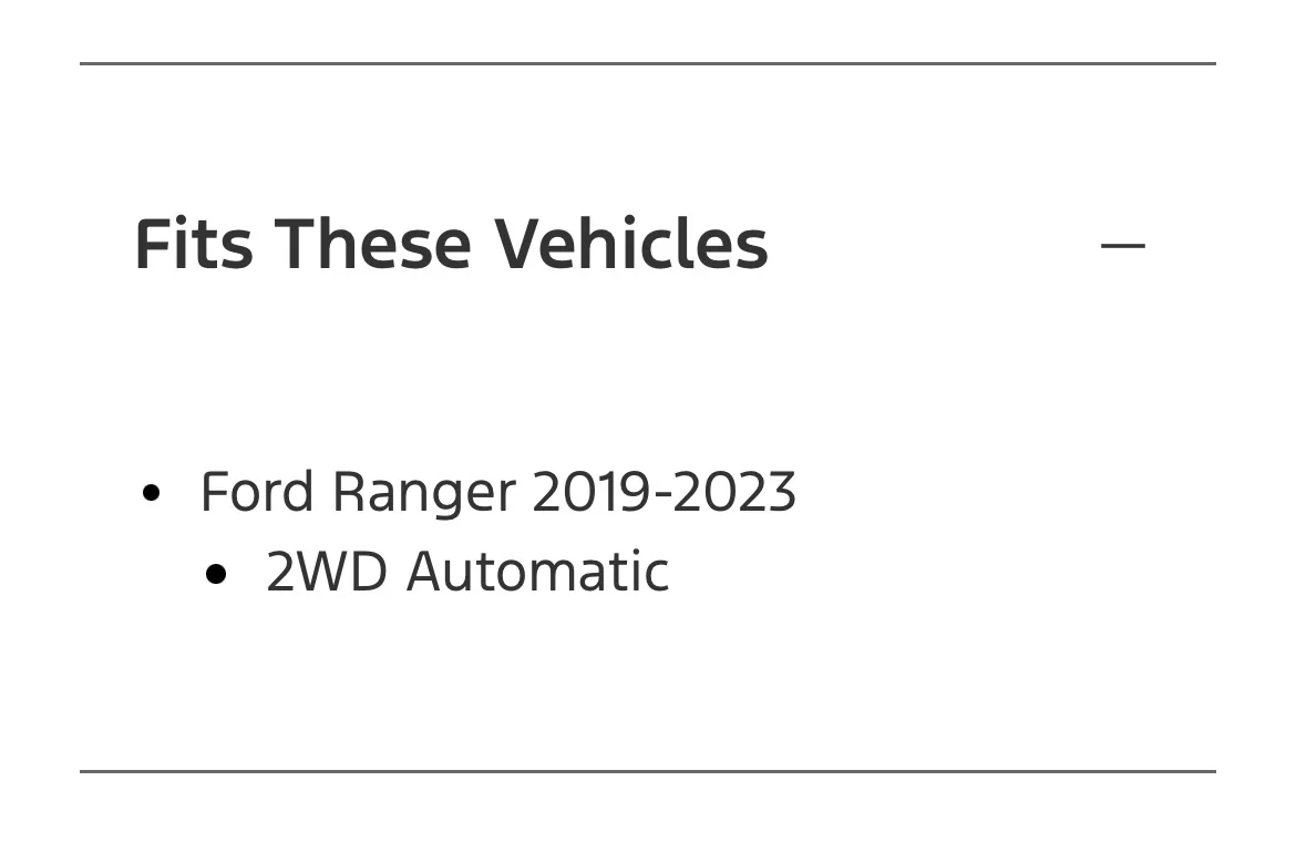

Well I found one on ebay from a 2023 with 19k $2750 shipped. So I'm definitely in the clear with it being the updated one. The ad also lists it as working on a 2019-2023 so the shop can't say anything. This is a pretty small shop and he is a great guy. I've seen him replace engines and transmissions many times during the week. I just hope he has the capability to program the trans to my computer.

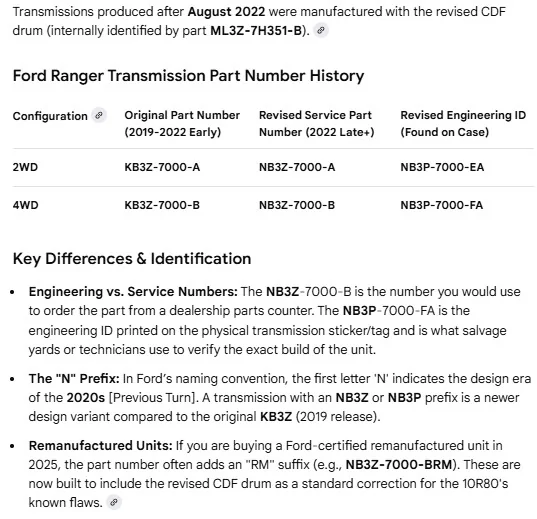

Since I went through this (as a curiosity) and actually had a difficult time finding this specific information when I first took delivery (Verify the Part Number I have was truly the Revised Number) but 3 Years later - Its easily found and VERIFED.
Note: I have a 2022 4WD and a Build Date of Aug 16th, 2022, the exact date of the (TSB) decision of troubleshooting path. So, I have the REVISED Transmission and the First Day of production with the new revised part number.
My 4WD Transmission has the Engineering Part Number on the Tag NB3P-7000-FA- and a (Transmission Assembly Date) of July 25, 2022.
So, I LUCKED out and got the revised transmission - First Day Of (New) Production.
This what I was trying to tell the LQK rep, he just was not wanting to hear it. While I am happy i got a newer 2023 with less miles transmission, it would have been much easier to just get it through LKQ. My shop deals with them daily and it comes with a 6month parts and labor warranty. The 2023 from ebay I get 30days.
