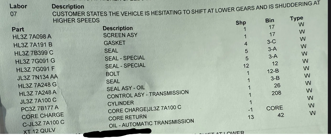

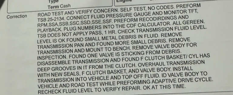

Got my ranger back today. First thing I noticed was I need new brakes asap when I compared it to the bronco sport they gave me. Second thing was it is shifting smoother. Overall, I'm happy that something has been done, but not thrilled the CDF drum was not replaced. I've talked to three different independent mechanics now familiar with the 10r80 and they all said the CDF drum should have been replaced since it was already open.
But - its not hanging, the downshifts are done extremely fast (I've never seen it downshift when I apply throttle immediately), and the upshifts are smoother. They instructed me to drive it like I normally do and let me know the learning period was 500-1000 miles. Without the newly designed CDF drum being put in, I have a feeling that it will get worse over time, but I hope I am wrong.
I have attached the summary of the fix and the parts they ordered. They found what I assume is more metal than normal in the transmission.
I have attached the summary of the fix and the parts they ordered. They found what I assume is more metal than normal in the transmission, and they did not replace the filter, not sure how I feel about that - may be one of those situations where they cleaned the filter?
First item on your parts list is the filter

I just got mine back from the shop this week. Starting having hard shifts that were getting progressively worse while I waited for my appointment. The dealer tested and found the F clutches burnt, planetary container worn, and CDF hub center bushing out of place. Luckily, it came in with 53k miles, so just within factory warranty.
What's sad is that I thought having the same transmission as the F-150 was a selling point - figuring it was proven and overbuilt. I was wrong there!
Interestingly, I had the Ford Performance tune and that interfered with their repair so it had to be wiped out and I will need to reinstall.

I can’t lie and say there isn’t a significant improvement - because there is, there is not a constant clunk when shifting from gears 3-7 or 5-7 like there used to be every time I turned from the street I live on to the highway/country road. I have had some rough shifts no doubt but not to the level I was having. I have had a few shifts were I was lurched forward a bit, but that is probably the worst I’ve had since the fix. It downshifts a lot better/faster now, that’s the biggest thing I’ve noticed. Now it’s nowhere near perfect, if I compare it to a transmission from Kia or Toyota or even the one in the bronco sport I got as a loaner, you can tell it’s not right. Bottom line - I’m glad as it’s better than it has been since the first 1000 miles but I have a feeling this will be a cycle. I am hoping ford does do a recall so I don’t have to buy the extended warranty.

Well, not to be Debbie downer, but this past week I noticed the clunking is back from 3-5 possibly 3-7. Very disappointed as I’ve only put around 2k miles since the repair. I really noticed it today when turning onto the highway ramp and turning onto the street from my driveway. Was hoping it was a one off but every day I’ve driven this week it happens. Not sure what I’m gonna do now, will be moving with in 40 days so I don’t have time to take it to the dealer. May end up paying it off and selling it to Carvana and getting something else once I move. I do not want to give ford more money for an extended warranty or deal with a repair that doesn’t replace the CDF drum.
