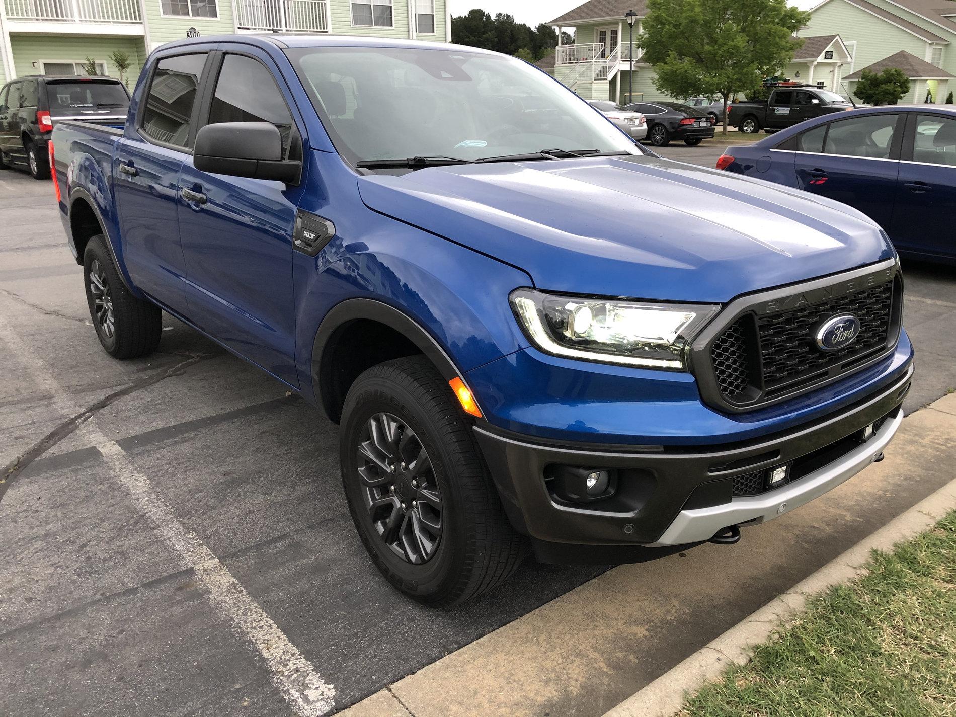

so glad I did the changes. I like the look and function better than the low beams.

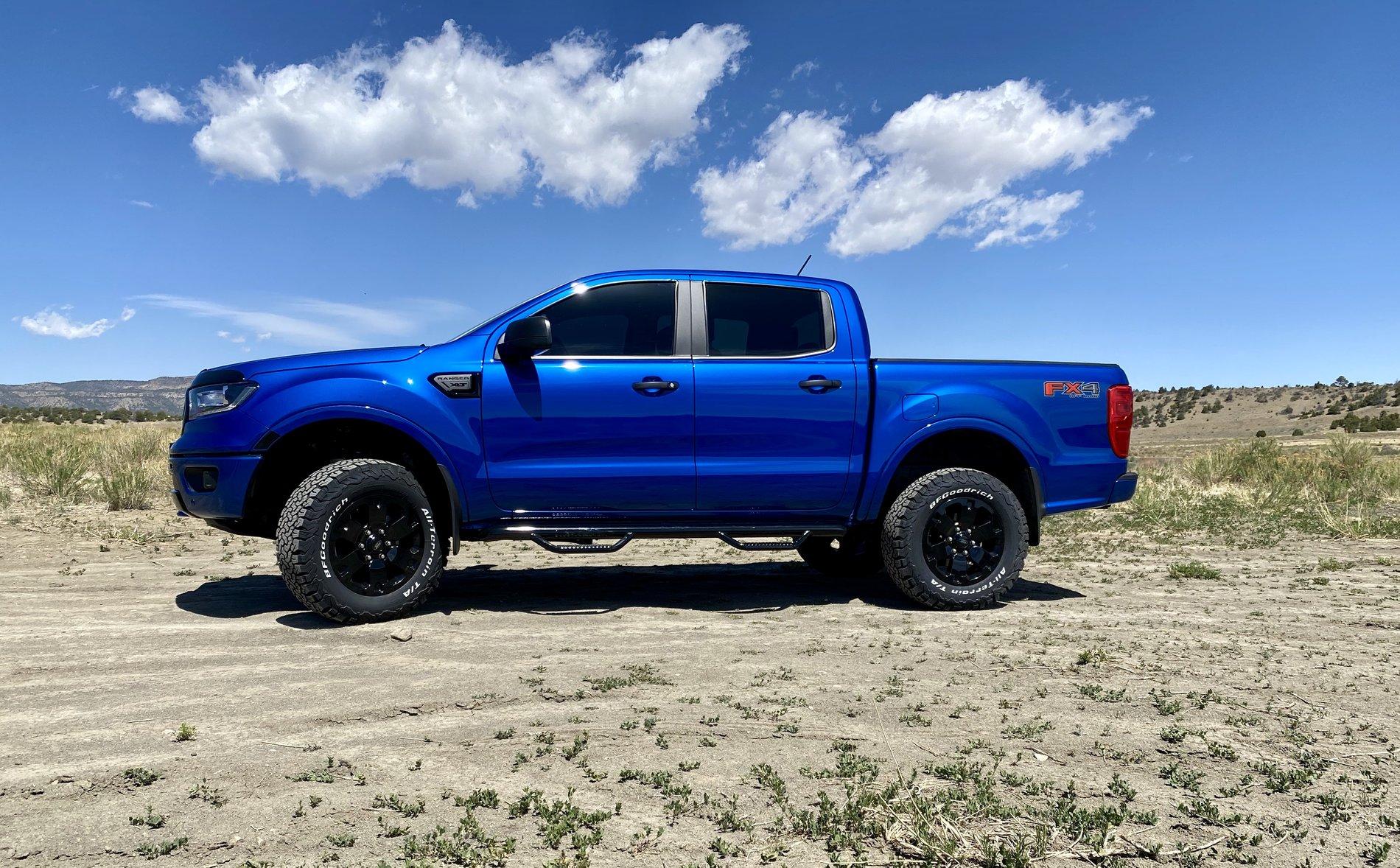

Also, @Pluto thank you! I just switched to BFG All Terrains in 275/65R18 KO2. I have the 3" Readylift SST lift on it. I also just added some N-Fab steps.

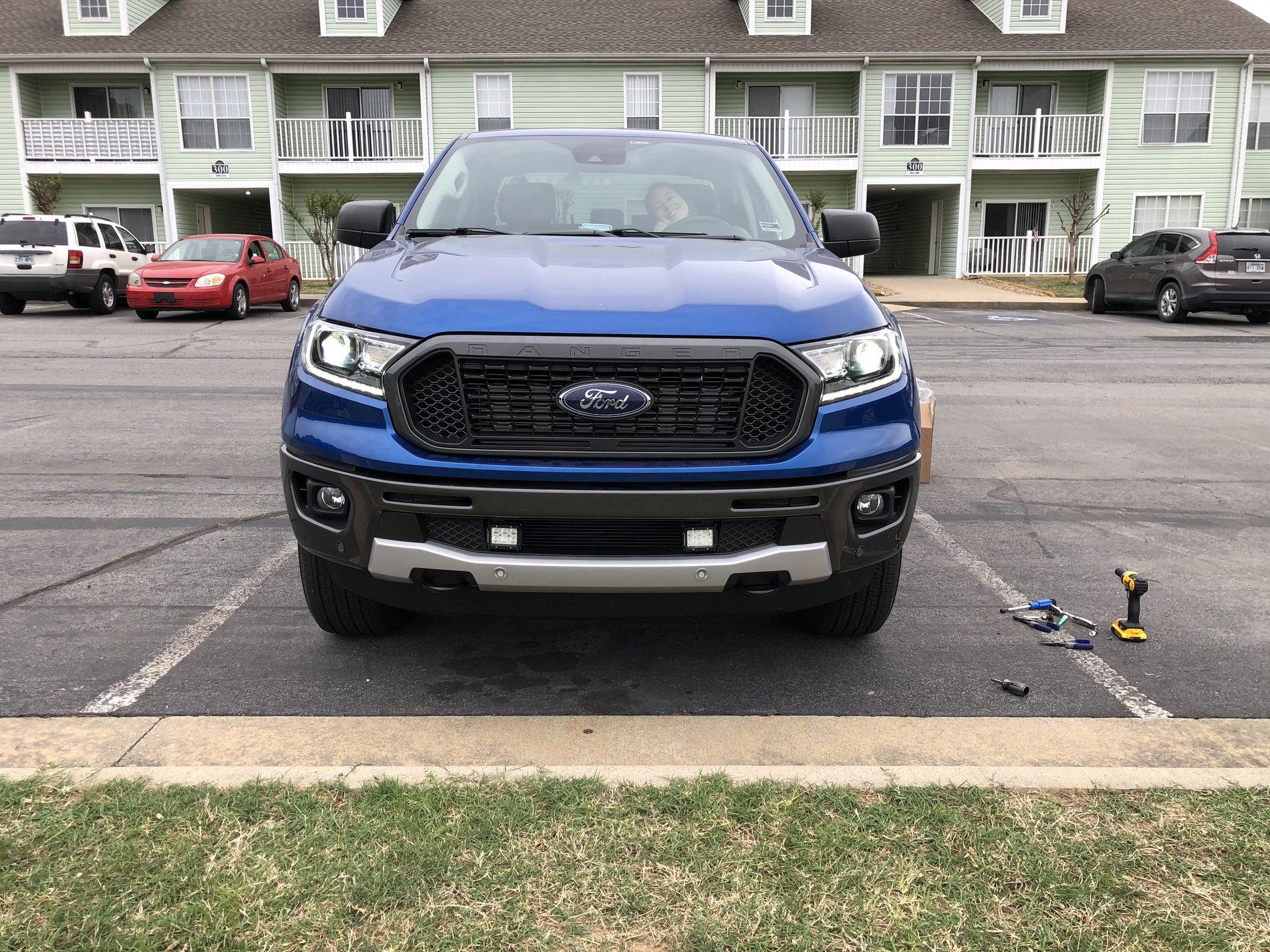

Found someone else's thread on how to re-aim them. They turned out GREAT! Can't wait to get my FORScan module so I can fix the DRL's!!

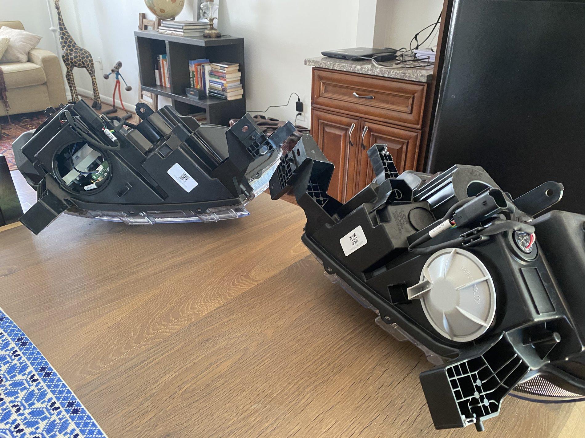

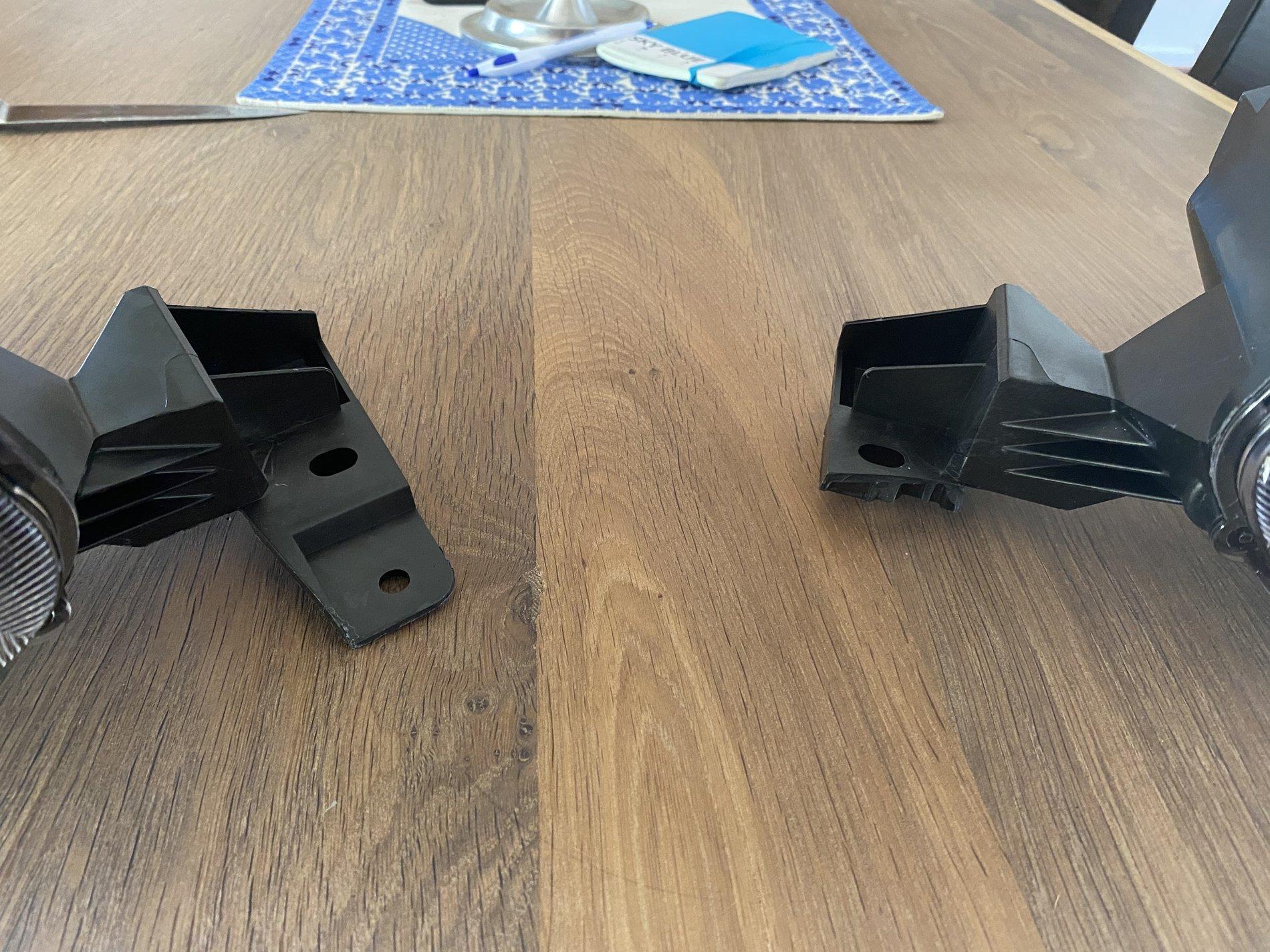

I didn’t buy mine in pairs. I bought them separately but from the same vendor. The right headlight cost me $386 and the left cost me $460. The vendor said the right headlight had a scratch with one of the mounting corner pieces damaged. I had no issue installing the right light and I can’t even notice the scratch. It’s so minimal. The left headlight also had a damaged mounting bracket but the lights are installed without issue. I’ve not had a single issue with the right or left headlight despite these “defects”. Don’t let perfect be the enemy of the good. I guess that’s the lesson here.

You can see the minor damage to the corners and I forgot to mention one of the lights had a missing cap, which I just took off the old headlights and put on the lariat.
