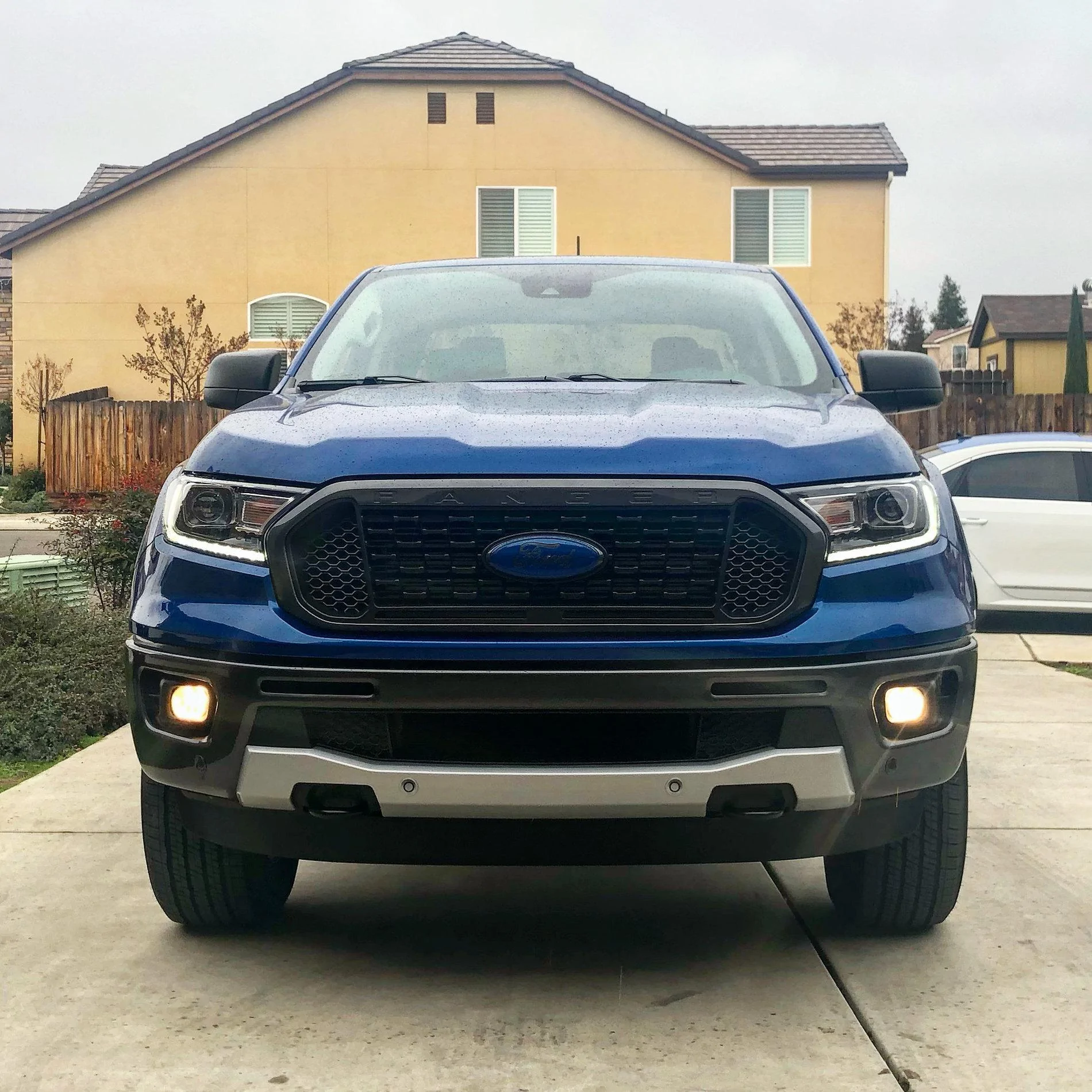

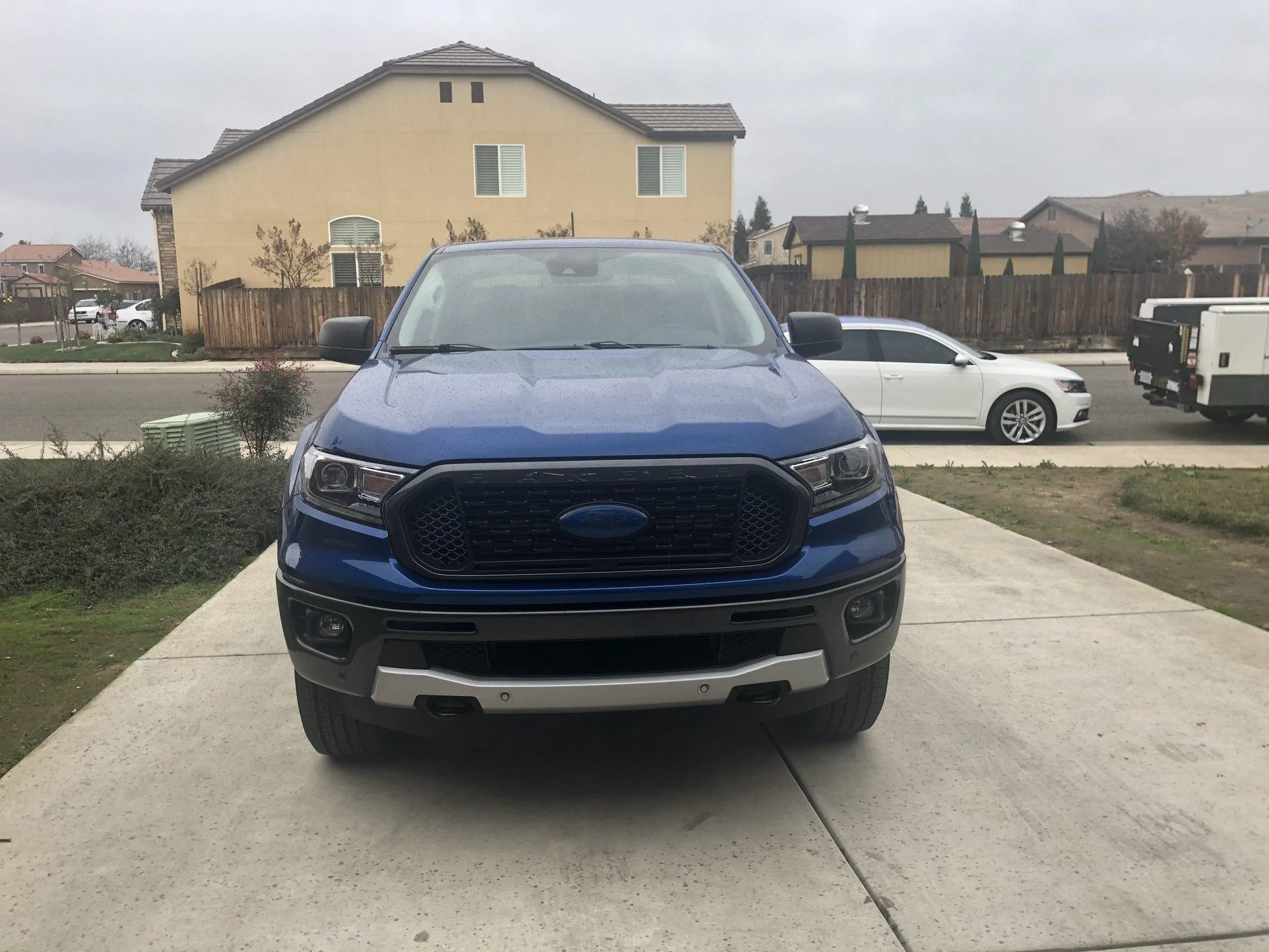

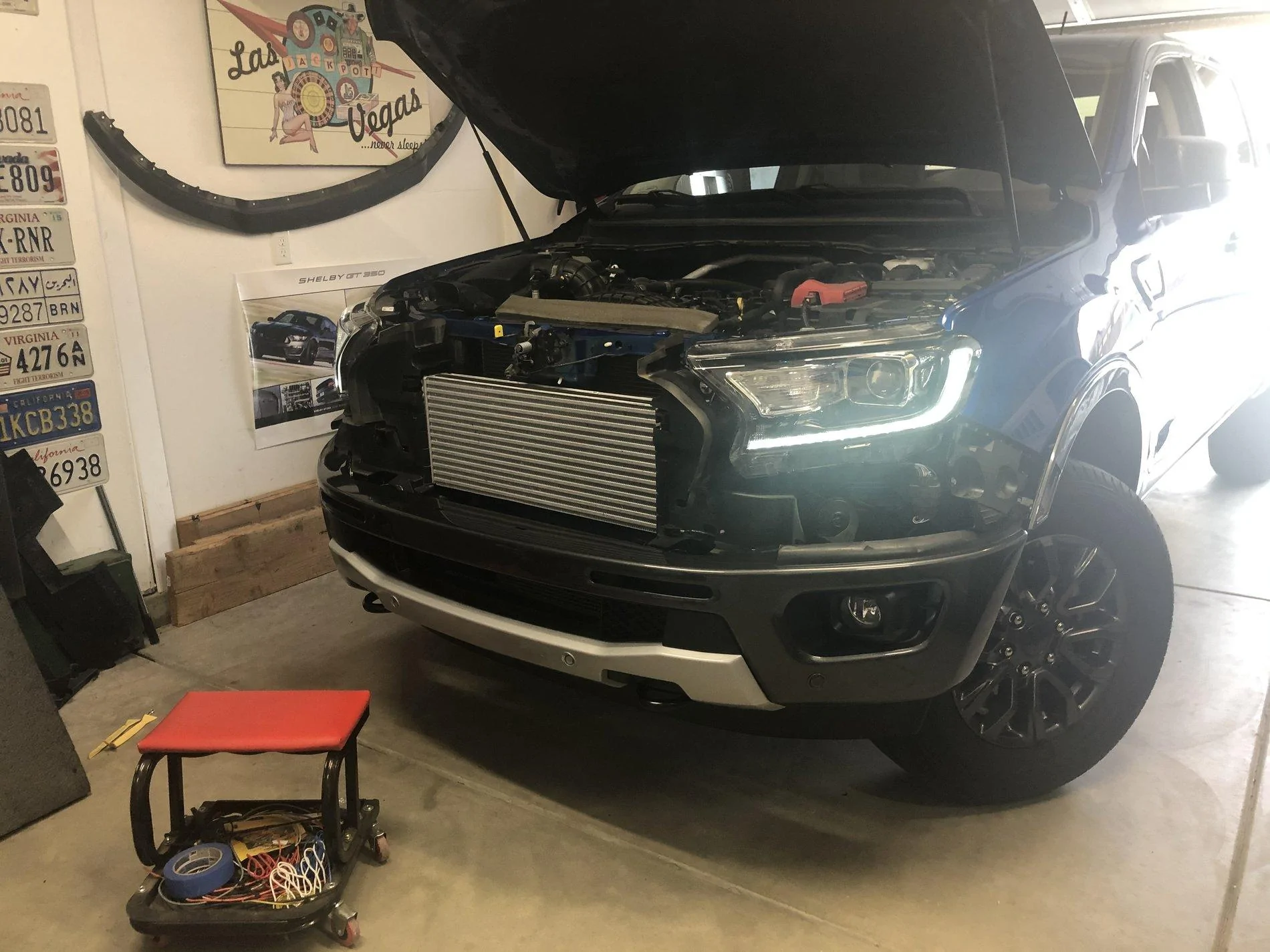

thank you OP for posting your video and making this thread even though it’s gone way off track. I was able to get a pair of the Lariat headlights and just got done doing the swap. Came out great. For those who are on the fence about getting some retro fit led setup and potentially hating it after spending a few hundred bucks on those bulbs, you can source these headlights if you are patient from junkyards or eBay. I got mine for 1k for the pair. Seems like a lot but not a whole lot more than running through several sets of bulbs and having issues with aftermarket kits.
Stockranger
Carl
Dec 6, 2019
72
143
2019 Ranger XLT Sport
Wanted to throw an update out there for anyone else doing this swap.
I noticed my DRL was still my low beams with the new headlights just as it was with the halogens. I really wanted the LED strip to be the DRL. So I did some poking around and found out that it’s a forscan setting that can be modified (found it in this forum)
so I got my forscan all setup (I had been procrastinating on this), and went into the settings. I turned on all the options and then selected the “dedicated DRL”. It indeed turned off the low beams as DRL but sadly it appears the XL and XLT wire harness lack the pinned wire that runs the dedicated DRL. I had no DRL with this function selected. So I went back in and the only other options were turn signals, low beams, high beams or none. I selected turn signals and thy does work. For now this is how I will run it. But I plan to run the dedicated wire and pin it in. I have a factory wire manual for the truck so I will get it figured out.
this is the only real “snag” in this otherwise simple plug n play swap. The LED strip does still function when parking lights and or headlights are on. They just can’t be controlled individually. I will update this once I figure it out.
