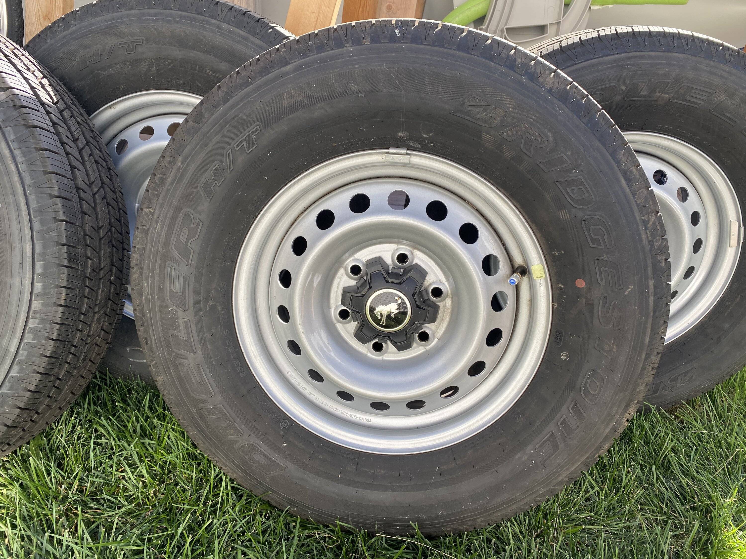

I picked up that set of 2021 Bronco take-offs. Five 16” steel wheels with TPMS, Bronco center caps, and Bridgestone Dueller 255/70 R16 with less than 100km on them.
I will sell the rubber and probably the extra wheel. This should just about break even.
Even if I scrap the tires (I won’t), steel wheels are $100 each, and TPMS are $115 each - all for $450CAD.
Now looking for a really good set of 265/75 R16 tires. Oh, and something to cover up those horses on the center caps.

Because the Bronco wheels are 16”, I need to get a different aspect ratio to match the height of the stock Tremor wheels. @265/70 17.
My options are:
A) Yokohama Ice Guard G075 @265/75 16 = same height as what I have now. $259ea.
B) Michelin x-ice - although this is not available in a 265/75 16. I can get it in 265/70 16 = -1” from the current tires. $281ea.
C) Bridgestone Blizzak DM V2 - although this is not available in a 265/75 16. I can get it in 265/70 16 = -1” from the current tires. $255ea.
Most of the comparisons I have found rank the Yokohama #3. They also consistently rank the x-ice and Blizzak as either #1 or #2 - but they are consistently in the top 2.
Now, what do you folks think - stick with the same overall size and go with Yokohamas? Go to a slightly smaller size (I believe the same as all other 4x4 Rangers) to get a slightly better tire? Keep in mind I’m in Canada (affects pricing and availability). The prices posted are an average, and the spread is only going to be $100 - so I will say the price between these is not an issue. Bridgestone has a 265/75 16 listed, but they seem to not be available currently. Based on your comments so far, any of these will be a SIGNIFICANT improvement.

I realized I am overanalyzing this. And like has been pointed out - any reputable name winter tire is going to be a significant improvement.
Ordered the Yokohamas, which should arrive in a day or two. The weather has been unseasonably warm. I will hold off putting the winter tires on the truck - something I can do myself. Need to dig out the OEM chrome lug nuts. And what to do about the Bronco logo on the centre caps..?
