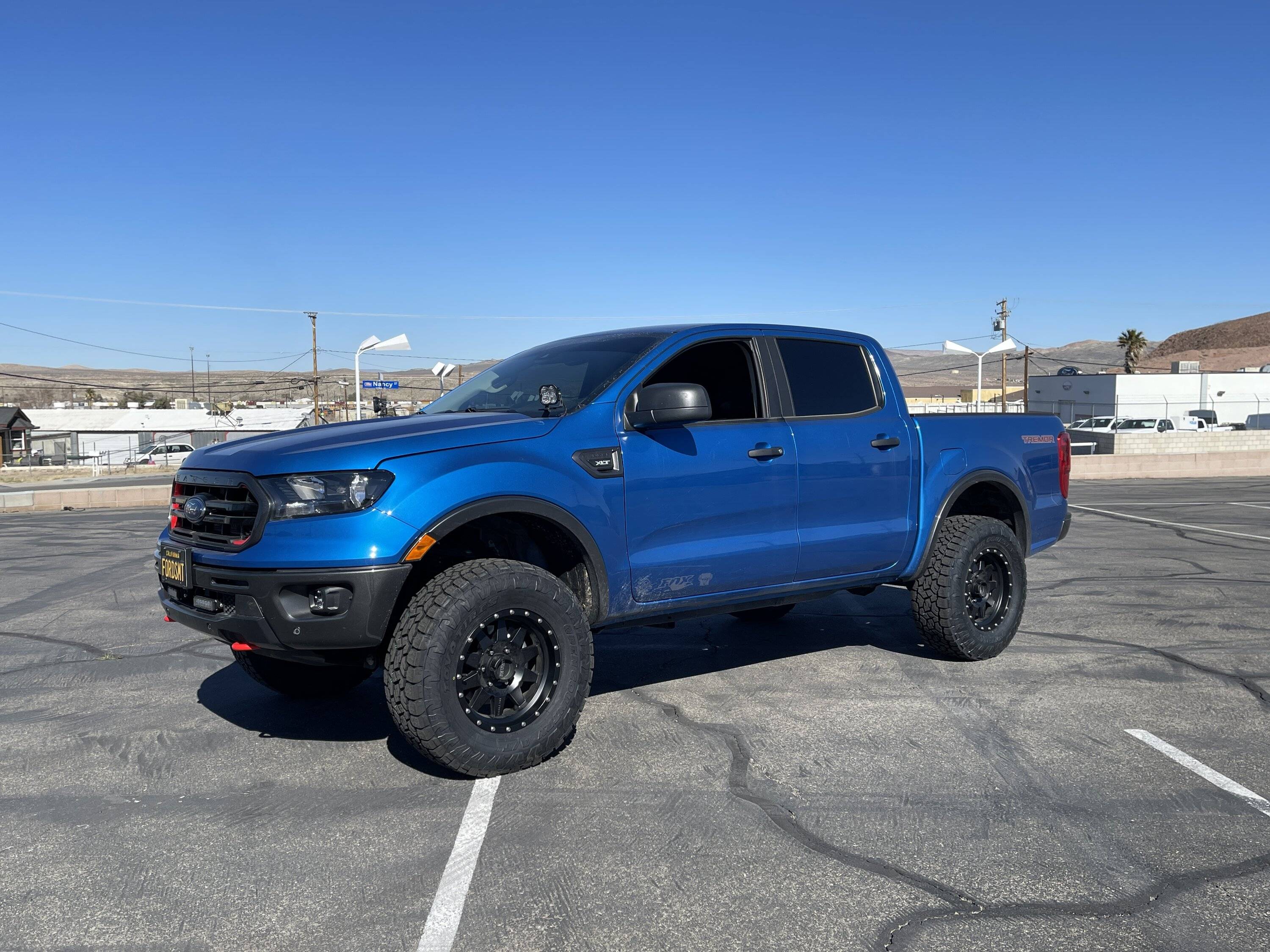

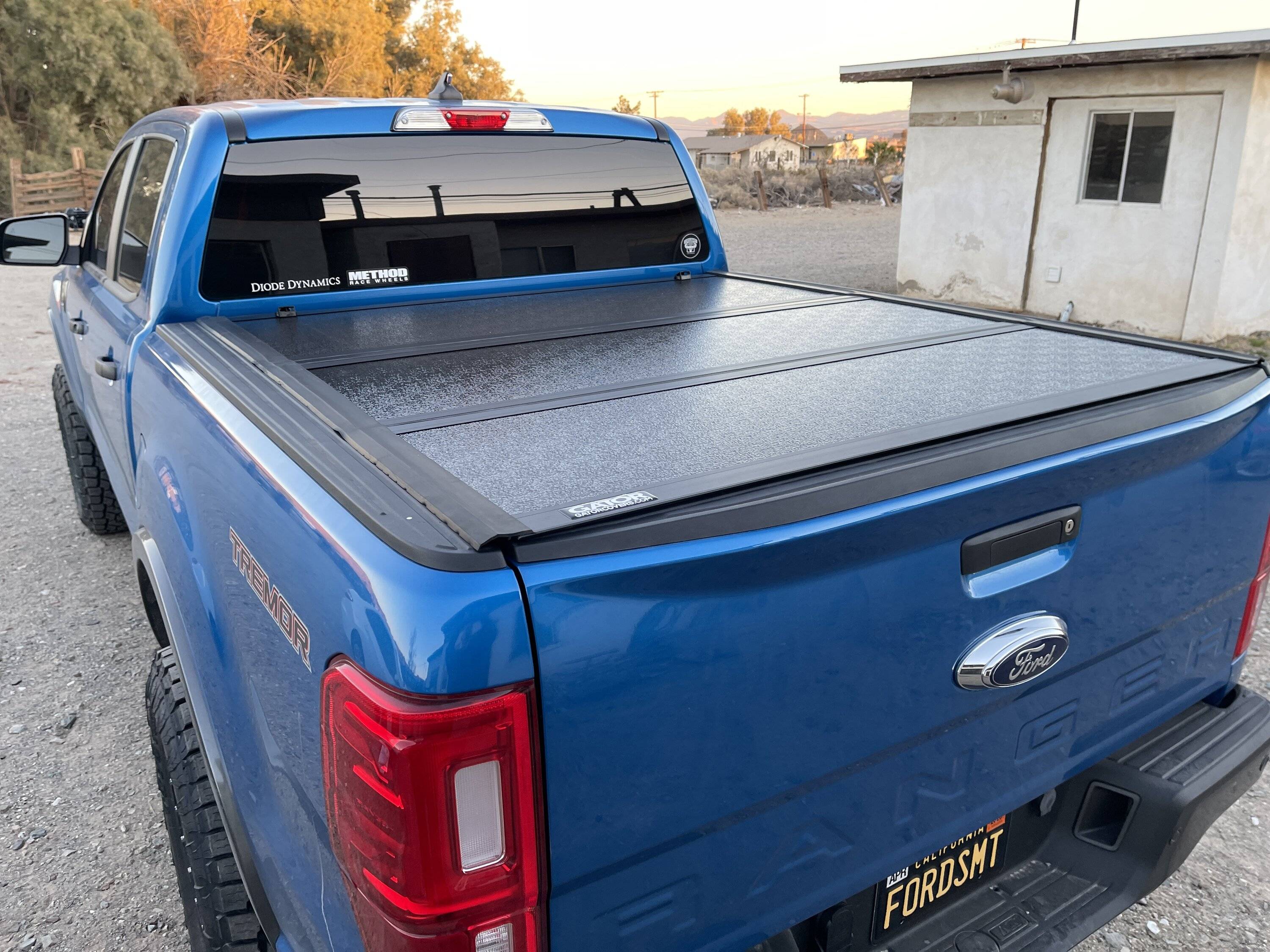

Great looking truck Sven! Love those Methods and tonneau! If you don't mind sharing, what lift, tire size, and wheel offset did you install? Like the poke too...did you have to use spacers?

Only the level kit from Woolworth it’s the 2, 0 offset wheels and 285/70R17 tires.

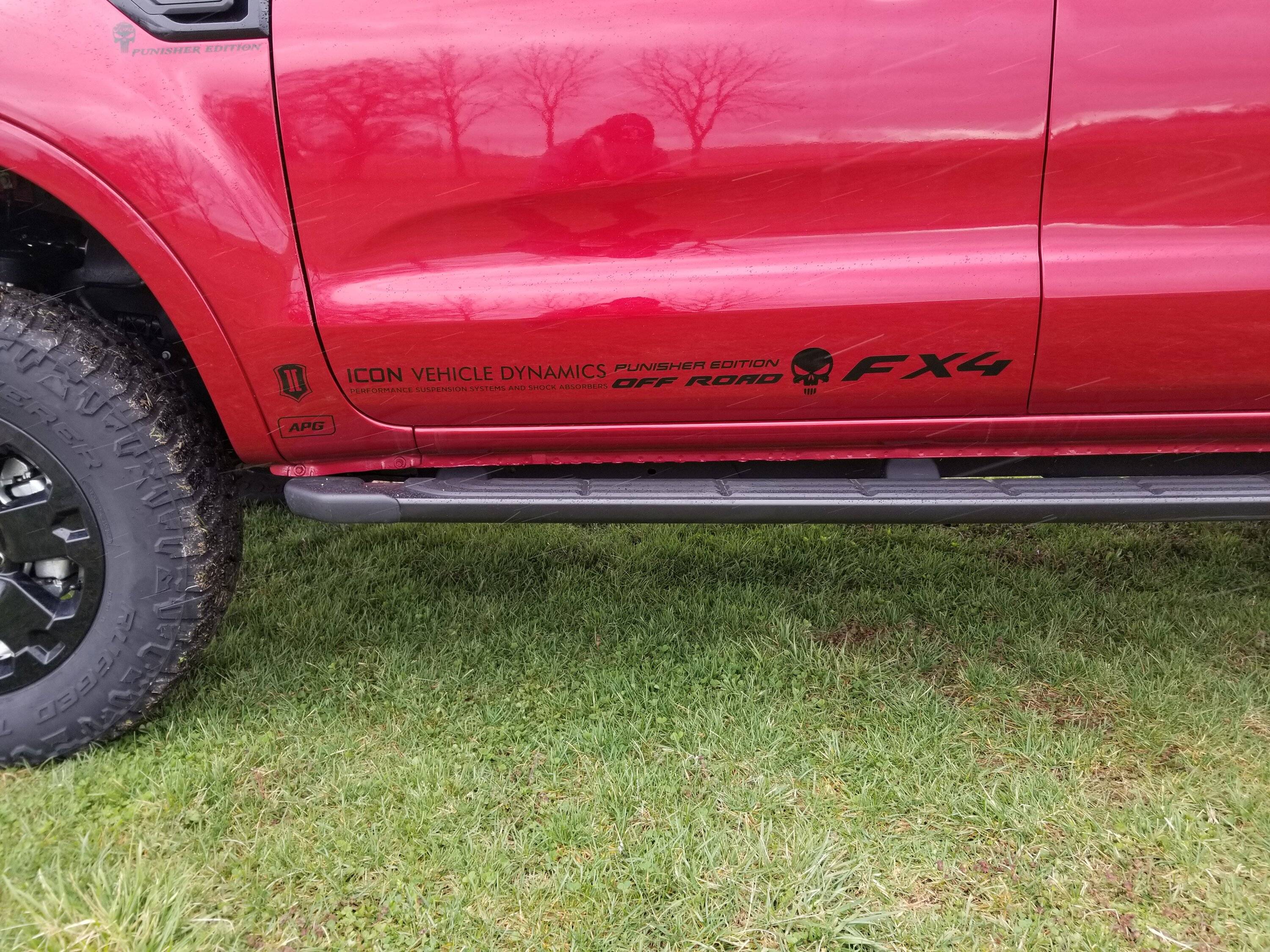

My tremor is coming along nicely
Great, start....
Really like grocery list on the rocker panel.....I've done the same to mine
....looks like we both still have room for lot's more mods....??

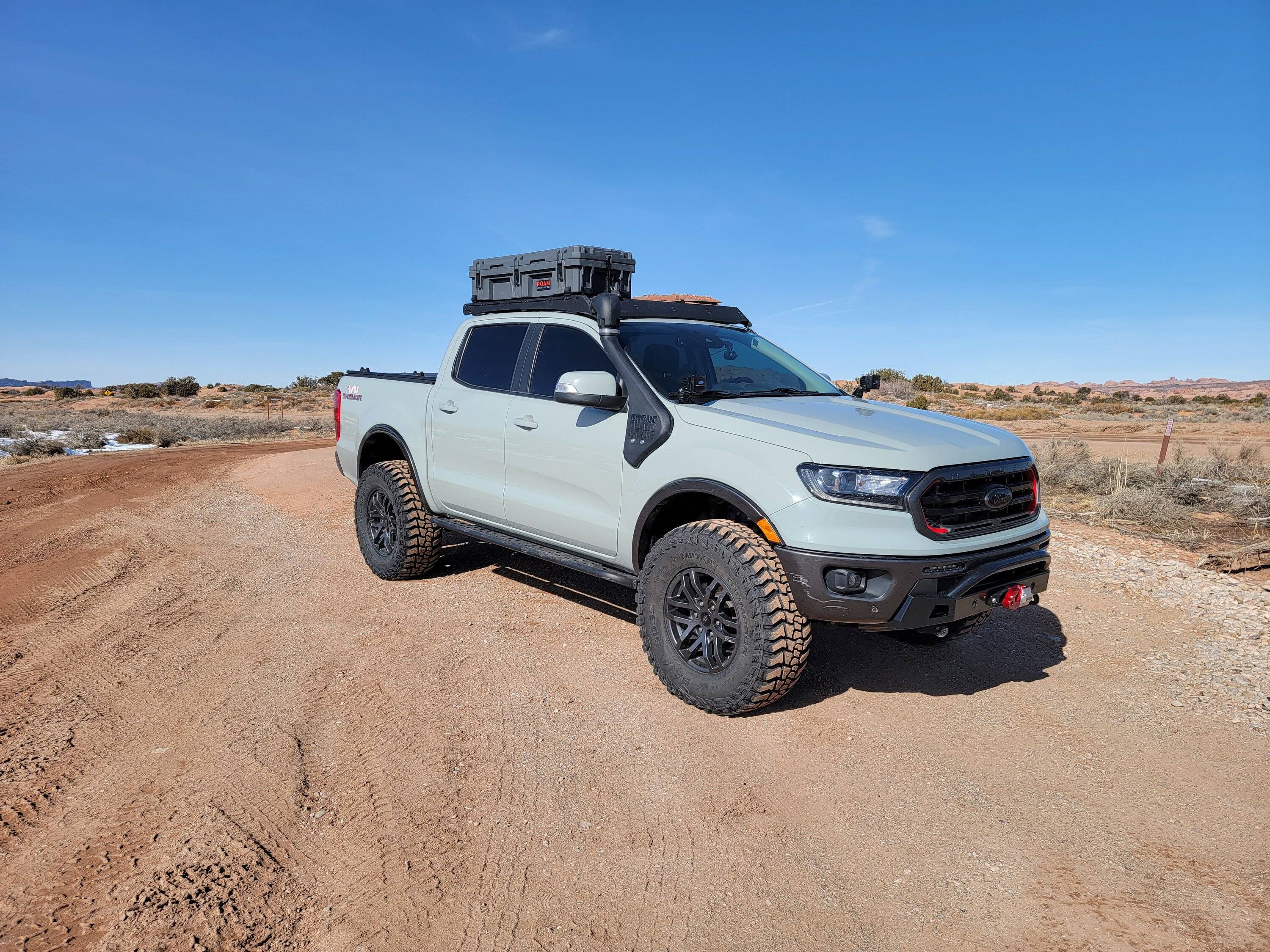

Here's some more will power help haha!
Great Tremor Fordsmt!
Love seeing the trucks hit leg day
What size tire do you have and did you need any lift?
In that pic, those are 315/70R17 baja boss MTs. For those to not rub the front, a 4" lift (achieved with fox 2.5s adjusted to 3" + a spacer), crash bar removal and 1.5" wheel spacers were needed.
I have also ran 285/75R17s (34s) that needed the 3" lift + wheel spacers + extra clearance crash bars
And lastly, when I was on 285/70R17s I only needed extra clearance crash bars and a 2" lift.
