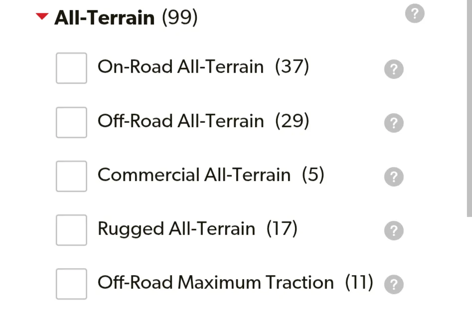

Remember that the Mickey Thompson you are referring to is simply an All-Terrain. It's the same for the Firestone Destination XT. Now I haven't tested the tire above, but I have had the XT on 4 different vehicles and I have been impressed with the capabilities OffRoad and on the pavement. This includes wet and winter weather driving as well. How would the MR BAJA AT compare? Without a side by side comparison it would be hard to say that said it is still a heavy tire in the P Rated form. Perhaps there is a good reason, but who can say.
