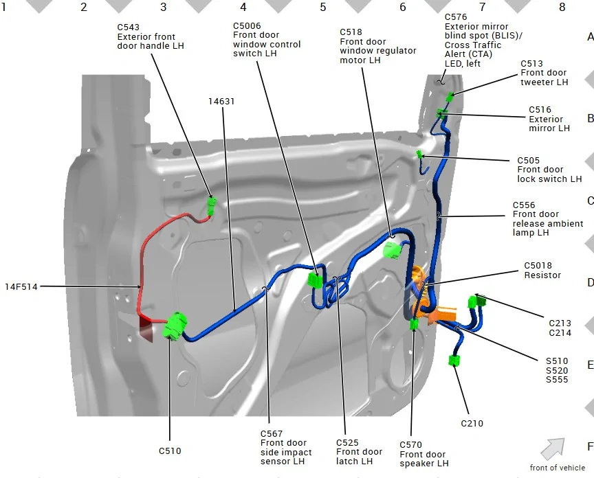

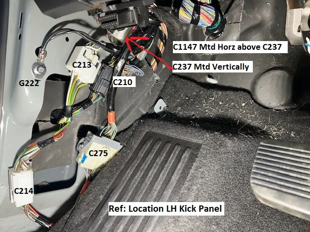

The only logical possibilities are the (Switch Assembly) is internally shorting power or the wiring harness is damaged (where is runs into the door)
Note: C210 /C213 / C214 - feed wiring into the door (Rubber Boot)
With Engine Running:
You may try to duplicate the issue by gently (shake/ bend/twist) this short harness section to see if any auto movement is noted. (You want to simulate what happens when you open and close the door)
Also check loss of operation with the switch assembly while doing this:
NOTE: The window motor circuit has a thermal CB, so if T/Shooting and continuously operating the circuit Up/Down in succession it will break the circuit (until) the CB cools and resets.
So don't get tripped up on that operational design

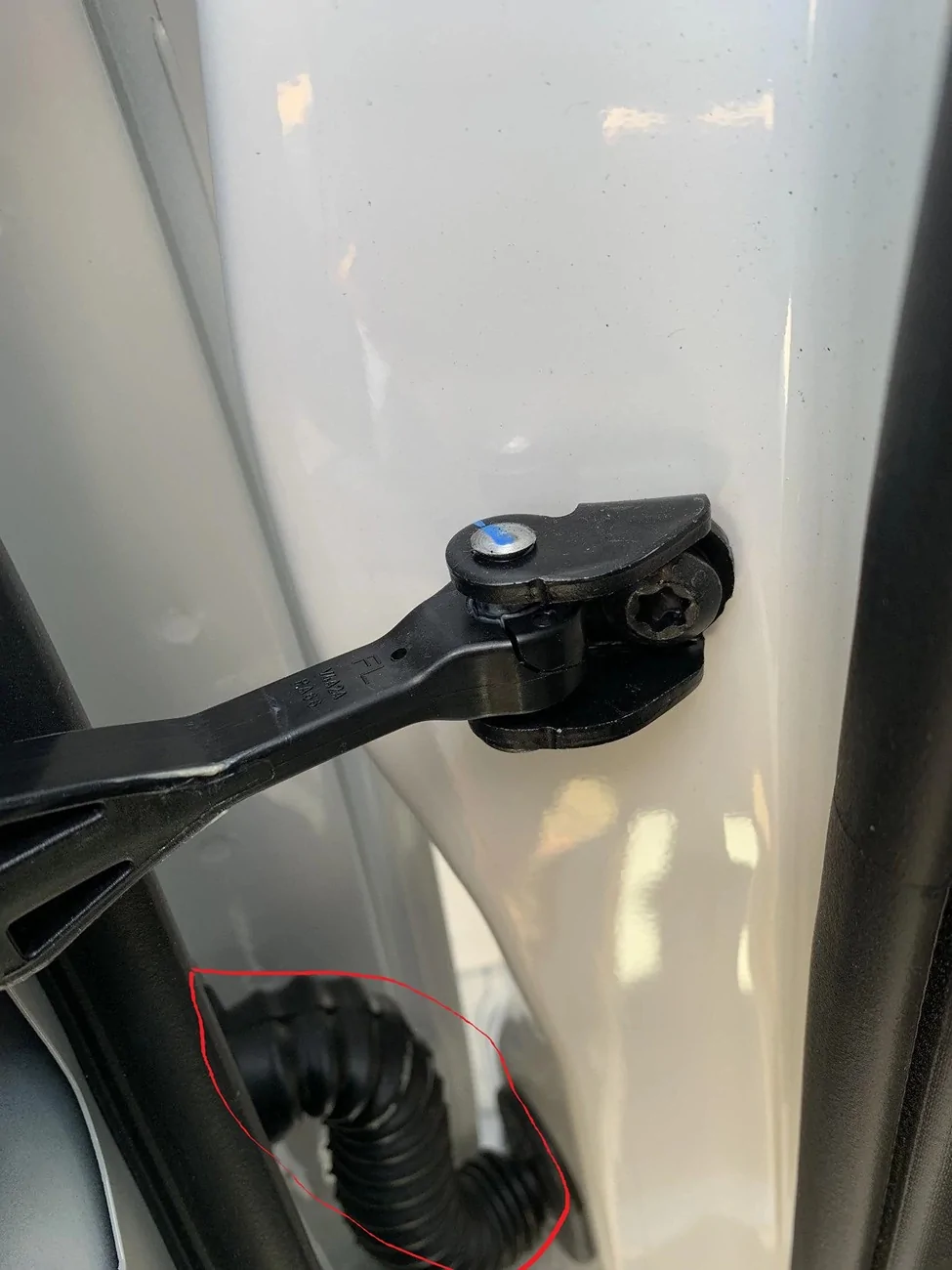

Borrowed Pic from the Door Check Thread:
