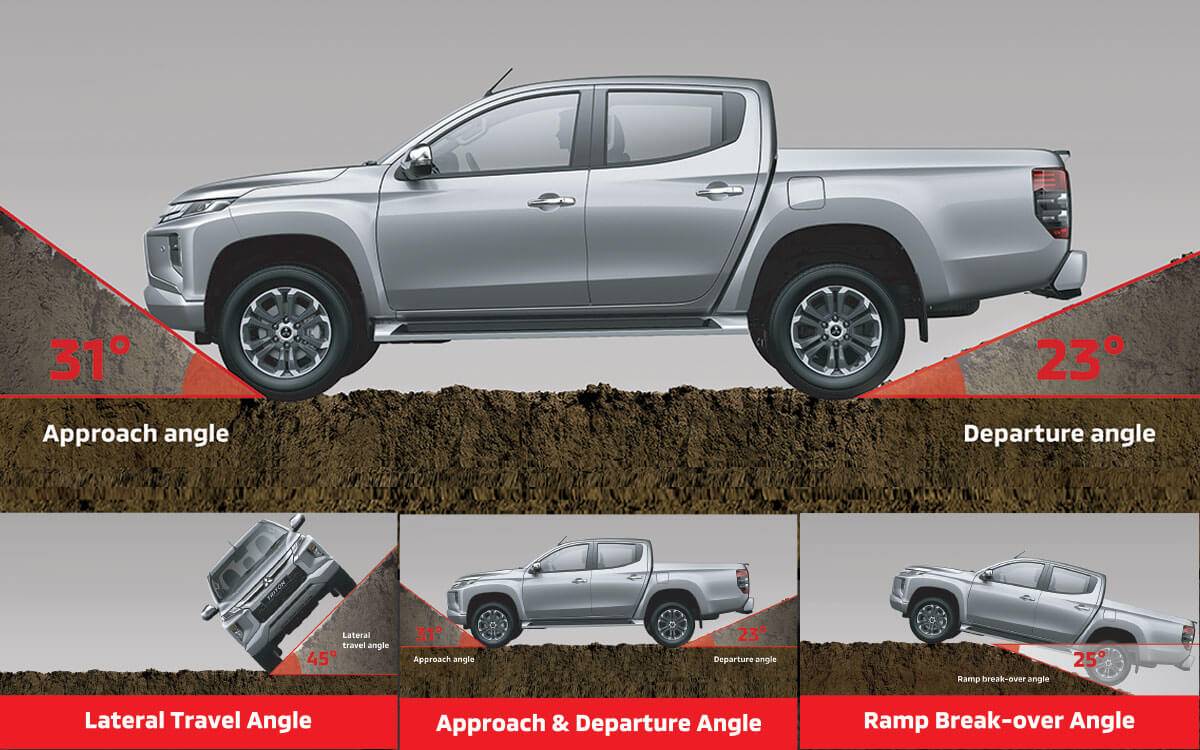

Raise the front end gain approach angle. That helps to get over obstacles. If you can’t put a wheel on the obstacle your not proceeding forward. That is why approach angles are important and advertised for off road vehicles.
Front end also has 4 sensors that will be a costly repair if damaged. Level the front helps to get them to safer elevation. Leveling doesn’t eliminate the sensor issue but it helps when off-roading.
You were only thinking about the underside of the vehicle.
Ok.
But you will decrease the departure angle, no?

Approach angle would be the only gain, wish I measured mine before and after to see what it was.
Naaa. Nothing happening with the rear end. Your not lowering it.
Put a jack under your front bumper and raise it 2” and you will see nothing happens to the tail end measurement height.

Geometrically speaking, I thought if you raised the front end, with the vehicle rotating around the rear axle, it would lower the rear end. Anything behind the rear axle should be lower, everything in front of the rear axle should be higher. Kinda like a teeter totter, with the rear axle being the pivot point.

How are you gaining clearance??
Front diff and lower suspension does not move.
If you can fit taller tires then that will lift the front and rear diffs. Not much, but some.
The axles are usually going to move with the tires over obstacles and you try to avoid high hard things in the middle that the tires won't go over and the axle isn't going to push out of the way.
Not much, there isn't much behind the rear axle.
Your correct. You will lose approximately 0.451 degree departure angle. I stand corrected. I will try harder next time. ?
