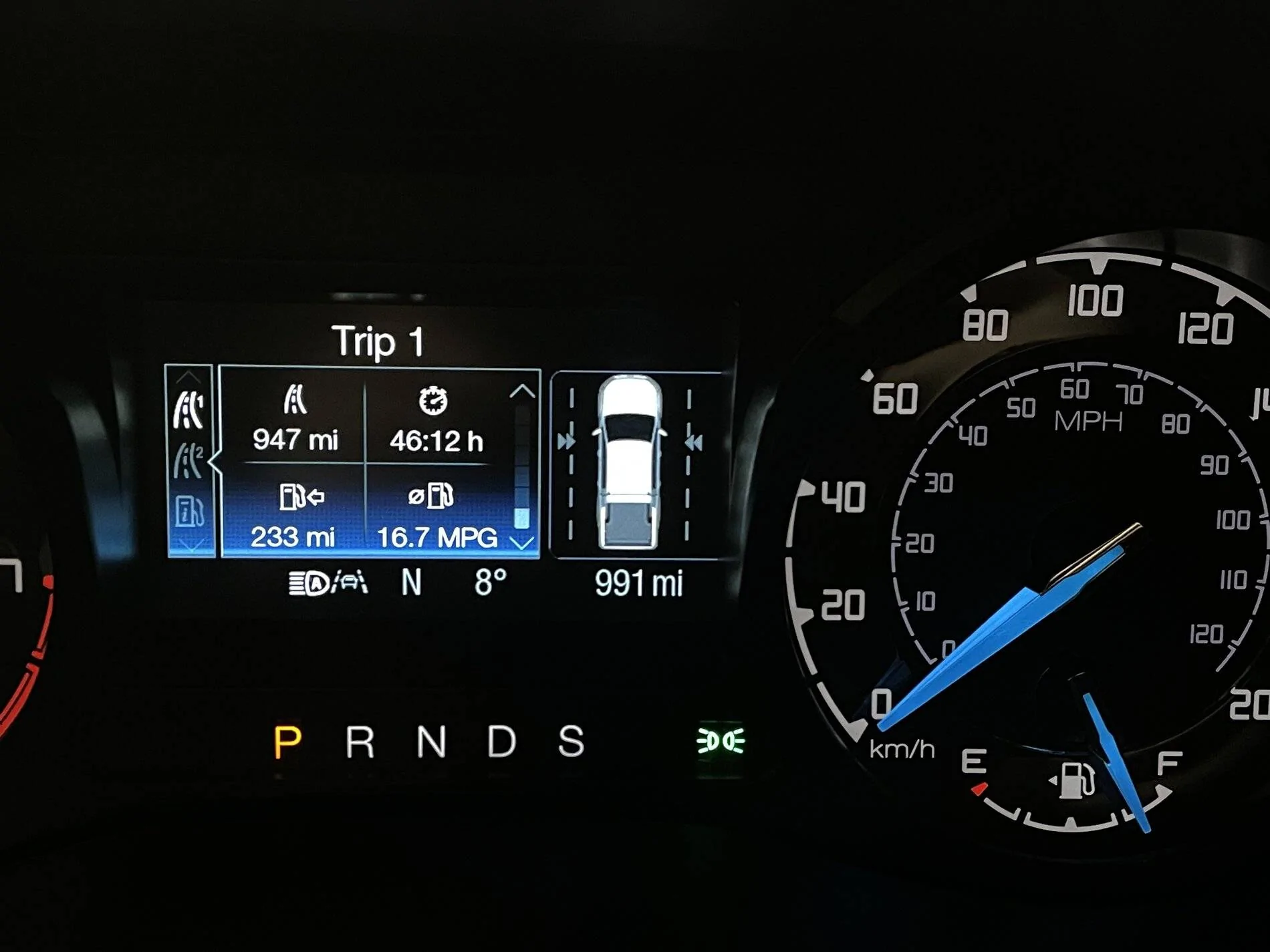

My tremor currently. 90/10% City/Highway. Fairly hilly area, was expecting a bit better. Tons of a fun to drive though so I don’t mind too much.
hopefully it goes up a little as I drive and log some highway miles!
