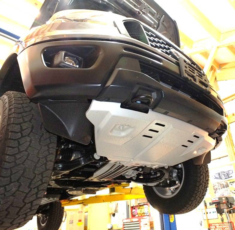

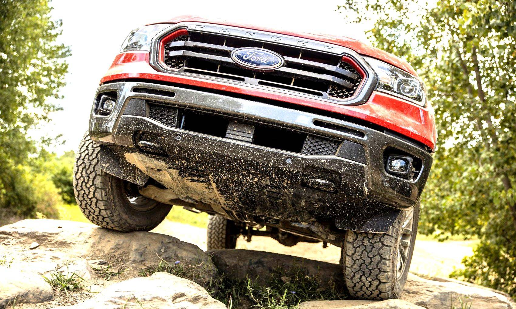

A large part of that estimate is due to the removal of the front air dam on the Tremor. That's why the hit is on the highway miles end. There is a YouTube video out there where a guy did a review of his FX4 and he mentions that once he took the air dam off, his mileage dropped off. I would think it would be pretty easy to rig a quick removal setup so you could take the air dam off and on as needed if you were worried about the mileage (off course you also have to order an air dam since the Tremor doesn't have it from the factory)
HenryMac
HenryMac
Sep 14, 2019
2,783
5,359
Mech. Engineer - Retired
I'd like to see that video. Could you post up a link?
What air dam are you referring too? There is no single "air dam" on an FX4. But there is on a non FX4 4x4.
The only thing the FX4 has (other than the skid plate) are two individual pieces, in front of the front tires, beside the skid plate. Is that what you are referring too?
Just trying to clarify what you are talking about when you state "due to the removal of the front air dam".
Other than the skid plate painted black on the Tremor, see below, 'm not seeing much of anything different than an FX4... well, except for the lift and the tires.
