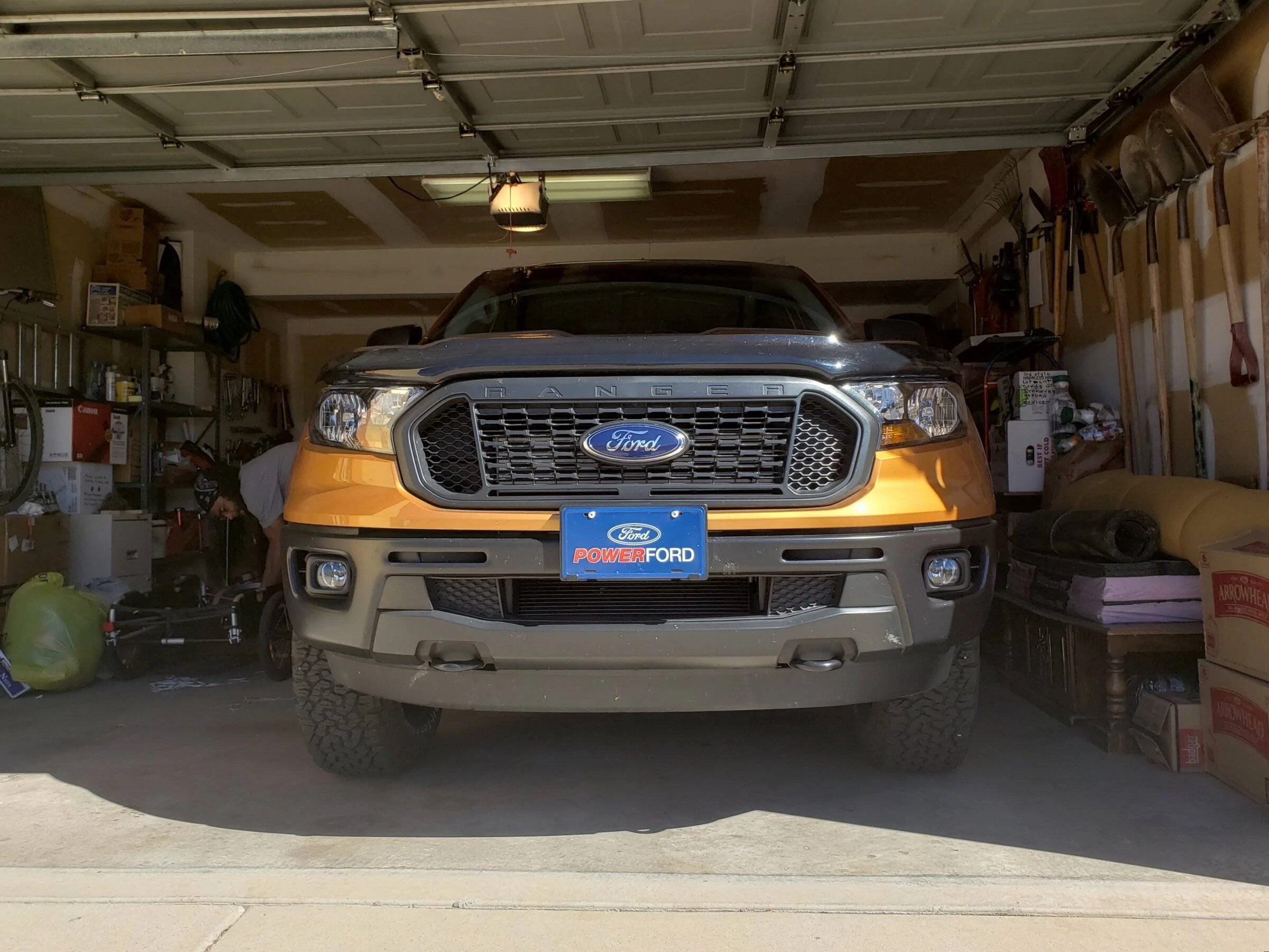

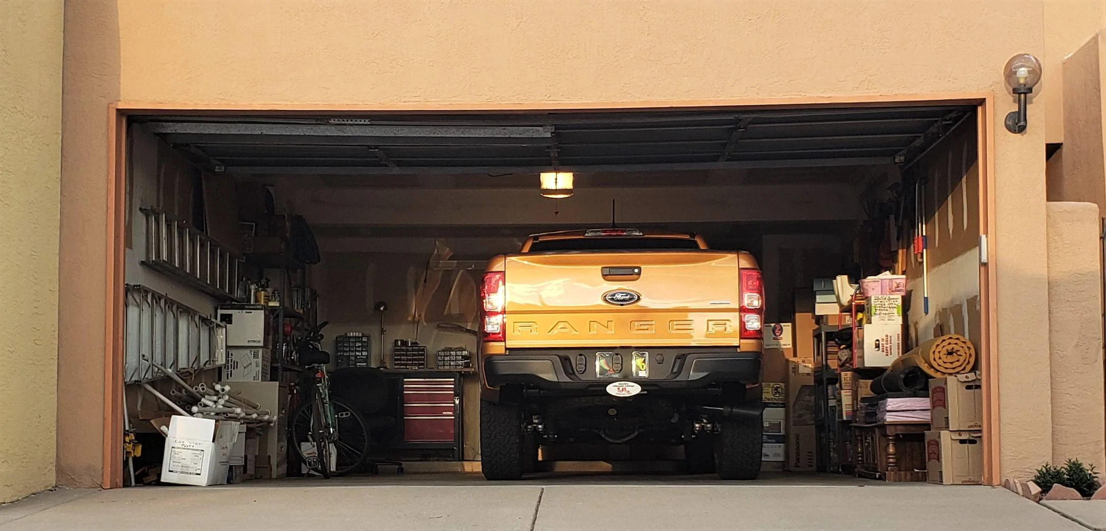

I have the same concern as you which is legitimate. My truck sits about 3/4" higher on the right side. I took it to the Dealer to document it and after checking it underneath said that nothing appeared to be a mechanical or safety issue. My Dealer said that a few other Ranger owners had reported this same issue to them, so they went out on the lot and measured some of the Rangers that were in stock at the time...some were level, and several were not. No service bulletins on this issue. I also documented a case with Ford (not a complaint against Ford) just in case it turns out eventually to be a warranty issue. I feel OK about letting it go for now (the appearance doesn't bother me) unless Ford discovers it to be a mechanical or safety issue in the future :)
