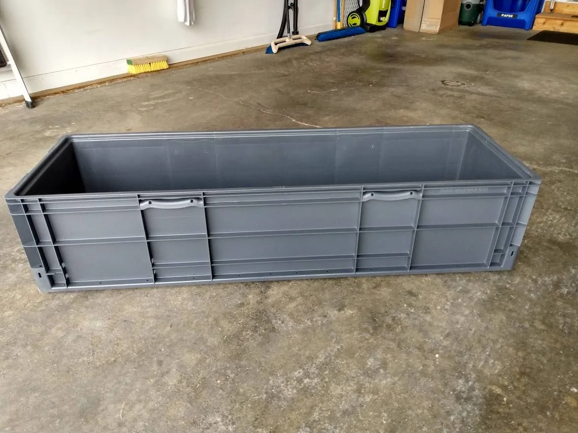

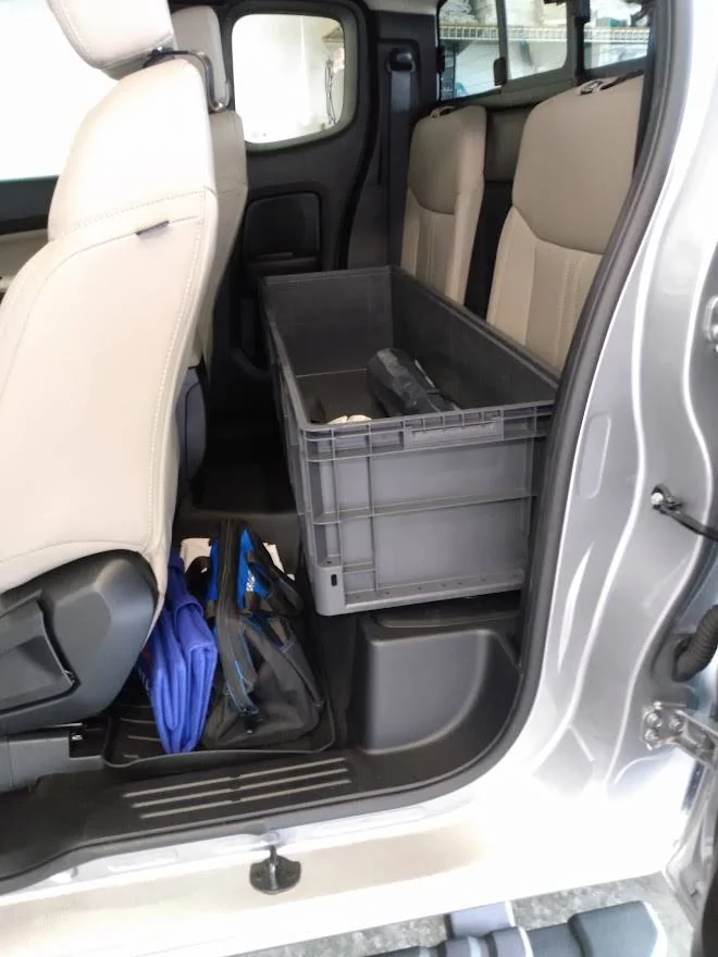

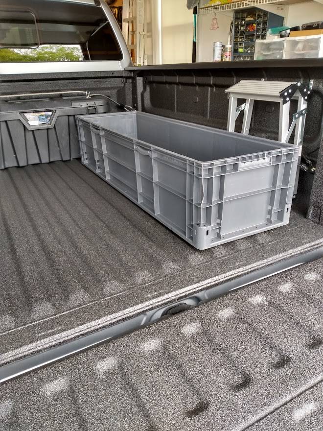

OK, the container came in today. Very good quality, made from heavy duty polypropylene....think cutting board material or the old milk crates stores used to use.
Pic of box, box in the bed, and box in the rear seat area. Removed the seat bottoms, and will be removing the seat backs.
But you can get some idea of how it will fit.
For me, my plans are to remove rear seats, buy a seat delete panel and trim piece, and secure the box to the 2 removable cubby covers. Make a removable lid so I can use it for storage, and to secure our doggie seats too.

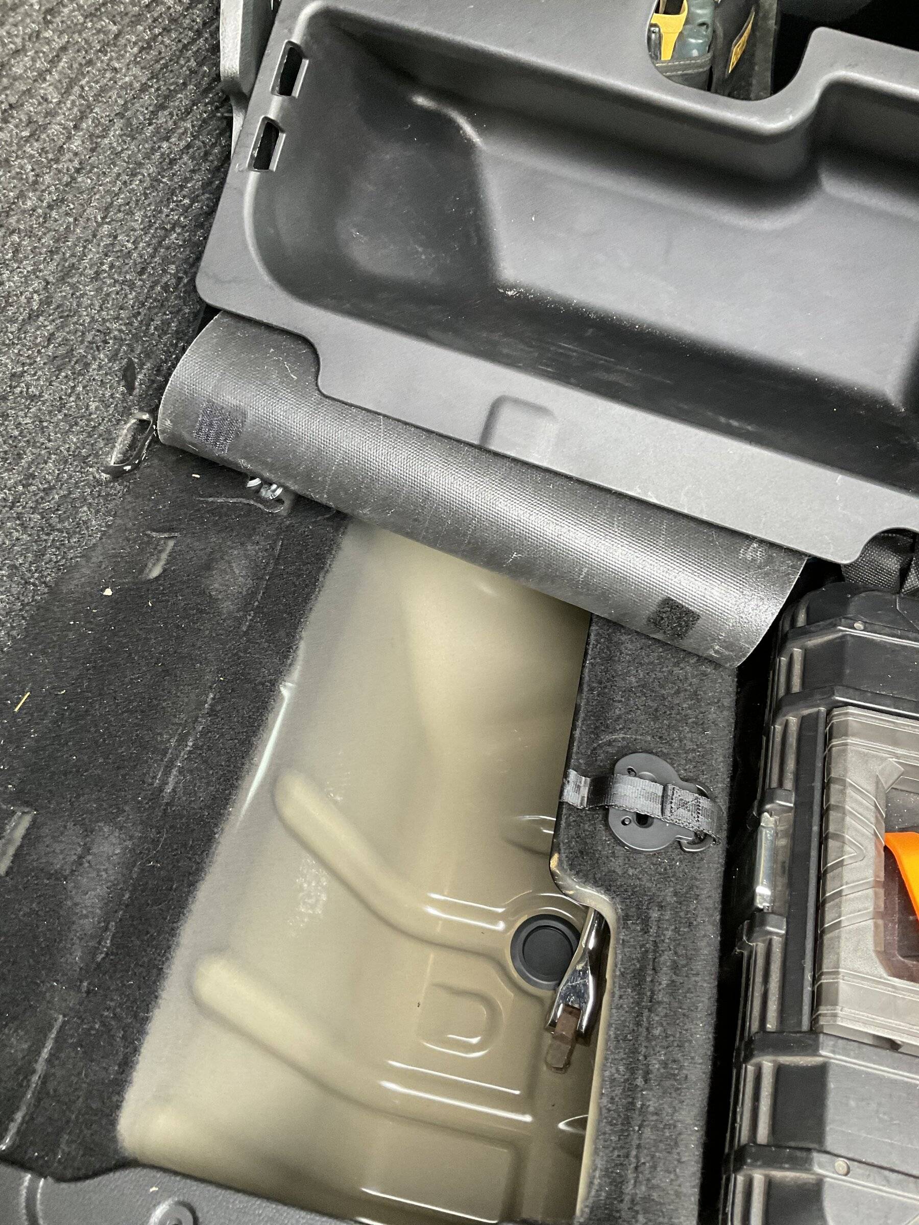

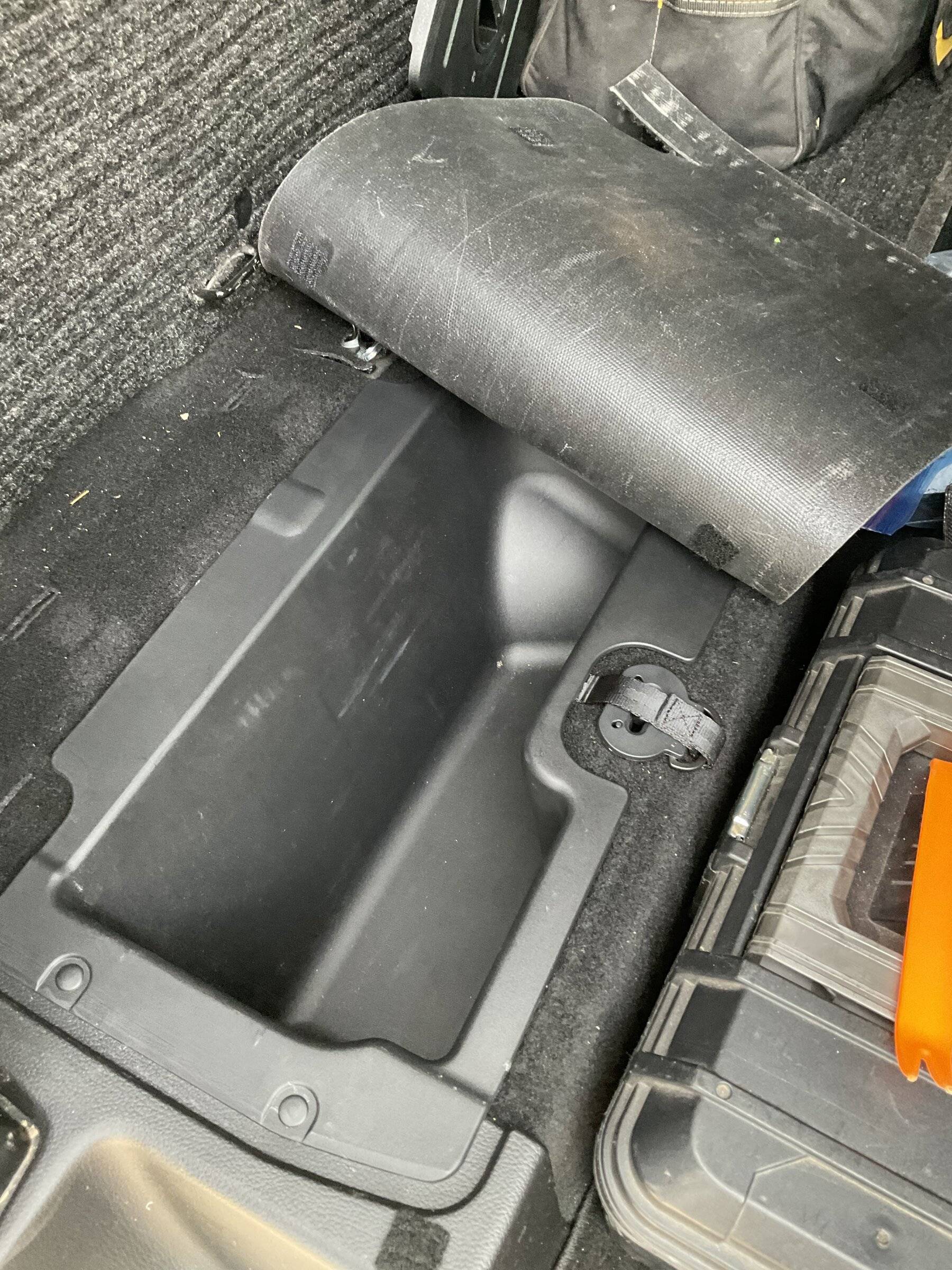

I haven't got my truck yet but curious from you guys is there a way to remove that plastic base completely right down to the floor and make a base from that point? I need to make a setup for my dog that i don't have to lift her into the back, Thanks.
I happened to remove one of those storage tubs to retrieve a breaker bar that slipped in under it from the Jack storage area. I can confirm the platform under the Scab rear seats is metal. You can see the edge of it under the carpet in the second photo below.
The seating area only looks odd because I did a rear seat delete.

From your pics and comparing the ones above if i remove the plastic bins the floor is tubbed, so it seems i cant get lower than the tubbed recess because it is part of the steel floor, i was thinking the plastic bin was laid out on a flat steel floor but it's apparent it's reverse as to what i was thinking/hoping.
