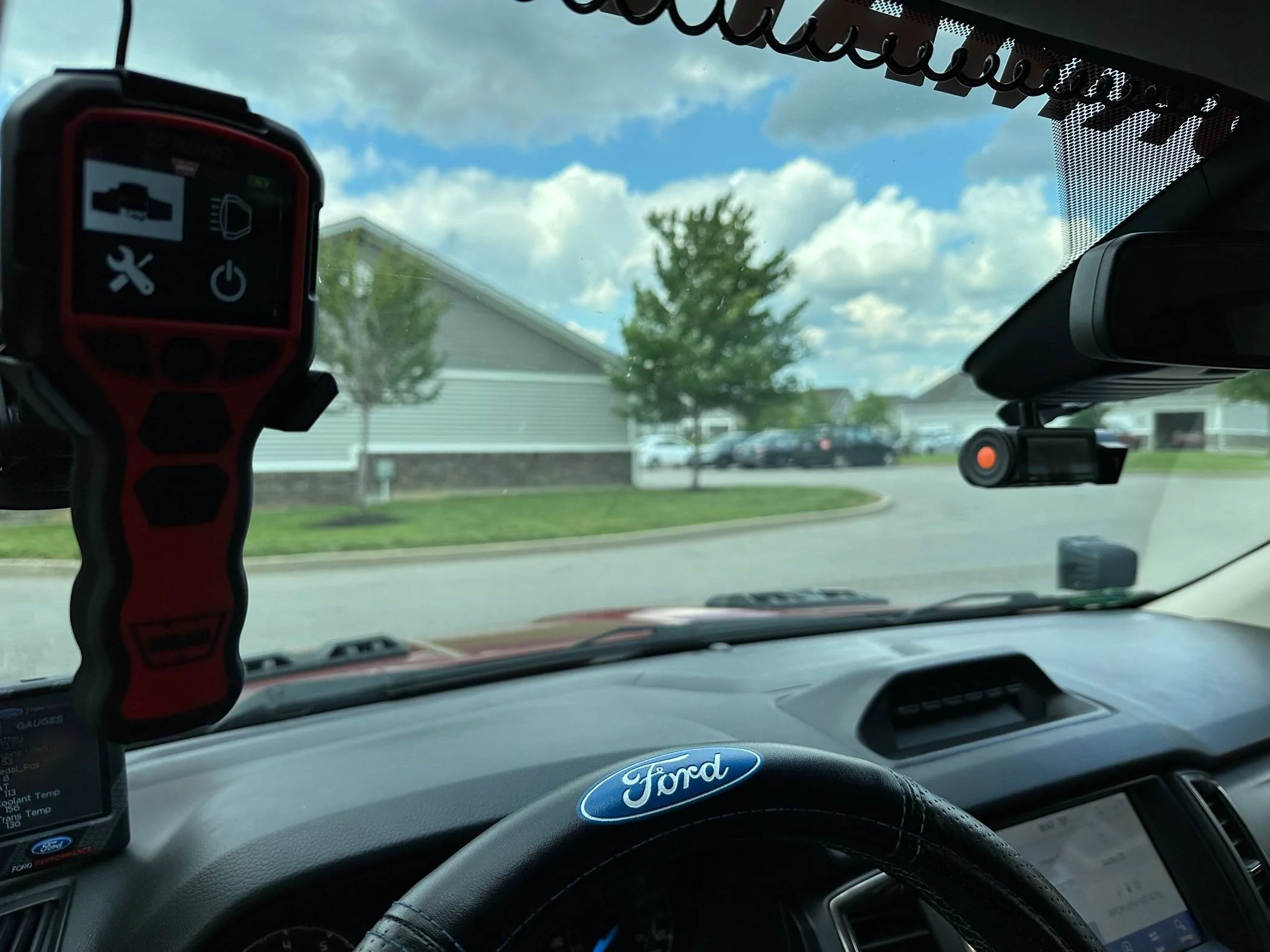

WARN Zeon Platinum 10-S bolted to the frame with 15K lbs. shear bolts. It don’t get any lower profile than this. ARM switch to AUX #4 (5Amp).

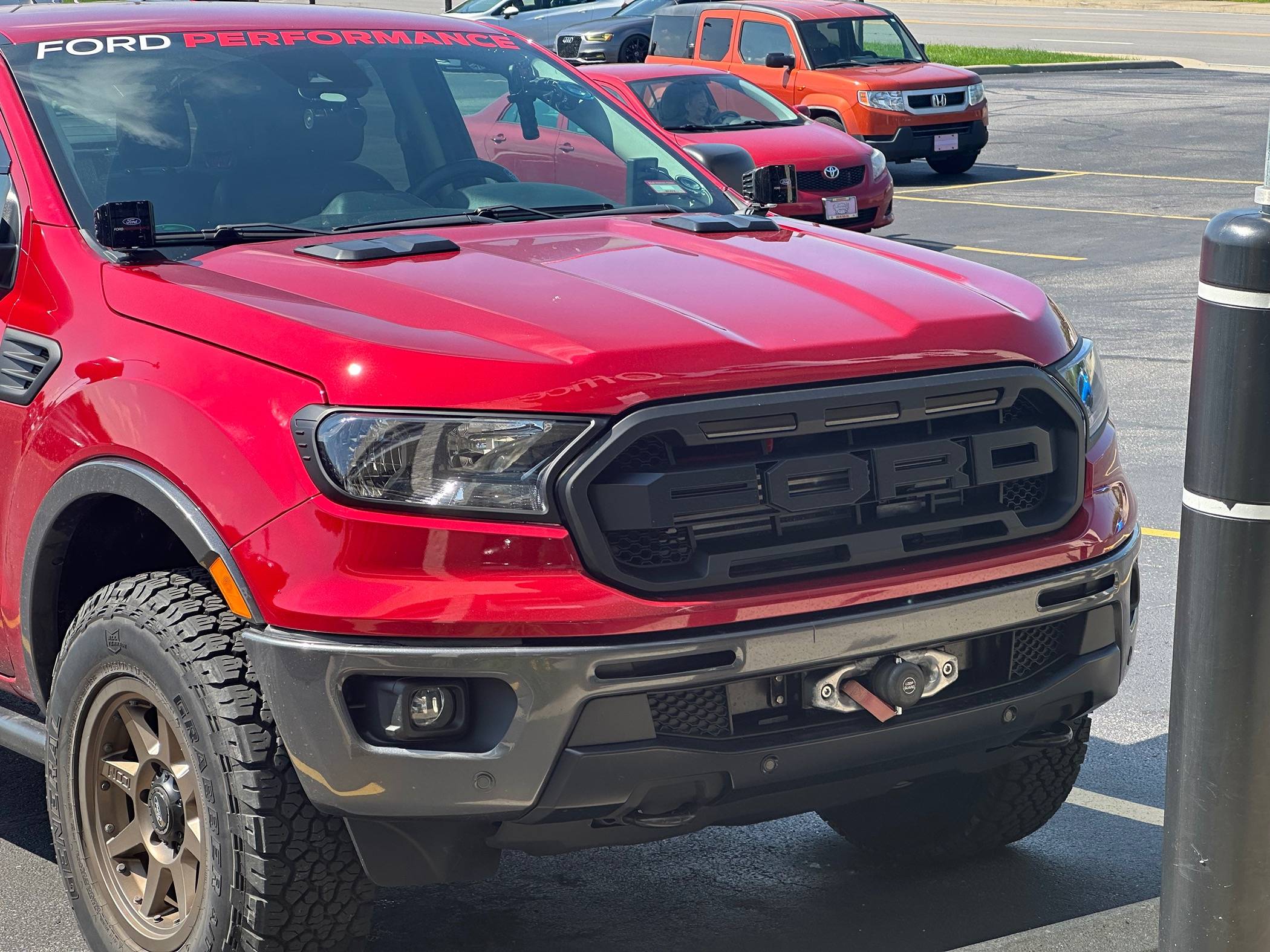

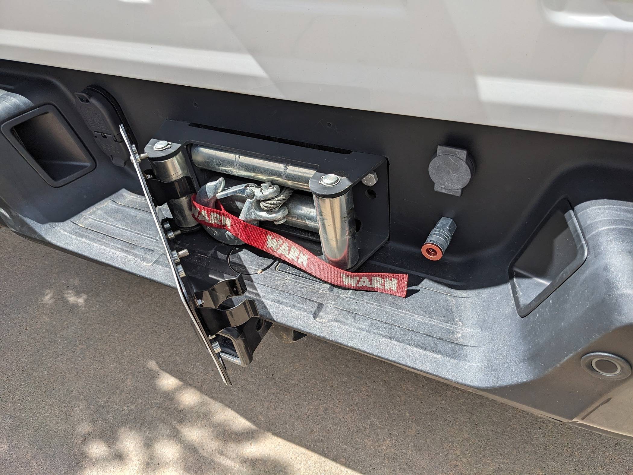

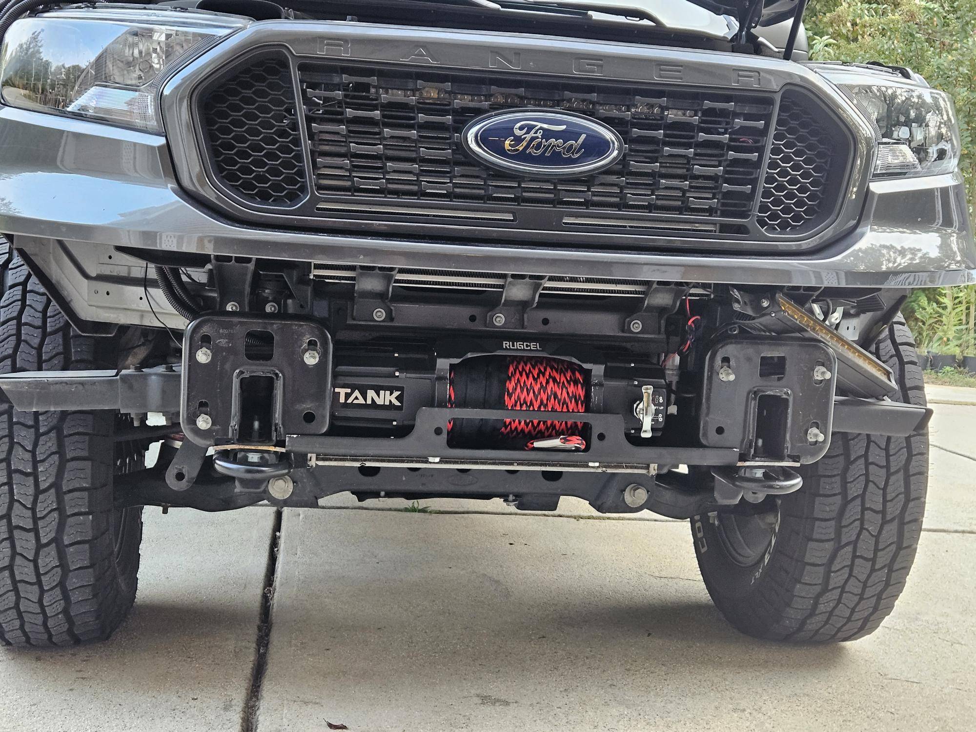

Warn VR-10S is the answer. Fits neatly between the frame rails and gives you the 1.5x safety factor. Mounting solutions are going to differ a little bit. I use an ARB bumper, but there's plenty of trays out there.
TruckNorris
TruckNorris
Brad
Apr 29, 2023
NC
21XLT FX4
Technician

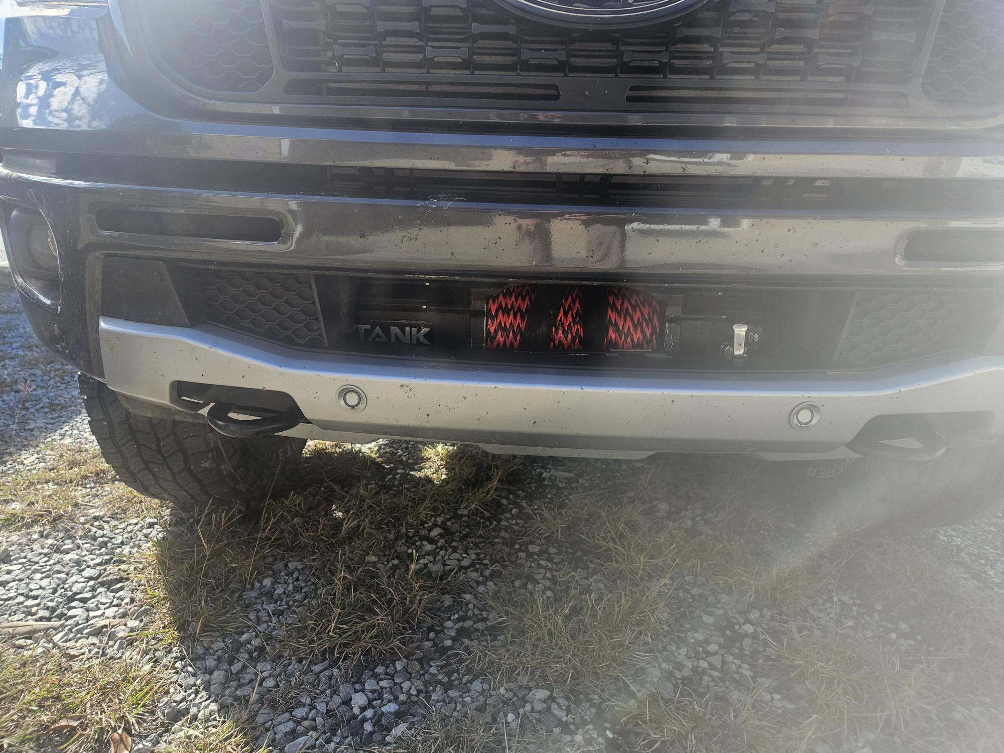

to the bars.frame that the tow hooks are mounted to. fit right in there. I had to trim a little piece from each end to get it to fit.
What did you use to trim? Did you use the existing tow hook bolts?

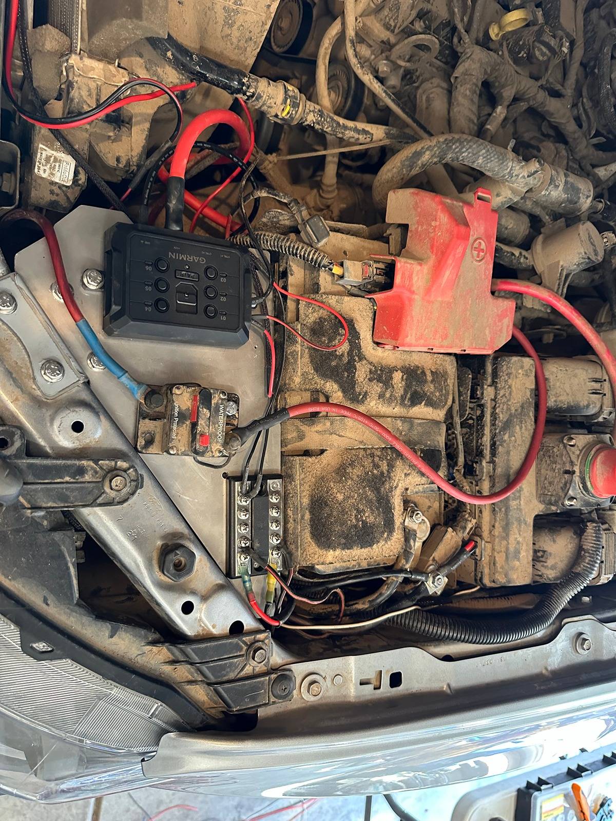

Does anyone have pics of how you wired them?
