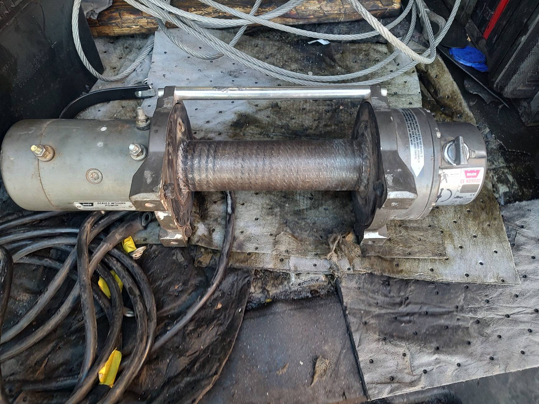

Well it is here! Picked it up on Sunday for $300(talk about a steal!!)! Still made in the USA and it normally would cost $2000 new. The Warn CE XD9000!
The steel cable is off as it was damaged and I'm going to put a Synthetic Rope on there in time as it is both much safer and lighter. I will also be switching the Solenoid pask to the Contactor Pack at a later time to!

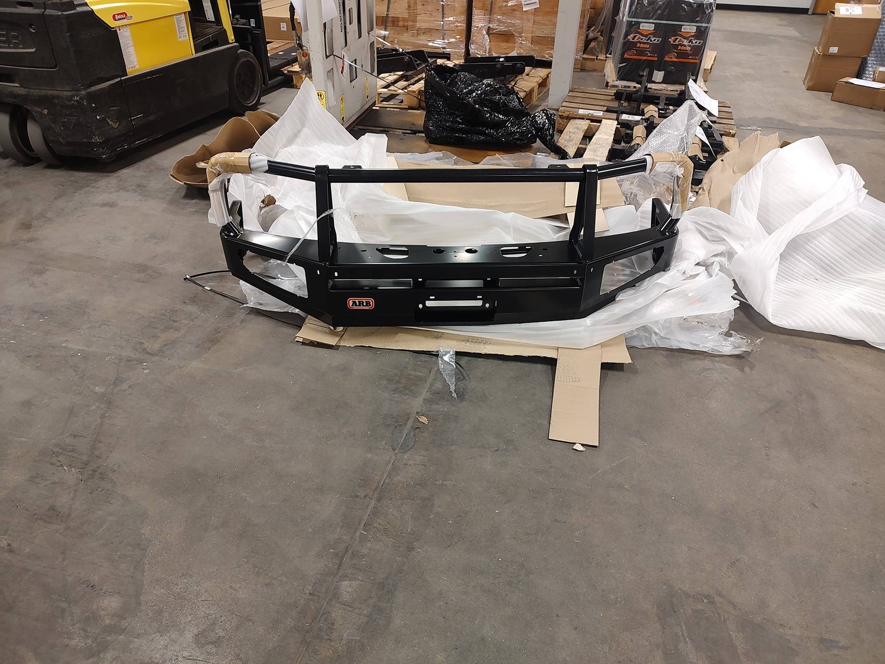

Here is the good old Winch Mount too!! A bit overkill to some, but worth it for many!

That is one hell of a bumper sir ! Your not planning to wrap it in leather are you?
NotBudule2
Robert
Jul 8, 2024
1,174
4,973
WV
21 Ranger
Not if I can avoid it!
With that bumper, I may be tempted to on offense... at least push one over while it's sleeping ? ...
